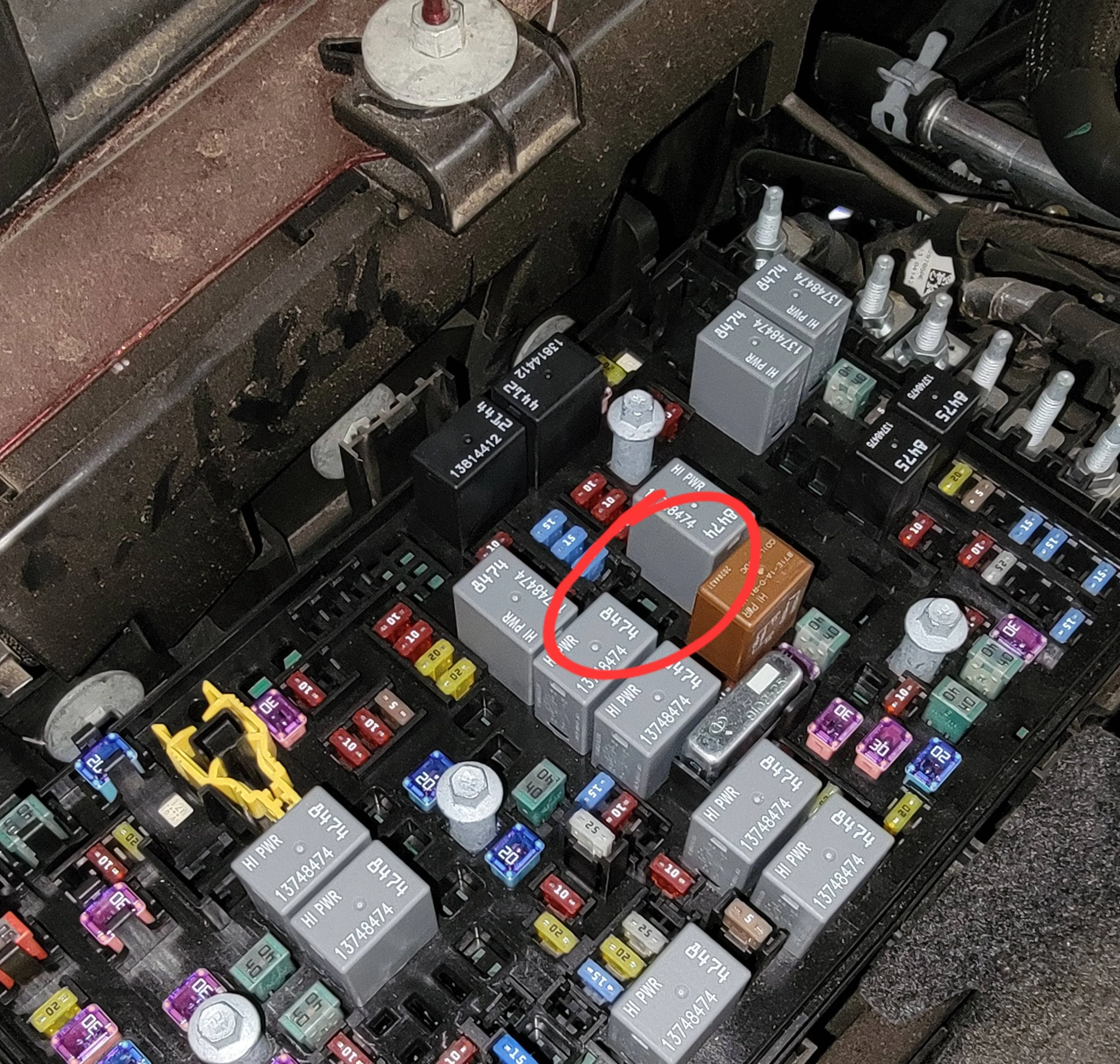

My auto start stop and aux switches have quit working so I'm assuming the aux battery is bad. I've seen posts about pulling the F42 fuse and removing the aux battery negative to isolate the aux battery and avoid killing the main battery. My problem is that I'm missing that F42 fuse and the fuse terminals. Does anyone know why this would be? Again I don't have etorque. How would I go about isolating the aux battery in this situation without removing it? It's still under warranty but I can't get it into the dealership for a while.

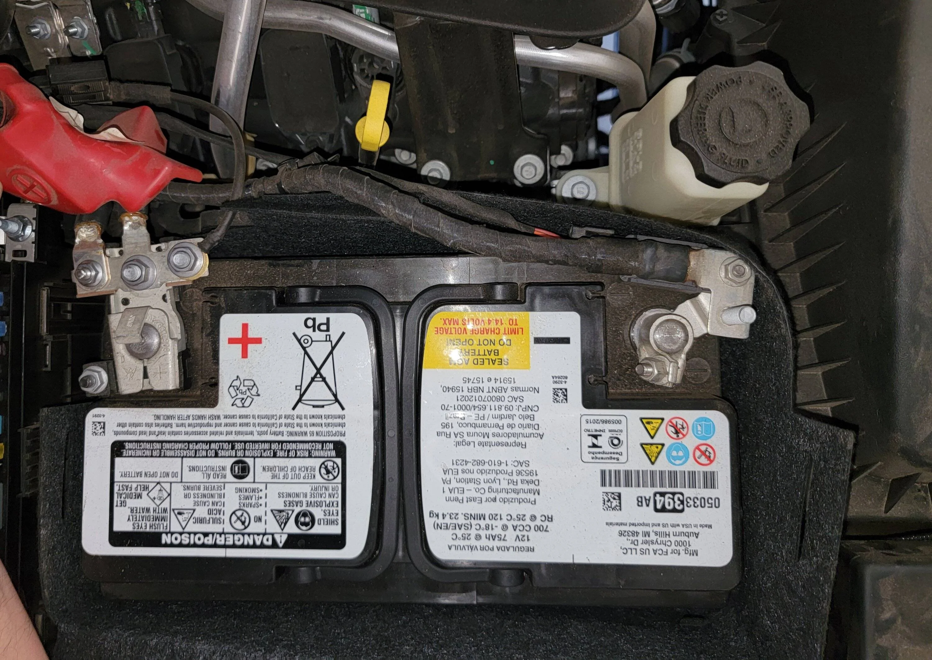

@jag
Go out to your JL and take a picture of your Main battery. Pic straight down at the battery so I can see your pos and neg terminals. Post the picture here.

Based on your picture, contrary to your belief your JL is an etorque JL.

With eTorque ........and the JL, you will see the factory has placed a solid metal jumper between N1 and N2 in the Power Distribution Center (PDC).
You will also find that there is NO, Aux battery negative cable attached to the Main batteries Neg terminal... you will just see an available stud on the Main battery neg terminal, with no cable attached to it...
And indeed, the plastic box under the PDC/ hiding behind the passenger fender flare, is there... but it does not have an Aux battery in it.. it is just an empty box.
And of course, if you crawl under... with eTorque, you will see, the 48v battery box will be these... - (with battery) just ahead of the rear axle on the drivers side.

An etorque JL does not have an Aux battery so you cannot bypass the aux battery.
