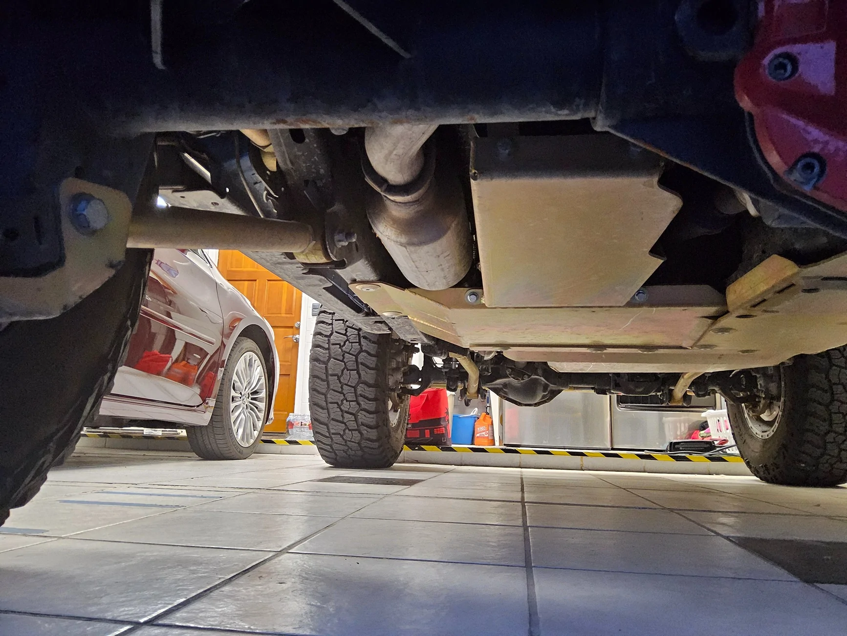

My 23 is an eTorque 3.6L with the 48V Lithium battery underneath towards the rear with cooling system lines.
I'm nearing 80. The next time I bend down and look underneath, I need to pay attention and see if I make old people sounds when I get back up. I don't recall that I do make those sounds.

Ok, my curiosity got the better of me so, for giggles, I had to see if I would make old people sounds getting up off the floor taking this picture of my Aux battery that is covered up by my Metalcloak Skid. Nope, no old people sounds from me, I was just worried more about hitting my head on something getting up.
Not one single Rice Krispie snap crackle or pop? You’re pretty spry for an old guy. JK
