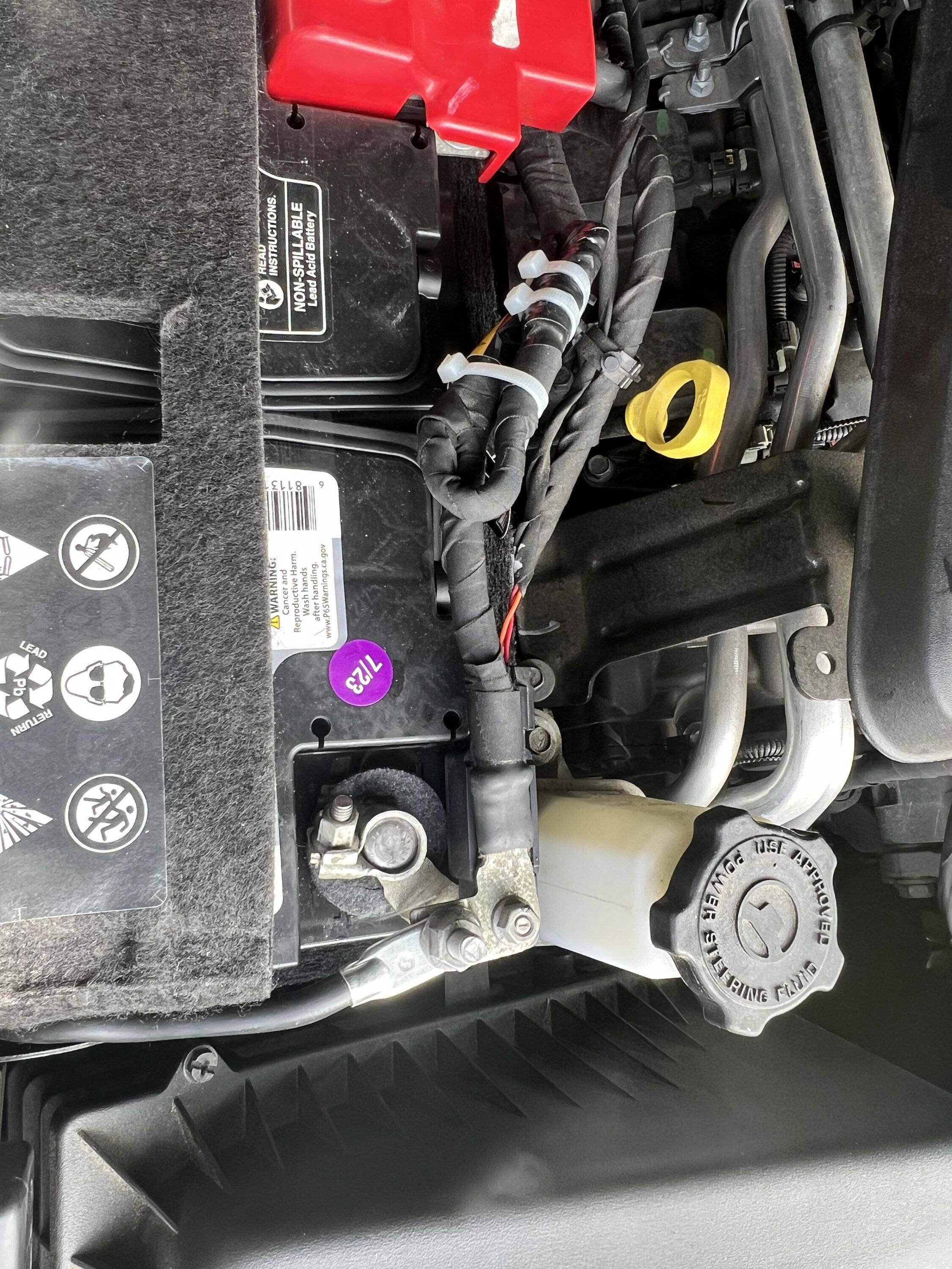

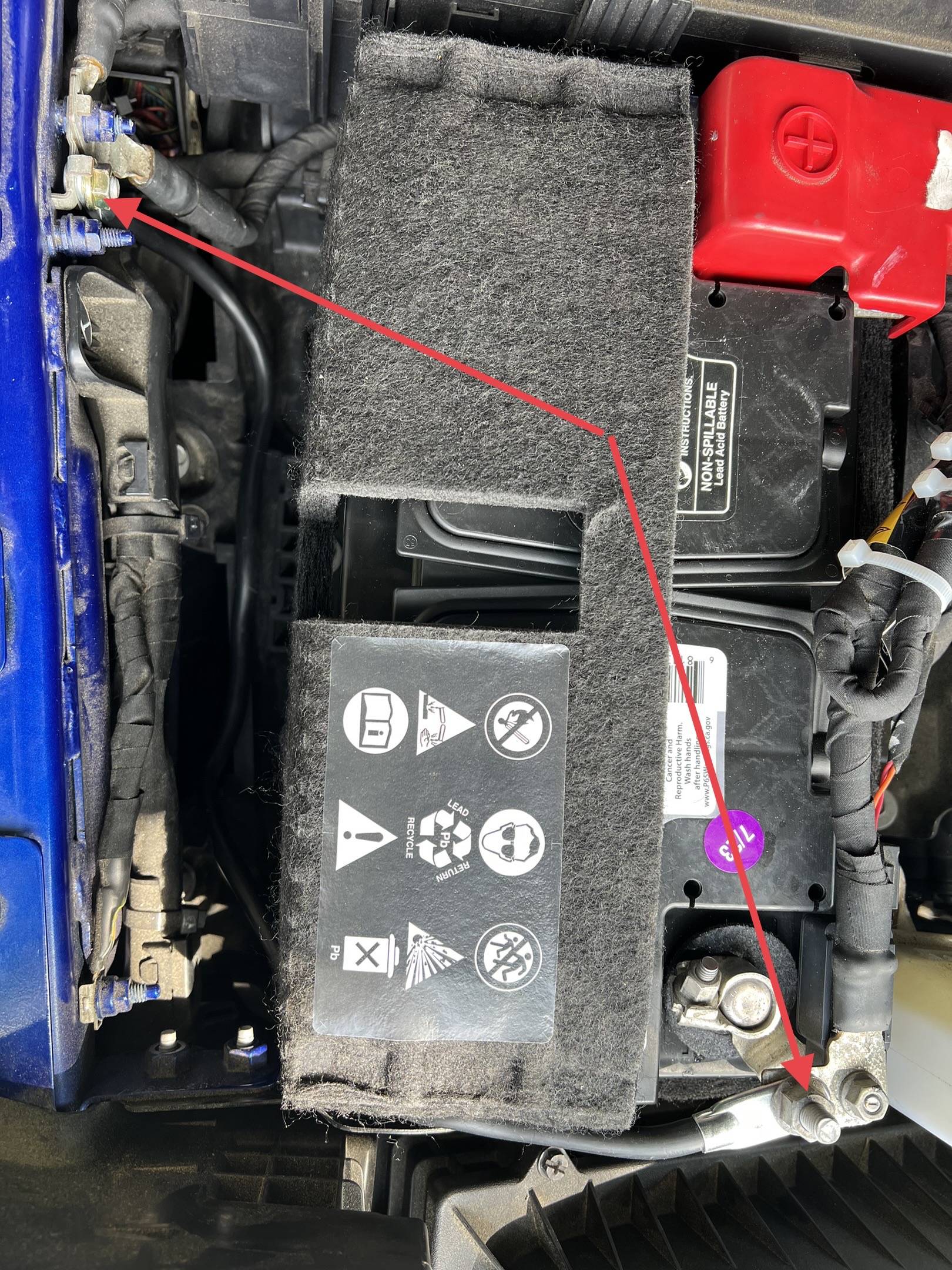

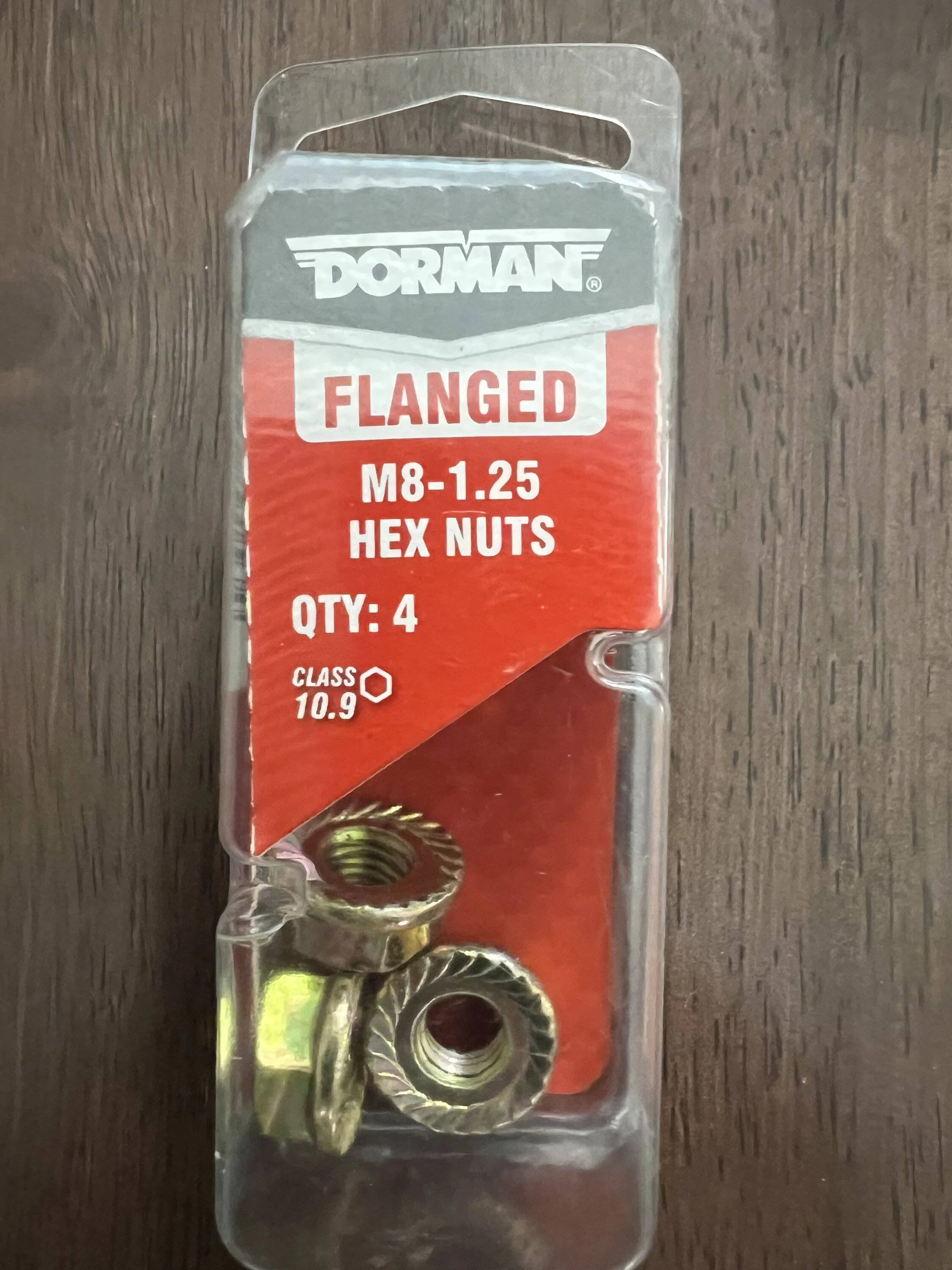

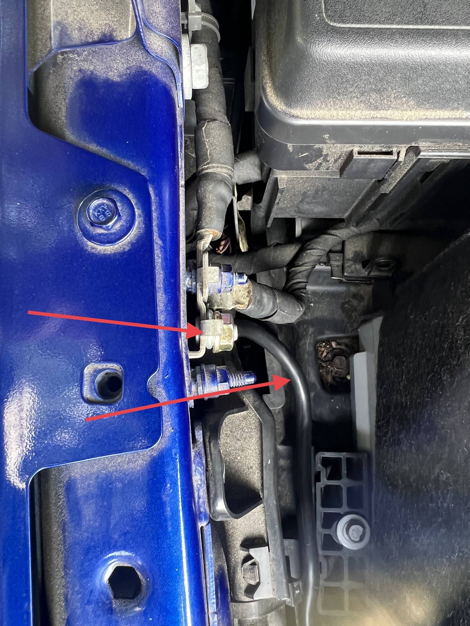

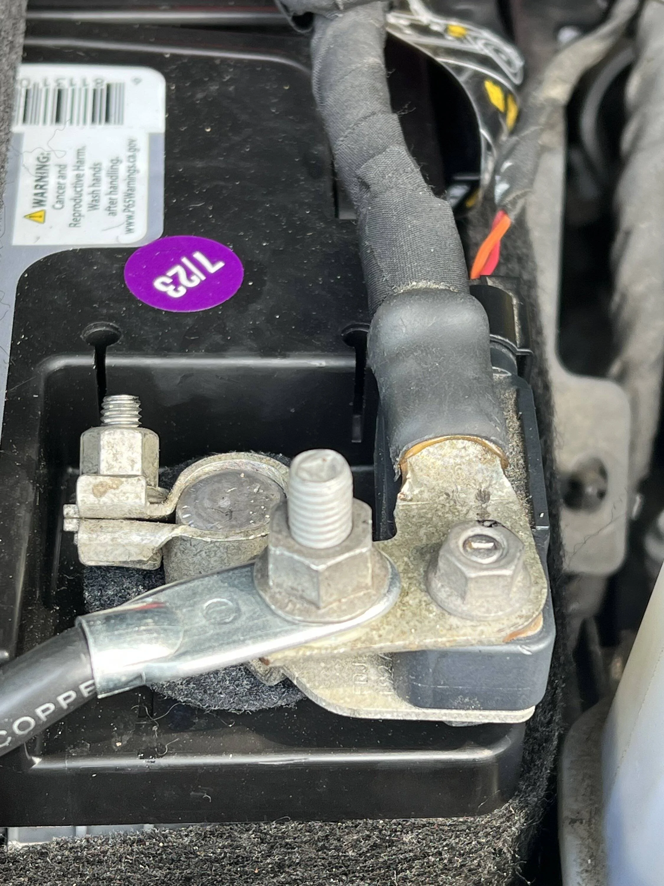

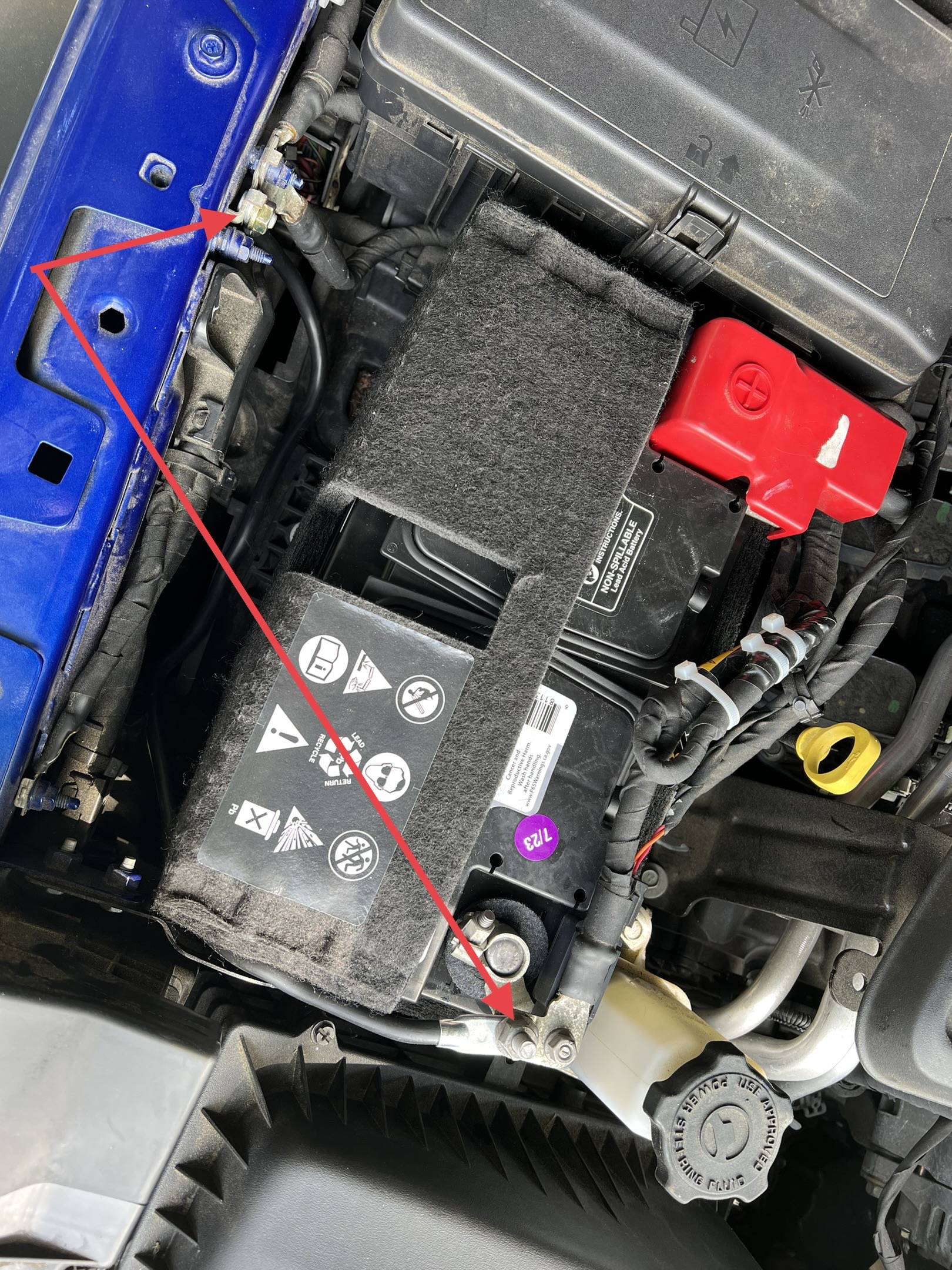

Good day friends, I have been following the forum and posts for many years. You all are full of good advice and money saving tips. This last tip about making a duel battery set up to a single battery will save me thousands of dollars over the life of the Jeep.
I wanted to thank all of you.
However, some one posted that they showed concern about putting the negative cable on a smaller post when the single mod is performed. This also sparked a concern of mine because I view it a possible current/amp reduction To the battery.
So I put on the empty battery post with the original nut and a 24 inch battery cable with stud holes on both ends. I bought the battery cable at advance auto for $13 and I had to also buy some metric nuts M8-1.25 hex nuts for $4. I did not have the metric nuts to use. I put the nut on an empty ground stud on the fender wall attached to the same grounding buss bar. Real easy to do.
If it’s not needed, that is good, if helps or not, it’s there now.
I am attaching images for you.
Again all, thanks for your advice through the years.

Sajeep, did you Pull fuse F42 in fuse panel FIRST, remove aux neg battery cable at main battery and tape the cable terminal with insulation tape? Be sure the negative (black) cable you remove at the main battery is from the aux batter below the fuse box. Two negative black battery cables end at the negative battery terminal. If you trace the negative battery cable back to the engine compartment right fender negative buss in my picture, THIS CABLE IS CONNECTED TO THE STUD THAT HAS THE PCR ON IT.
To simpify basically all you are doing is:
1. pulling fuse F42 in fuse box
2. removing aux battery cable terminal from main battery neg post that is connected to PCR
3. removing other negative battery neg terminal and reconnected it to PCR neg battery post
I read in one of the previous posts something about a mod on the earlier jeeps had something to do with being able to do this. Since I had a 2020, I did not read it throughly because it did not pertain to mine.
What I posted pertained to adding an addition negative cable because someone posted (and I agreed with) the negative cable being removed was larger than the smaller one remaining on it. So I was concerned with current carrying issues. But many people posted they had no problem.
If nothing else works, I would pull both negative and positive battery terminals and try to clear a possible fault. Just my opinion. Of course you would need to reset you clock, radio and other things.
I truly believe it is worth the time, effort and money to find out why it’s throwing a light. It will save you a lot of money and frustration in the future. I did exactly what the poster said to do and it worked for me.
Maybe some of the guys may have some additional advice for you. Good luck, please keep us posted.?
