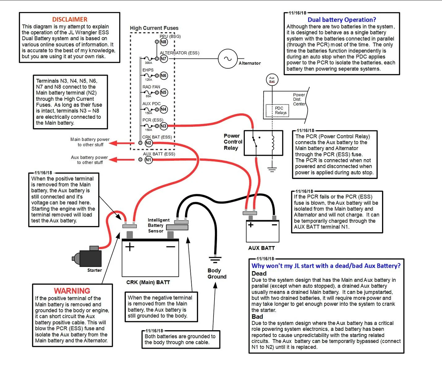

Hello. I'm trying to unplug my aux battery. I removed the F42 fuse. But unless I keep the 2 negative wires connected to the main battery, my Jeep won't turn on. Any idea? I don't understand, based on all my readings, this shouldn't happen.
You only disconnect the one that goes to the AUX battery. If you remove one and the Jeep doesn't start, try reconnecting that one and disconnect the other one.
Yeah, I tried both. And the Jeep doesn't turn on (dash is completely dead) unless I connect both. That's the part I don't understand... I just bought a new main battery and I want to make sure the aux battery isn't going to drain it, but I'm very confused... how it's possible that I need to have both wires connected to have power. It makes no sense based on the wiring schemas. ?
Just thinking out loud here:
Does the rectangular sensor (on which the screwdriver tip is resting) maintain a connection to the negative post when you attempt to remove/isolate the cable specific to the small ESS battery?
Things need to be done in a certain order. I think the problem was indeed the sensor. When you do things "out of order" the sensor cuts the connection. I think... Now it's working as expected. I'm not sure what I did wrong the 1st time.
