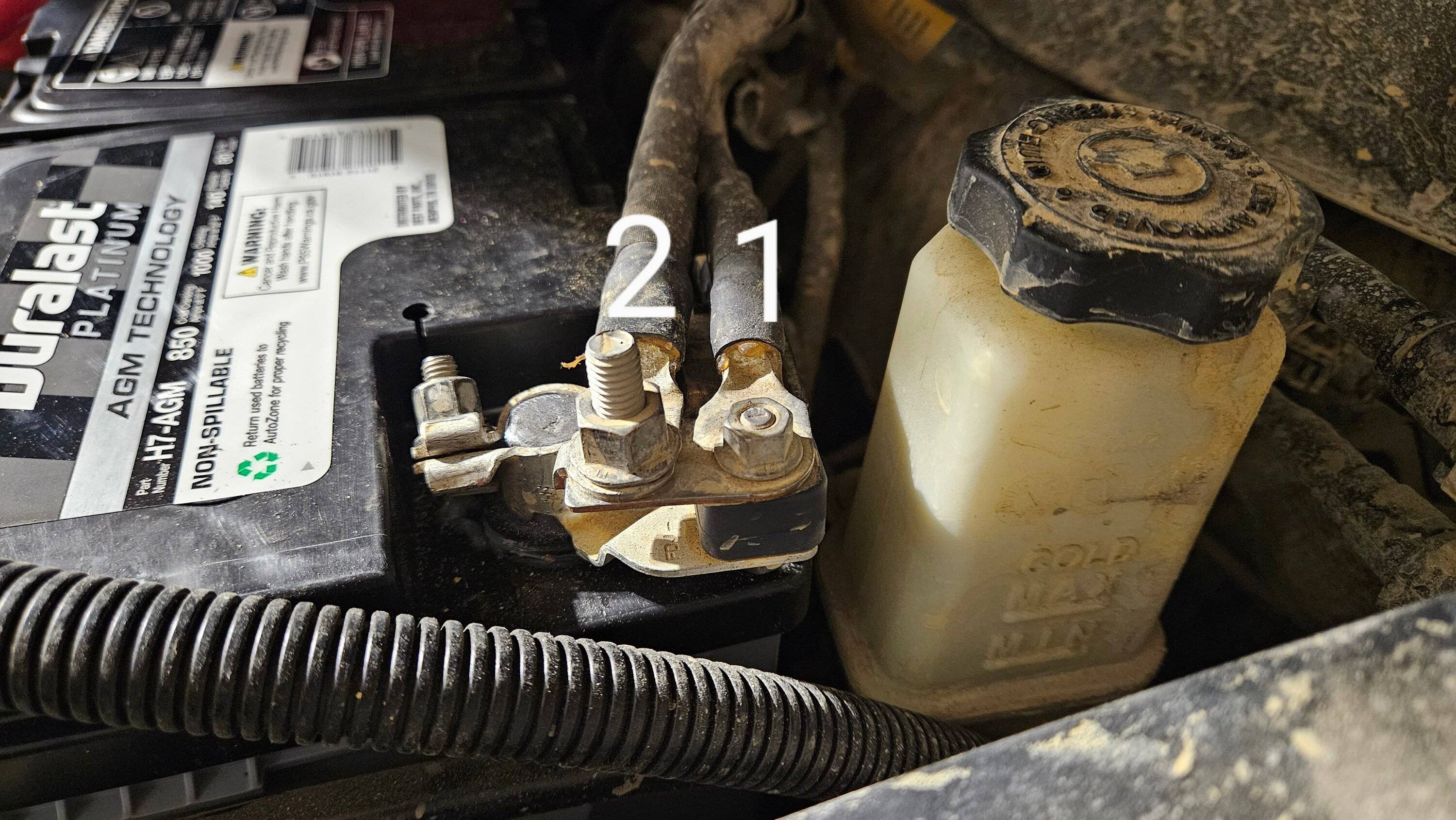

Reading all these threads is doing my head in, though. Here's my factory setup:
Jeep Wrangler JL Jumperless Aux Battery Bypass 20231015_214720~2
Jeep Wrangler JL Jumperless Aux Battery Bypass 20231015_214705~2
As you can see:
  • Cable #1 is the thinner of the two. Cable #2 is the bigger.
  • Cable #1 terminates with a bracket, which Cable #2 is currently attached to.
  • Cable #1 is attached to the PCR (the little black box with the wiring harness plug) via a stud that presumably comes off/through the PCR.
So, if I'm reading everything correctly, I need to (in this order)
  1. Pull Fuse 42
  2. Remove Cable #2 from the bracket. Wrap it in a shop towel to temporarily isolate it
  3. Remove Cable #1 from the PCR and wrap it in electrical tape or heatshrink to more permanently isolate it and zip tie it back out of the way.
  4. Attach Cable #2 to the stud on the PCR
  5. Profit?
With this setup, I have the following considerations:
  1. There is still a rotting aux battery in my Jeep. At some point I'll want/need to remove this for my peace of mind. However, with the steps outlined above, the aux battery is completely isolated from the system and is not serving any purpose.
    1. It's not likely to be leaking fluid or anything (Jeep is a 2021 w/ 42K miles) but I still don't like the idea of an unused battery in there.
  2. I can continue to drive around with no issues, but I should manually disable ESS whenever I drive. If I miss it once or twice, it's not the end of the world.
    1. If I buy a SmartStartStop, then I won't have to remember to push the button.
Am I missing anything? Did I get it all right?

Can you confirm Cable #2 from my photo (which is the BIGGER cable in my setup)?
I thought I was needing to remove the SMALLER cable from the connection (Cable #1 in the photos above)?
You need to remove and isolate cable #1. It should be the thinner of the 2 cables.
Pull fuse #42 first.
You should not have to remove cable #2 from the battery terminal.
Yes. Bypassing the aux battery does not disable ESS. If you don't push the button to disable, it will run off the main battery.
Correct. You can also use a Tazer.
@rcadden
Aux battery negative cable, regardless of the model year JL will be the slightly smaller in diameter cable you find attached to the Main's negative terminal.
Remove Fuse F42 in the PDC first and then disconnect the Aux neg. cable.
There is no need to disconnect both cables at the Main's negative when you do the jumperless Aux battery bypass. (I have done this jumperless Aux battery bypass on quite a few JL's and JT's and never disconnected both cables..
Except that in my photos, Cable #1 (smaller) terminates in a large connector to which Cable #2 is attached.
So I DO have to remove both - I need to remove Cable #1 (which will also remove Cable #2, since they are attached to each other), then detach Cable #2 from Cable #1, reattach Cable #2 to the battery and tape off Cable #1, right?
YES. Right.
IDK why that seems to change from year to year. My 2020 was simply a matter of removing the skinnier of the 2 negative cables.
