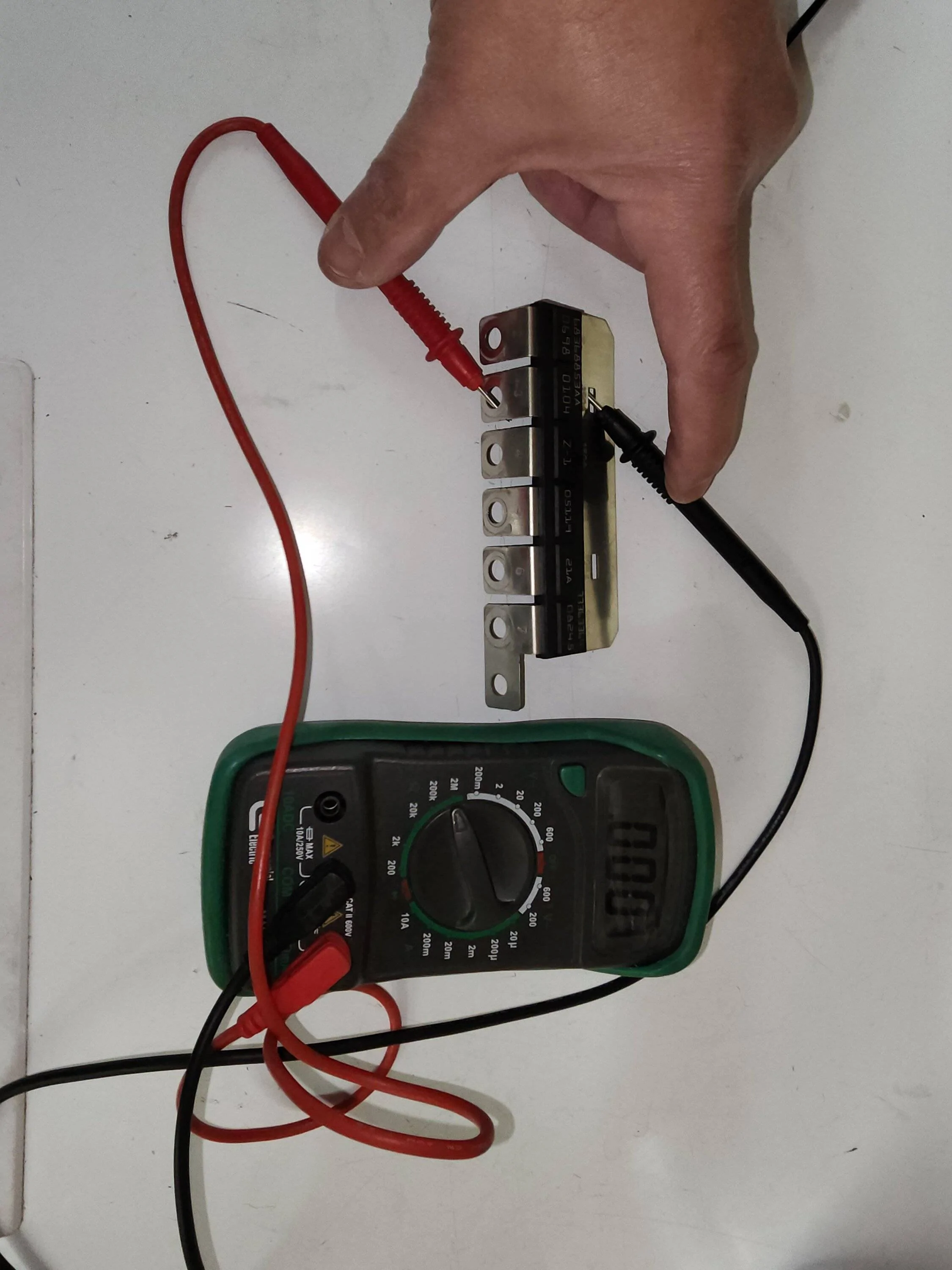

So the plot thickens...
Changed my high amp fuse array today and N3 was not blown--though strangely enough and despite having the towing package +auxiliary switches, I had the 60amp version.
I have a Gladiator fan (850 watt) to install so I'm glad I grabbed the 100 amp version.
With that said, I believe I have a false positive for ESS and battery issues and instead think I have an O2 sensor issue given the codes that are being thrown and service ESS is just a consequence.
Was going to change the O2 sensor until I saw where it was, so I guess I'll get to flex that MaxCare warranty in the near future.
N3:
