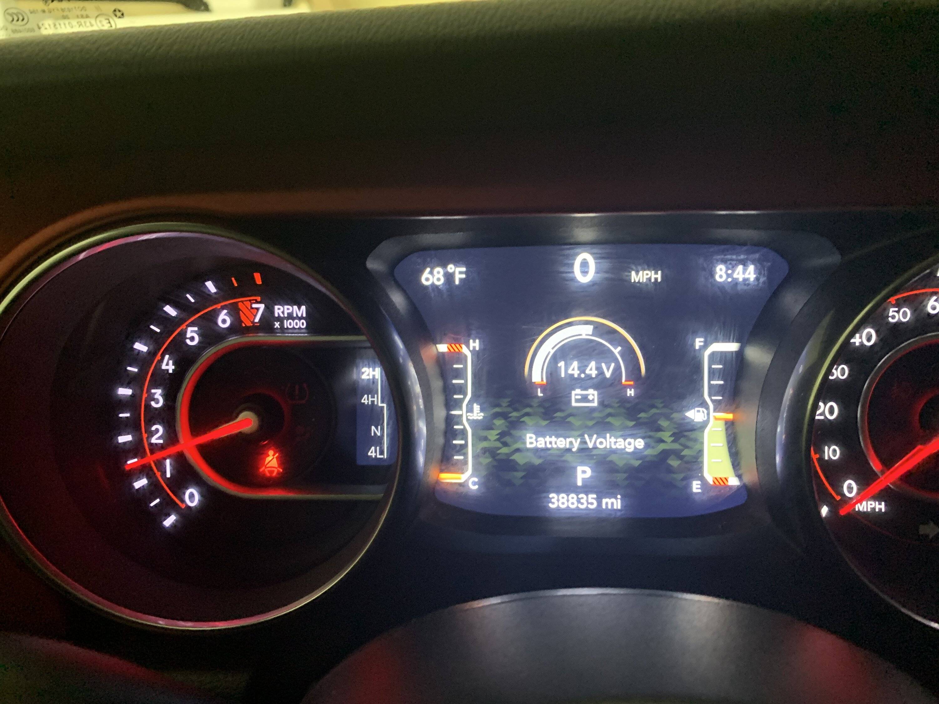

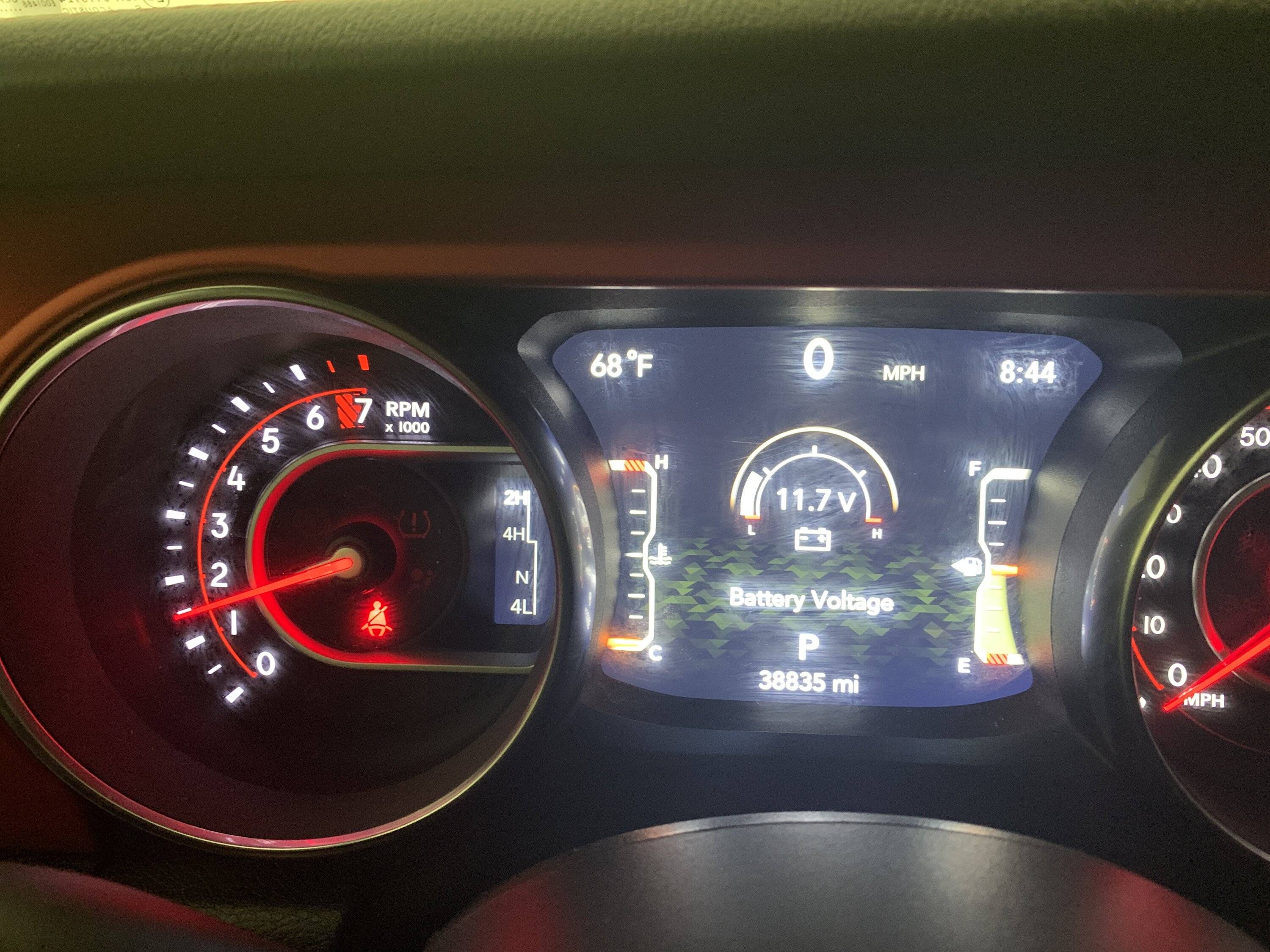

Here is an example of voltage readings from the dash display. My Jeep is a 2020. My stop/start quit working last November. After 3 trips to the dealer, the main battery was replaced. The dealer used an Interstate battery that is 790CCA (when I replace this battery, I plan to use the Everstart H7 battery from Walmart - 850CCA). My Jeep has the aux battery disconnected.
Frist AM, ignition on run, engine off
Voltage immediately after cranking the engine.
Voltage 15 seconds after cranking the engine (charging voltage)
I was surprised how low the battery measured after sitting overnight. Of course, 12.1v is not the true voltage number. It's the voltage pulled down by the load of the Jeep's systems. I would need to disconnect the battery and measure with a meter to get the "true" rating. I was pleased that the voltage barely fell off after cranking. For me, this is the surest sign of a good battery. My charging voltage when I had both batteries connected was always 14.7v. When I disconnected the aux battery, the initial charging voltage dropped to 14.4v. If I drive for an hour, the charging voltage gradually goes down to 13.9v. I deem this normal behavior.
@andy29847
Unfortunately, I believe you deem wrong...
Read over you post.... Your Main battery, based on what you posted is not in terrific condition..
(Or you drive very little and the alternator is not being given enough time to maintain the 12v)
12.1 is not typical in the am for a healthy Main that has sat all night. (12.6, 12.7 is typical)
11.7 after start..... not typical..
When driving you should see, gradual dips to say 13.2, 13.4 or a bit lower... then goes up and down... (up to say 14.1 or so.)
You might want to move to that H7, sooner rather then later.
