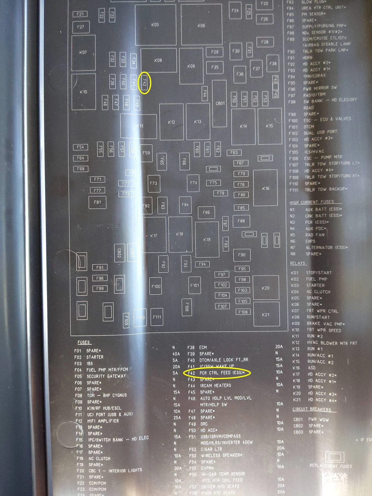

Yes, pull fuse F42 and disconnect the aux cable from the main negative terminal. It should be the skinnier of the 2 cables connected to the terminal.

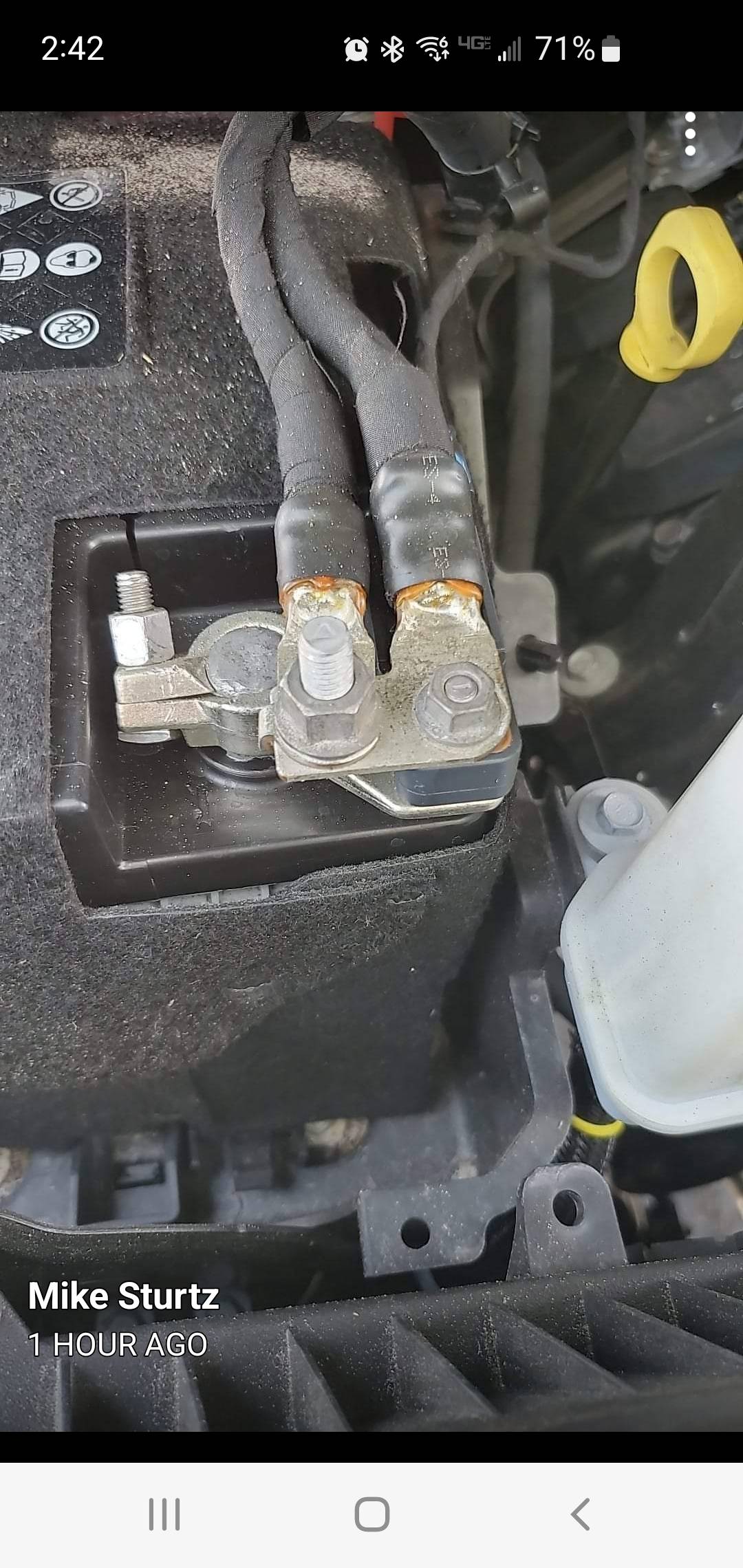

Which cable is for the aux. Battery?

Viewing on smartphone ... hard for me to see diameters. What year is your JL?
2019.
I unhooked the left one and here's what it did
2 tries with start button then started
Power steering light came on
Traction controll light on
And 1 other light maybe for suspension?
Auto start light on still??

On your 2019, the smaller diameter, Aux negative cable is the cable closest to you on the Main's negative terminal when you lean over and reach in over the passenger side fender.
Did you pull Fuse F42 ?

Yes
I'm going to try it again. I'll let you know what happens. Thanks for the help!
