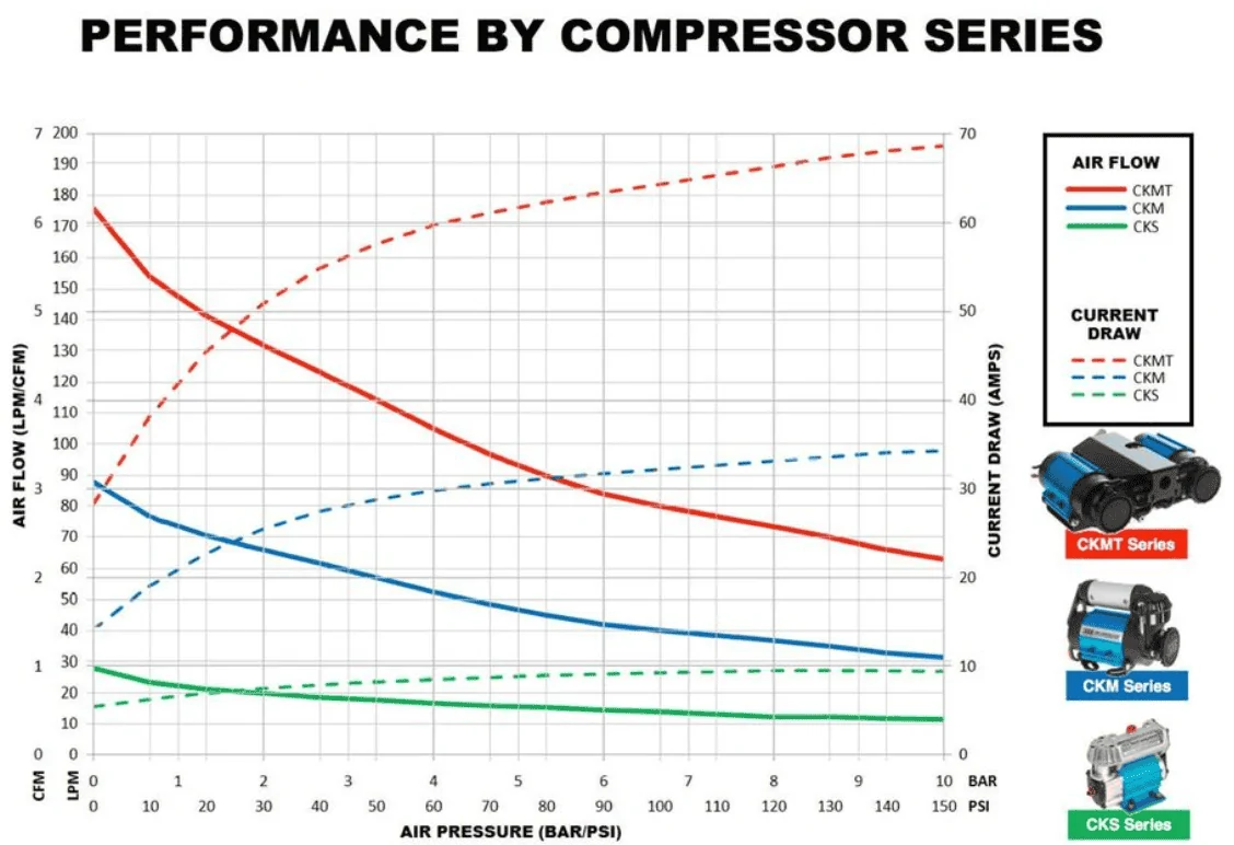

So after some testing and coding I've got something that works pretty good. It's not as accurate as my original version that used a sensor reading to .1 psi but it's pretty close and a much simpler system (hardware-wise).
Unfortunately the frequency and timeliness of the TPMS updates is not great. It does seem to update every couple of psi or so, but I don't think the timing of detecting the change is very precise. It can also act like busses during rush hour - no updates for a bit then 2 updates just seconds apart. If I try and build a prediction curve from the values it does not perform well. I think with some better change point detection and filtering work it could be feasible but I've got another way from my existing project that works well so I'm using that.
If you look at the ARB performance graphs:
Jeep Wrangler JL JEEP HACKING CAN-C / CAN-IHS / UDS ! (Reverse Engineering) 1716899706905-lx
you can see the psi vs. cfm performance (solid lines). For the psi ranges I care about (0-60) it's close enough to a linear response I can make a simple prediction using the slope of the line:
Jeep Wrangler JL JEEP HACKING CAN-C / CAN-IHS / UDS ! (Reverse Engineering) 1716899887931-b0
(I also tried a polynomial regression but it's just not worth it)
Since I know the volume of my tires I just take the current psi and my setpoint psi and calculate how many cubic feet of air are needed to reach the setpoint, then use the average CFM over the interval to calculate how long it should take.
