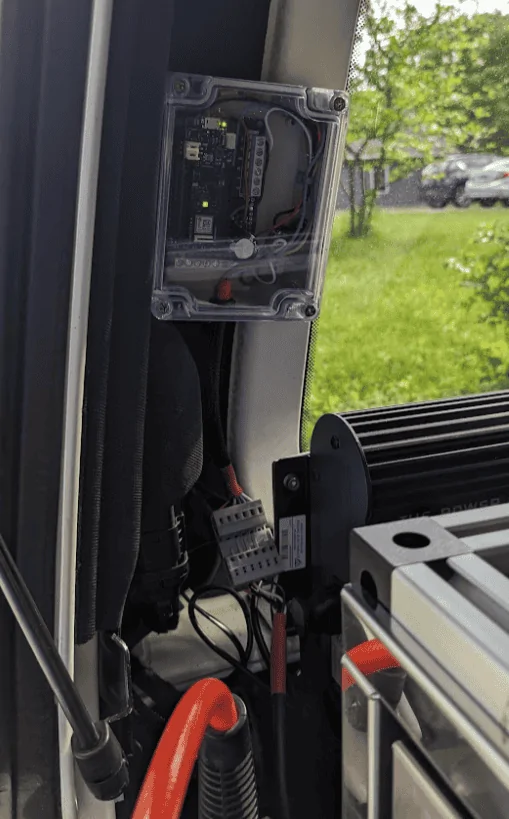

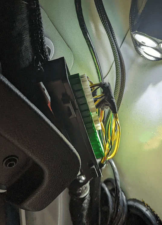

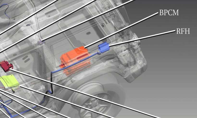

I've got a good compromise, this is the location of the 'other' c bus star connector:
Jeep Wrangler JL JEEP HACKING CAN-C / CAN-IHS / UDS ! (Reverse Engineering) 1715388471644-im
It's behind the door jamb / in front of the rear passenger side wheel well (there's a similar IHS bus version on the drivers side) - just pull back the carpeting to find it.
Jeep Wrangler JL JEEP HACKING CAN-C / CAN-IHS / UDS ! (Reverse Engineering) 1715388734047-rn
Will cut the length of my cable run in half or better

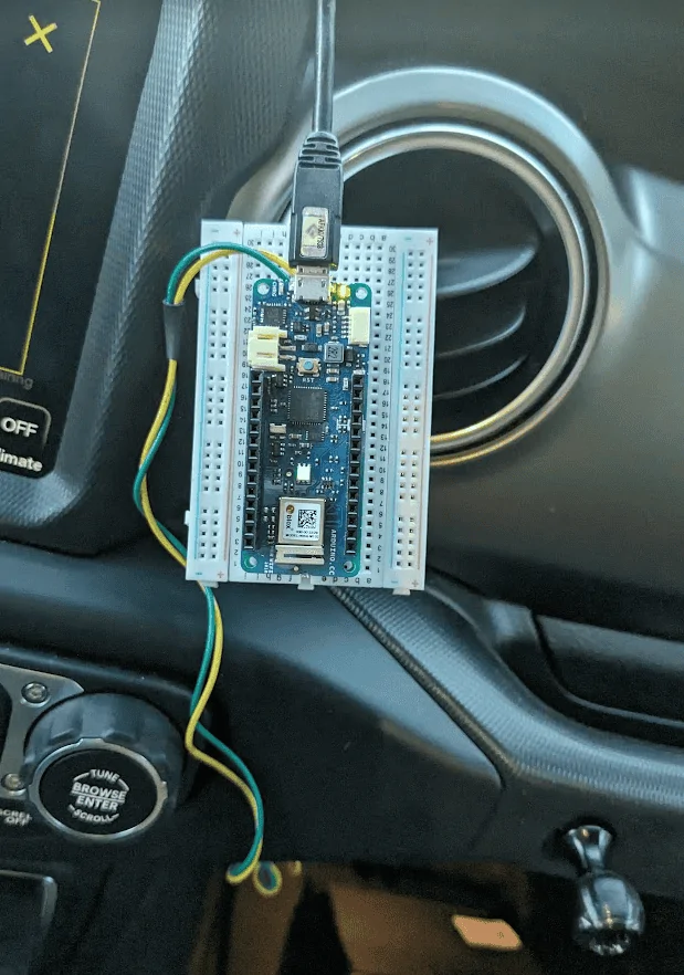

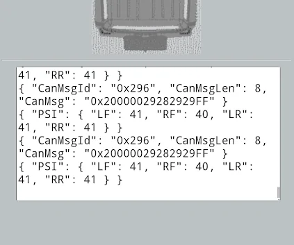

Got a successful tap into the can C bus - not sure why using the DLC did not work. I do have the auto startstop eliminator in place but would not think that would affect it.
Anyway, getting good traffic of TPMS messages seen on the bus, every second or two. Don't yet know how often the data is actually updated from the tire sensors but that's next.
This is the MKR 1010 with CAN shield (stacked) - I'll be adding a relay and also an optoisolator used to know when the compressor is actually running (so I can keep an accurate accumulation of run time, need to account for when the pressure sensor on the ARB decides to turn itself off)

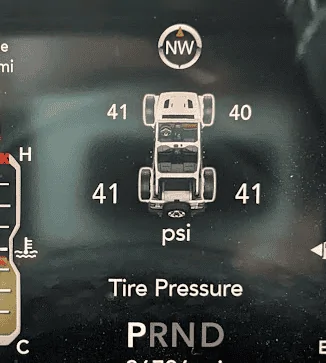

Dash:
Data from can bus sent to web page:
Curious what it will say when I switch to socialism units instead of individual liberty/free market units (while we're still able, don't get me started...)
I'd prefer to mount the controller in the back closer the compressor and fittings but that means running a longer can cable. Even using proper twisted pair and shielding it may be a weak link.
Has anyone tapped into the can bus wires of an existing module? Like the RFH module is very convenient for my project but not sure how I feel about splicing into the factory harness.
It's in PSI? That's unreal.
Note that your pressures are really, really high.
I missed that when your post @LanceMagnum, but if you drop your psi to ~30 (or maybe even less, depends on your tire/wheel setup) you will feel quite the difference. Your ride must be like a bouncy castle now! ?
sorry to add one more thing to go experiment on haha

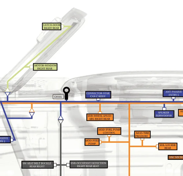

Today I believe I have a better high-level understanding of the Secure Gateway Module, it's purpose, and it's relationship with the OBD-II port (what Jeep calls the DLC, or Data Link Link Connector) as well as it's relationship with the uConnect radio.
At the bottom of this message, I've included a diagram of the DLC connector (including pinouts) as well as both connectors to the Secure Gateway module. But the what I really want to reference is one of the Wrangler's wiring diagrams.
Below I have pasted a portion of the CAN-C bus wiring diagram. (For our purposes, we can assume that the CAN-IHS bus is wired in a similar manner, so I've not included it.)

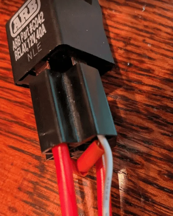

So my project is basically down to software development at this point. I've got my Arduino with CAN transceiver tapped into the C bus and also a control relay that is in series with the pressure cutoff switch on the ARB.
Jeep Wrangler JL JEEP HACKING CAN-C / CAN-IHS / UDS ! (Reverse Engineering) 1716584930415-6h
Since the ARB itself, as well as the relay on the ARB circuit, cause voltage dropouts and noise some significant protection circuitry is needed. I have a big cap and diode to keep the μC power stable for when the ARB kicks on, and I also added a flyback protection diode to the ARB relay:
Jeep Wrangler JL JEEP HACKING CAN-C / CAN-IHS / UDS ! (Reverse Engineering) 1716585191717-c
(the diode is hiding under those 2 pieces of heat shrink)
My previous project was battery powered because I did not put the design effort into cleaning up the noise but with the latest steps it's been very stable and it's convenient having it powered from the same aux circuit that powers the ARB.
I did some test deflation/inflation and the psi updates from the sensors are better than expected, maybe every minute or so. Hopefully this means I can program an accurate prediction curve to know when to pause the compressor as it hits setpoint (and I think a v1 can skip the prediction stuff but still be 'close enough' to be useful)
