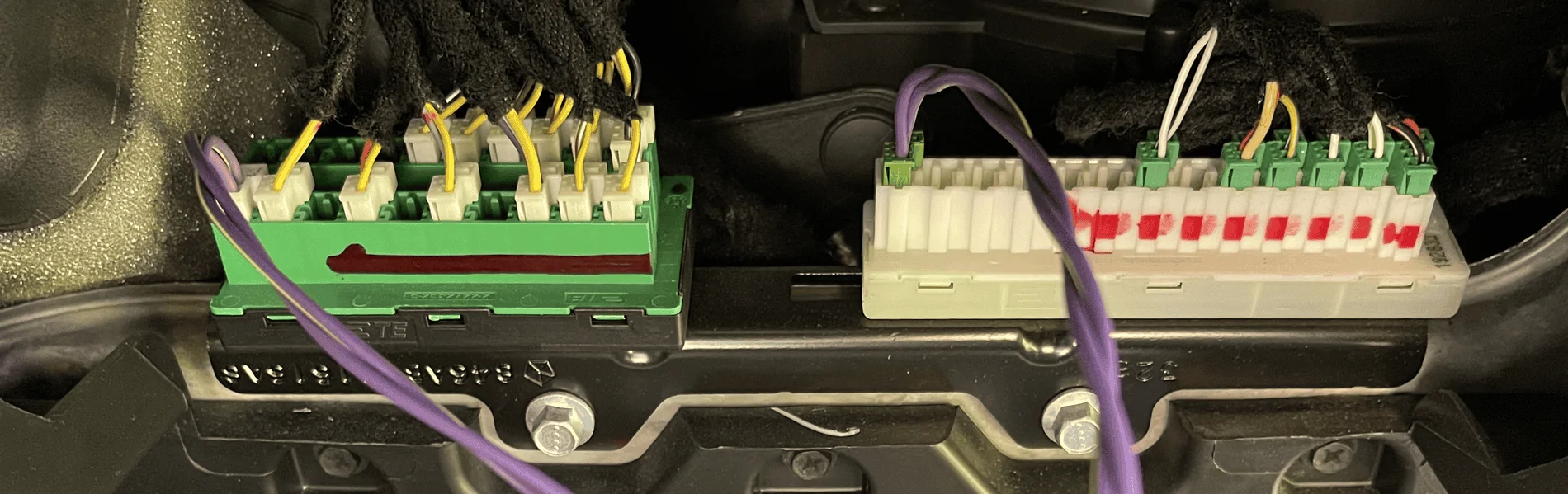

I'm trying to replace a canvas connectors on my 2018 JL Rubicon and can't find part numbers that match. Everything on the internet has an eight-digit number plus AA at the end My CAN bus has a six-digit number stamped on the end I was actually looking to replace both the white single row one and the double row green but I can't find part numbers that match
Jeep Wrangler JL Can buss PXL_20240328_024018092
Jeep Wrangler JL Can buss PXL_20240328_024046053

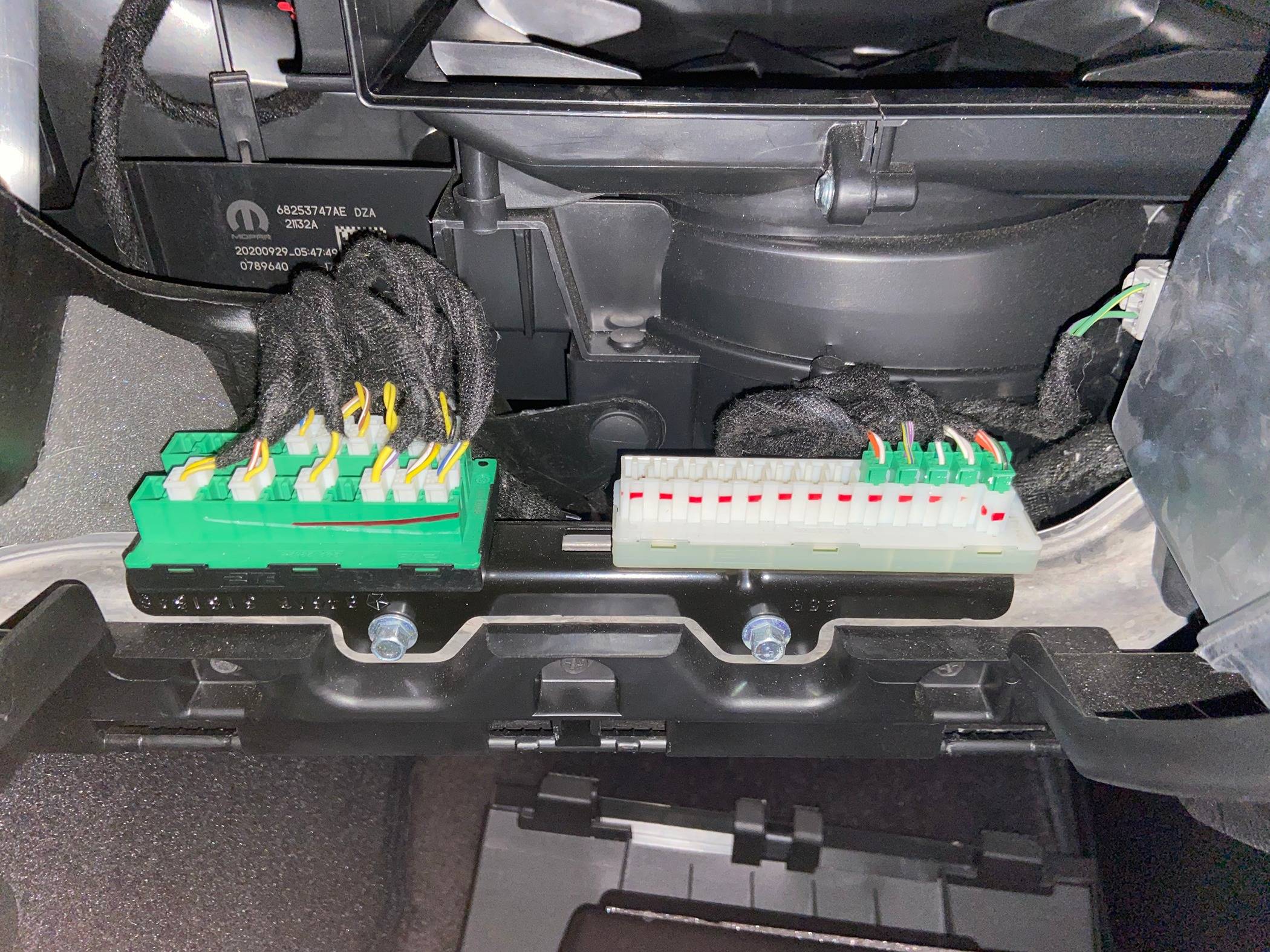

In the picture below are two of the same, located behind the glove box:
Jeep Wrangler JL Can buss canbus
Hope this gets you closer to your answer when someone else chimes in with a bit of help!

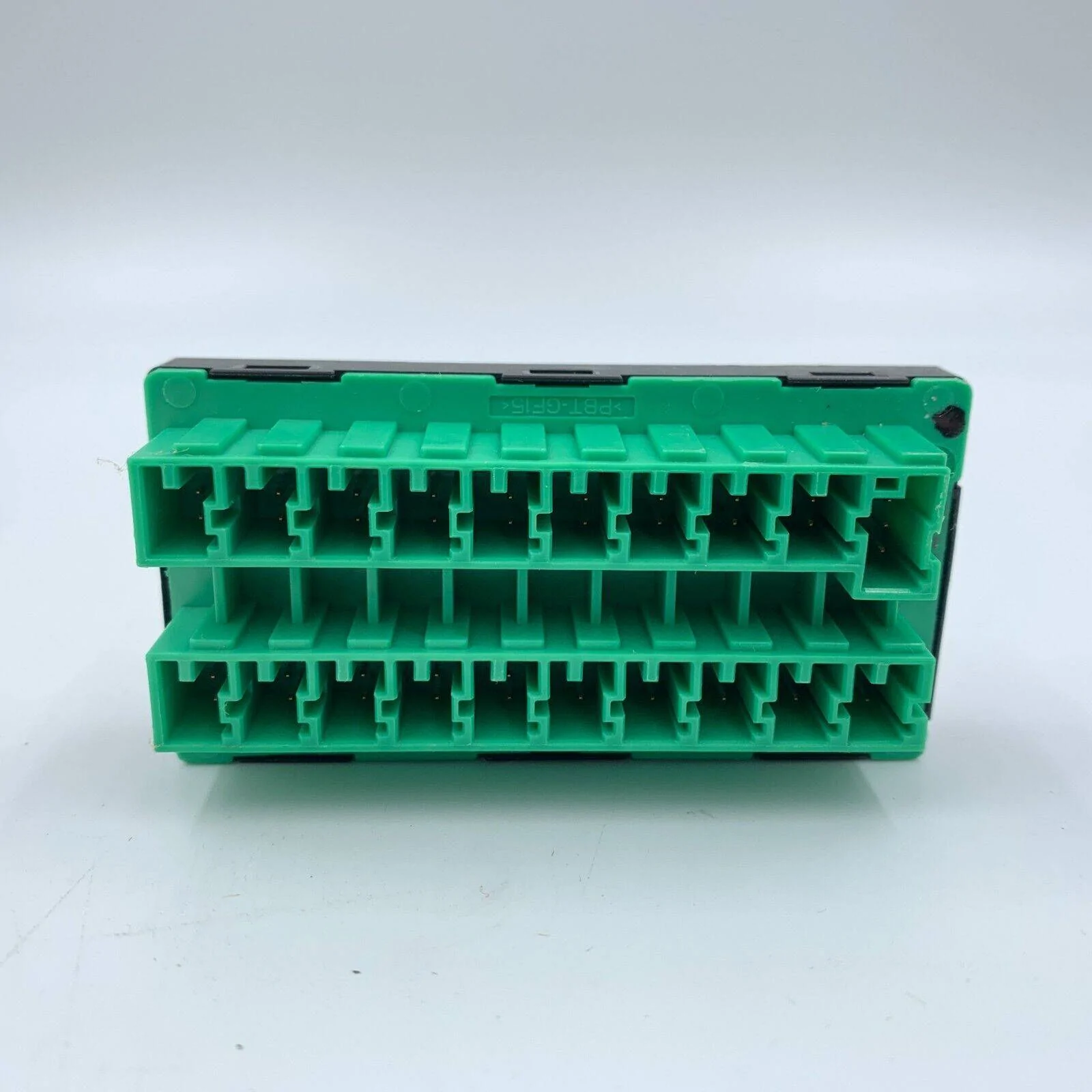

Yes that would make sense. But how am I supposed to find a part number. I searched the internet and I keep finding a green can buss, The first connector is shaped slightly different than the white can buss that I need

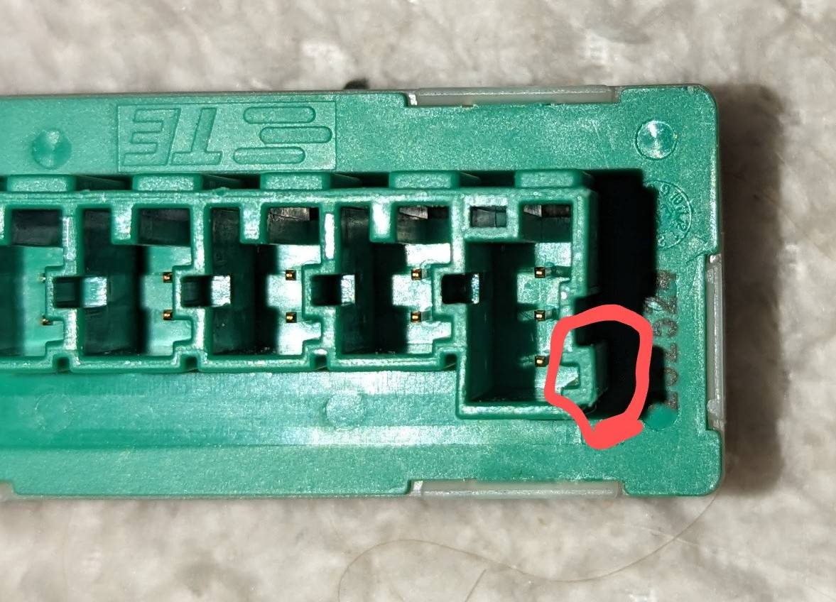

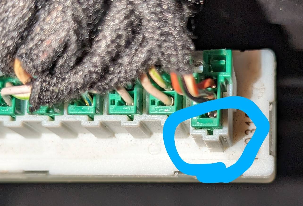

Hey thanks for help. But that's not the one I need. I ordered one off the internet that looks just like that. I'm going to post a couple of pictures and show you why mine is so messed up and I'm having so much trouble. The green can bus is the one I ordered off the internet you can see in the circle that there's a notch on the right hand side. The white one is mine and you can see in the circle that there's a notch on the bottom.
Jeep Wrangler JL Can buss PXL_20240328_045731338~2-1
Jeep Wrangler JL Can buss markup_PXL_20240328_024018092-1
