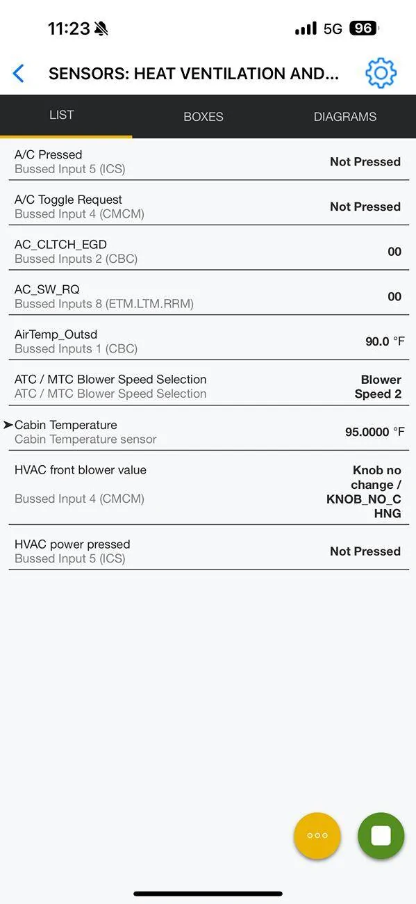

Wow what a great thread and kudos to everyone that contributed so much to this. I've spent a couple of hours this afternoon reading through this looking for a way to activate the A/C switch on the HVAC controls via CAN BUS.
I read through the excellent write-up on the SGW and ordered the bypass cable on Amazon.
Looking through the spreadsheet posted at the beginning of the thread, it looks like I'm after:
2D3: $0700000000000100 A/C system on/off
2D3: $0700000000000200 Air recirculation on/off
From the comments, setting 0200 ON will set A/C on automatically via the PCM.
What I'm trying to diagnose: the A/C is not working and by A/C, I mean it's not commanding the A/C compressor on when I engage the A/C switch on the Linkswell. The Linkswell shows the A/C switch illuminated, indicating it's engaged (see attached pic). However JScan shows the A/C button is not pressed.
The outside air temp and cabin temps seem spot on.
Jeep Wrangler JL JEEP HACKING CAN-C / CAN-IHS / UDS ! (Reverse Engineering) IMG_0669
The blower motor works fine and the motor speed on the JScan 1-7 matches what is set on the Linkswell Gen 4 radio.
It's 92 degrees here and I have the auto climate set at 65F. The cabin temperature sensor is reporting correctly on Jscan.

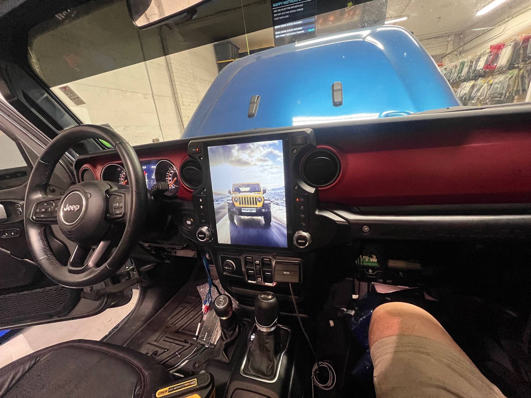

The Linkswell replaces the factory HVAC controls and I believe it commands the A/C on via CAN-BUS. I went through the Linkswell A/C Wrangler JL setup procedure again and it didn't resolve it.
Screenshot of JScan attached and Linkswell attached for reference.
My guess is it's something with the Linkswell but unfortunately I left the OEM HVAC handy to swap in and see if it resolves the issue.
It was working fine until I performed the AUX battery delete. I completely removed the AUX battery and ran the two positive feeds that were connected to the AUX battery the main battery. Everything else is working fine and no codes.

Update on my A/C hacking: I was able to force the A/C on via CAN 2D3: $0700000000000200 Air recirculation on/off. The issue was the Linkswell.
I did a Linkswell software update, reset it to factory settings, went through the Jeep JL specific HVAC setup again and now the A/C is working as it should. However the "A/C Pressed" doesn't show as activated in JScan, but the clutch is engaged, shows clutch duty cycle and the A/C is working like it should. The A/C pressed button might be reserved for the OEM A/C controls rather than how the Linkswell commands it on via CAN bus.
