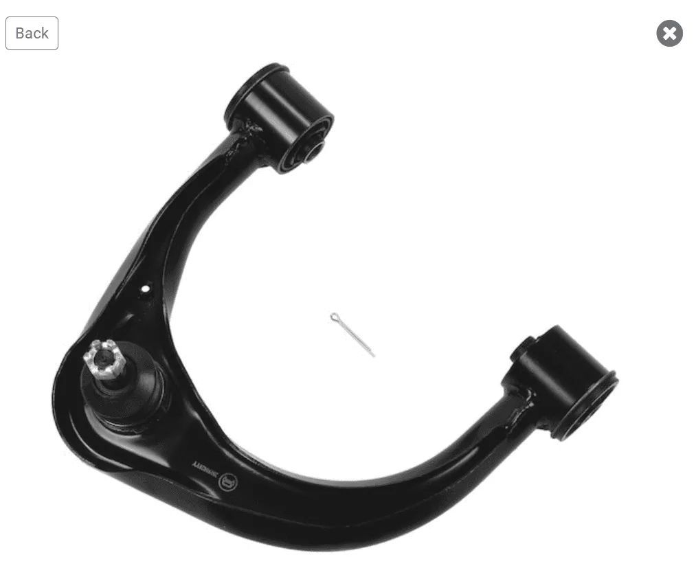

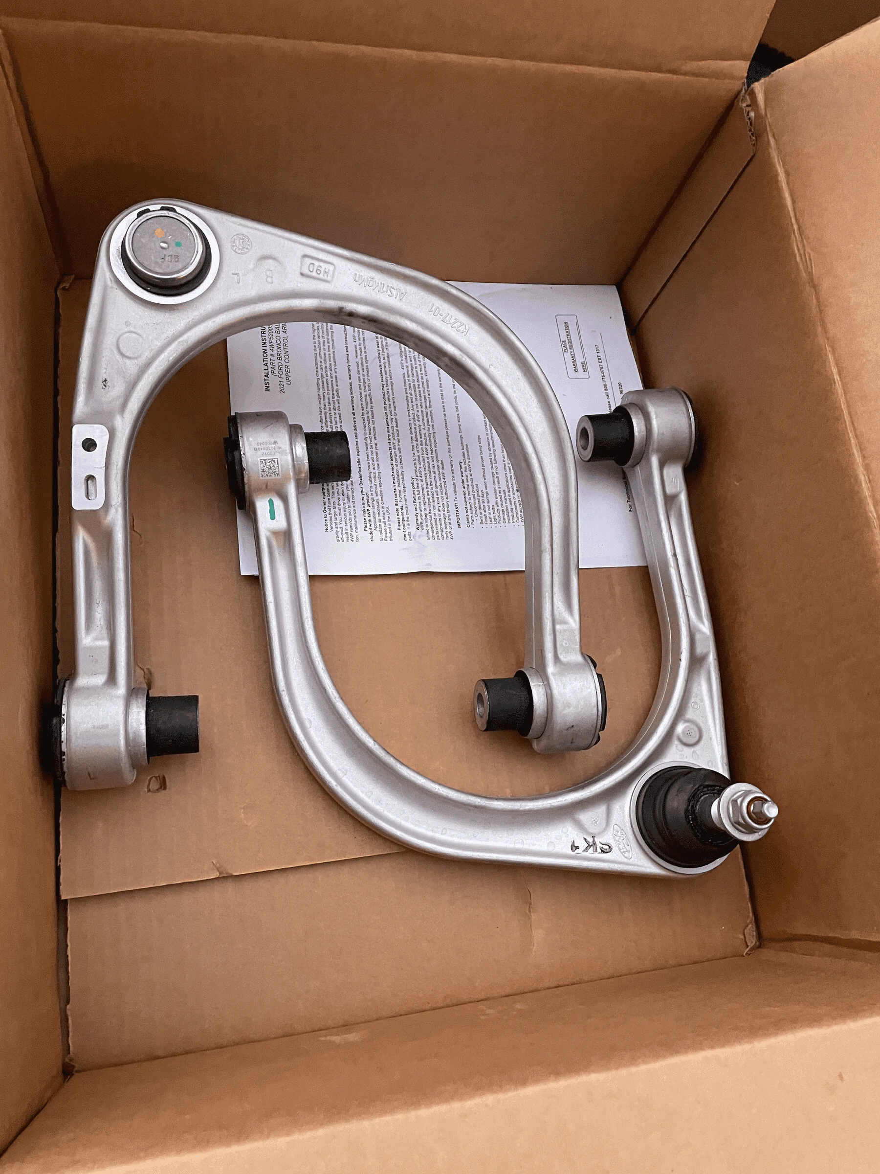

Looks similar to the 4Runner UCA. Maybe a bit longer.Here is a Bronco upper front arm.
You can see:
1) They are quite short. This makes getting more travel, without extreme angles, difficult.
2) They are quite minimal in size due to needing space for shock to go up the middle and clearance.
Yes, and we know all the tricks needed to get better travel out of those....Looks similar to the 4Runner UCA. Maybe a bit longer.
