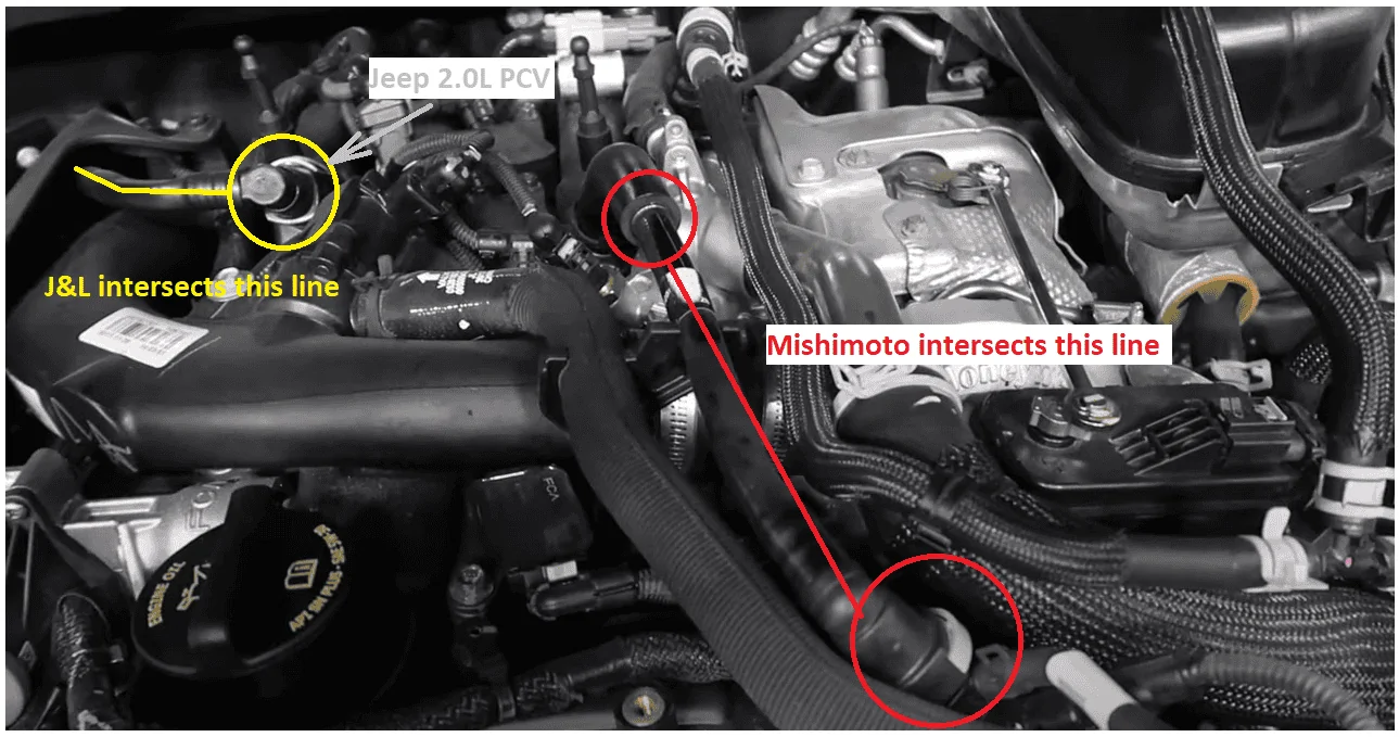

Please look at attached drawing. Both J&L OSC and Mishimoto are connecting their respective catchcans differently per their install instructions. You will notice that J&L OSC is connecting at the 2.0L PCV. Which one is the correct way? @Mishimoto.
Jeep Wrangler JL J&L OSC vs. Mishimoto catchcan installation Where2connect CatchCan

@sstuner , the reason why these 2 cans have different installation is because the J&L catch can is a PCV can while the Mishimoto can is a CCV can.
There are 2 different ventilation circuits on the 2.0. The PCV circuit is active/venting during non-boost, low-load driving. This circuit is only active when there is negative manifold pressure.
The CCV circuit gets activated under boost when a check-valve close the PCV circuit when there is positive manifold pressure.
So in theory, the J&L catch can will catch stuff if you drive more under low-load while the Mishimoto can should catch more stuff if you drive it like your stole it.

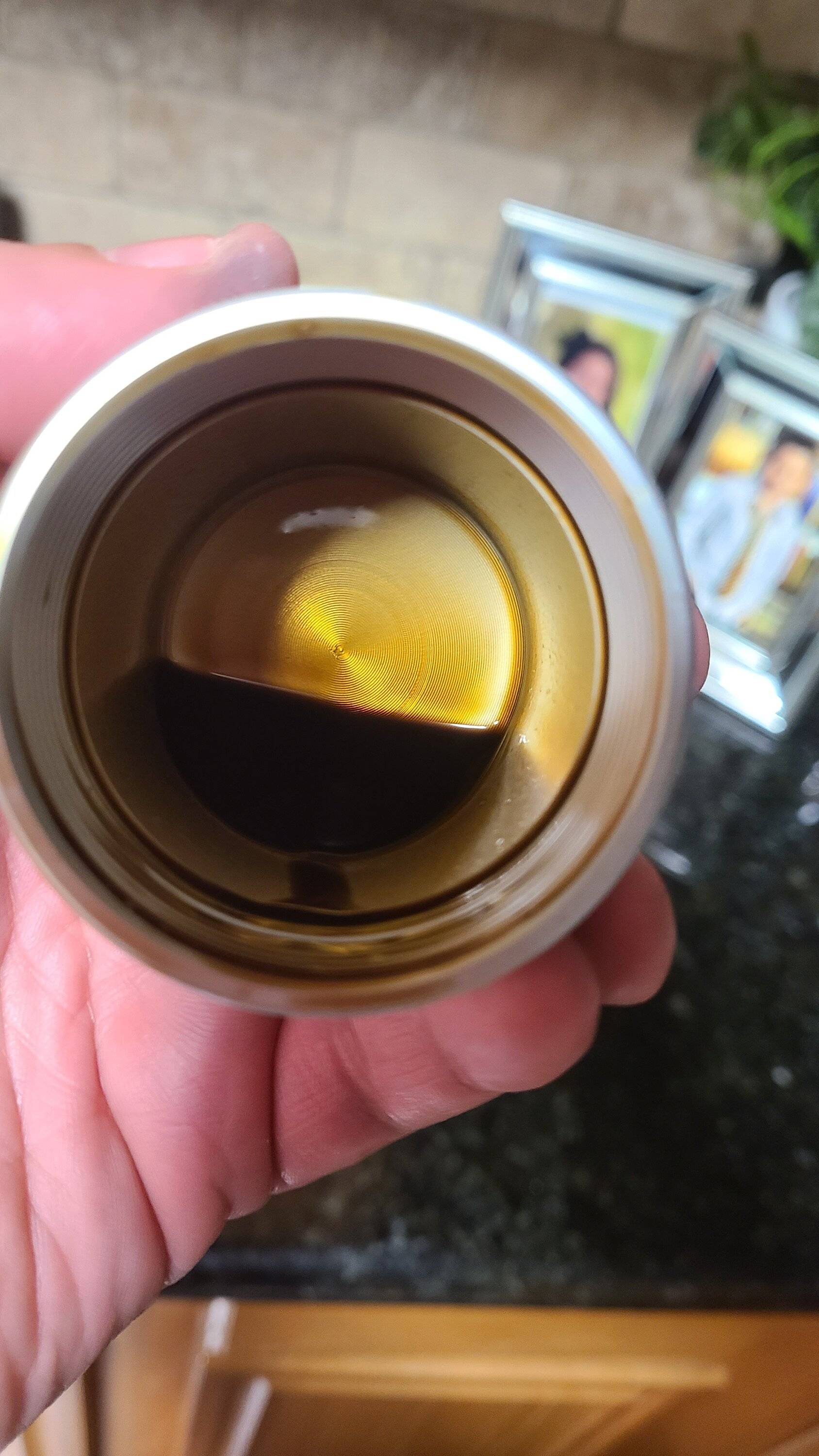

I installed the J&L can on Friday and checked it on Sunday. This is what was inside after two days.
Jeep Wrangler JL J&L OSC vs. Mishimoto catchcan installation Catch

I see installs off passenger side back of valve cover.
I see vent hose off driver side also returning to intake system.
Seems to only catch half the system?
