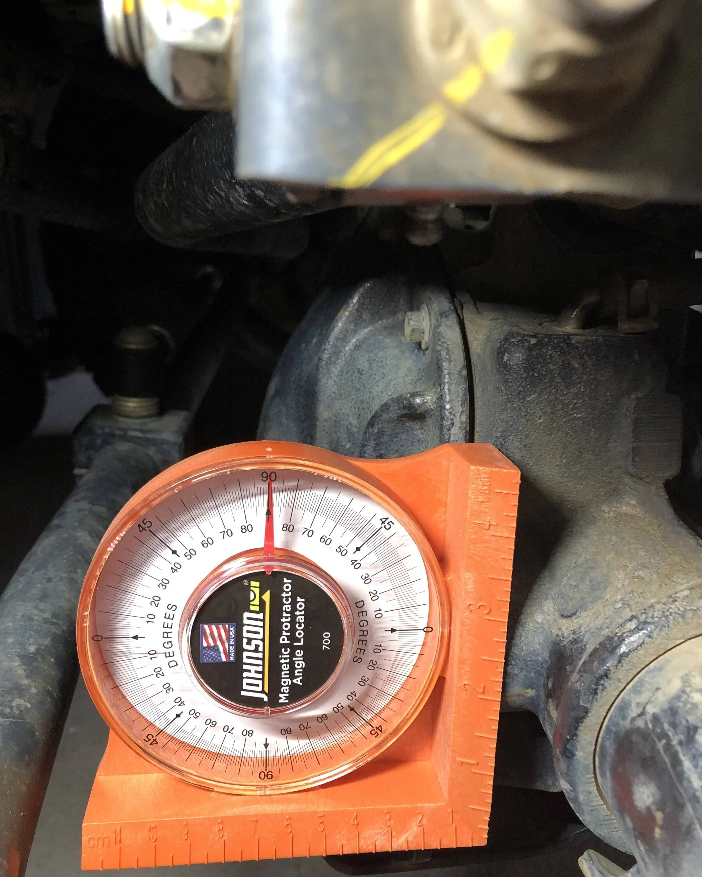

I read those but still unclear what you’re looking for….. if it’s caster, I was running 6.3 and 6.5 (on passenger side to help with road crown) with mid arm kit. When I installed my long arms I was able to dial it back to 5.9 ish and still had the same feel…..
Jeep Wrangler JL Installed beadlocks, now steering wandering - fix? C7466D59-419A-4F7E-849B-CA1C9AC756BB
this helped me to run a better pinion angle so my bumps line up better at full droop. They barely hit at all with mid arms and higher caster….this is once you get past 29-30” extended, not as big a deal for less travel shocks…..you could probably benefit above 6 degrees with 5.5” ish lift… that’s the advertised height, I bet you’re pushing 6-6.5” over stock…….You’ll have to be more specific on what other numbers you need, I’m not a very smart man……? I need things spelled out and /or simplified ? ….
Just as an example, on the JKU, there was a measurement for wheel base with stock axles and once you set that you could square the axles. What I have done so far to center the rear axle was set the axle so tire fit wheel well when drooped as centered as possible. I was wondering is there a recommended distance between axles. Tomorrow when I swap out the front springs I will finalize the castor and axle alignment.
Gotcha…… when I installed the long arm kit I pulled measurements from various places on the frame, then axle to axle. I didn’t use any stock measurement, honestly I don’t know of any literature…… I do have all my short arm measurements written down so when I’m installing a 3.5” lift I can go ahead and set up the arms before I install them to give me wheel well center and 6 degrees of caster and rear pinion at 2 degrees down for straighter rear springs. Saves me a ton of time….
