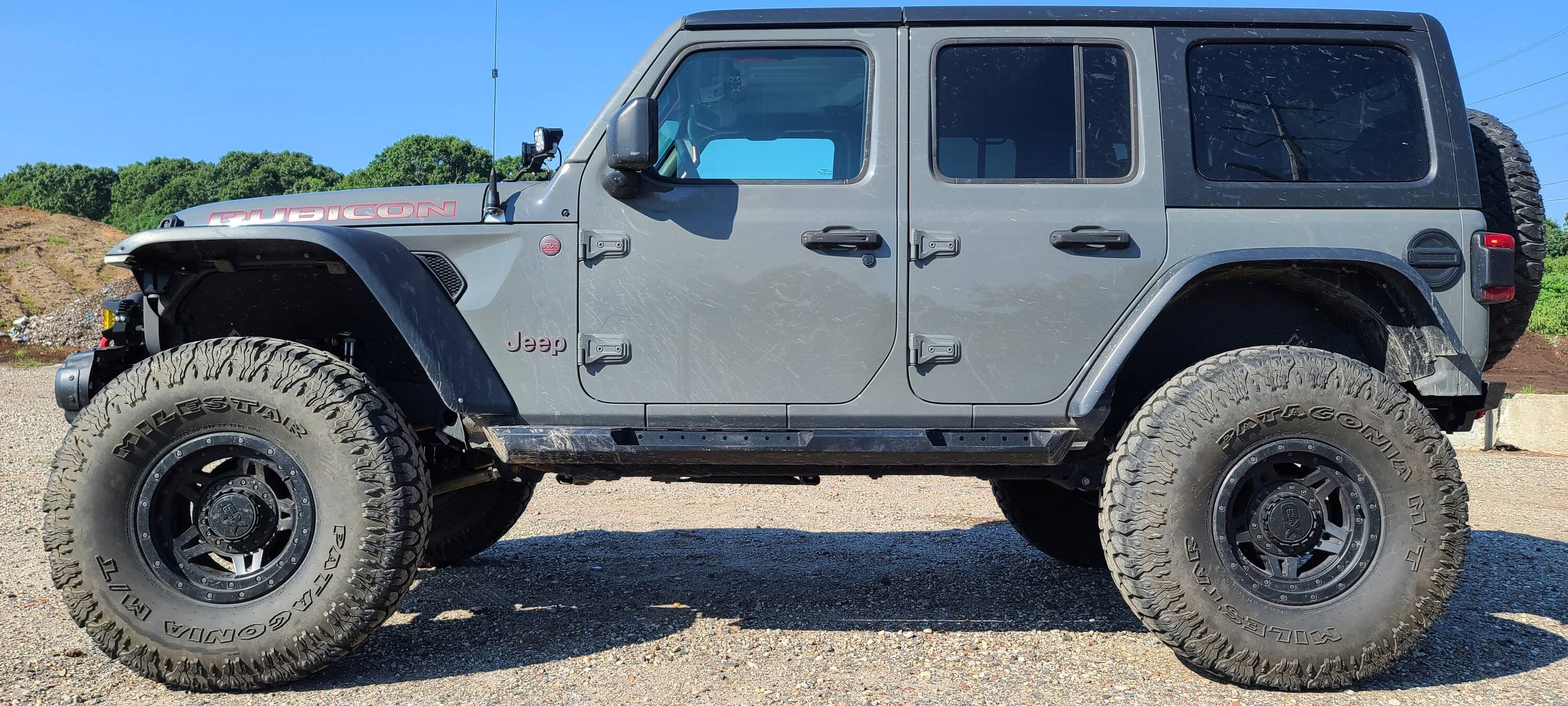

Update - aired down to 32 and then tried 30 psi and didn't seem to help much still getting a left/right/left/right wandering, especially at 50-60mph, and aggravated if I hit a dip in the road.
Going to check the alignment tomorrow, but if that test/adjustment fails I think my lesson learned here is that no matter what if you try to get too cute by adding bead locks to a stock non-adjustable track bar and/or non-adjustable control arm(s) to calibrate and adjust caster you are asking for wandering.
