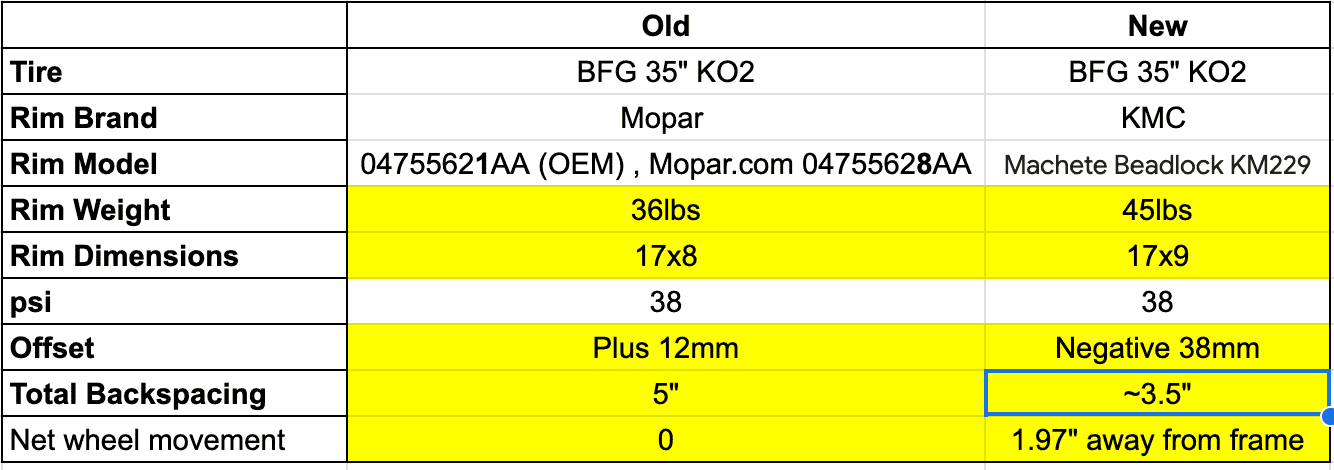

Update: still wandering like crazy, & I am still curious about the technical reason vs the variables that I changed that have thrown the JLs steering way off,
Doing a side-by-side I changed 3 variables
1. Weight (+9lbs with new rims each)
2. Dimension (new rims are 1inch wider 17x9 vs x8)
3. The obvious one is going from a +12mm offset to -38mm, ~3.5bs @ 1.97" away from the frame for each tire.
Out of those 3 variables which one caused the wandering or is it the combo of all 3? I see a lot of suggestions on caster angle but keep in mind I still have bone stock XR Rubi and everything else so there isn't much I can do aside from lowering tire pressure to try to help - is there anything that can be done with the bone stock config to fix this or do I require additional $$$ and parts to have normal steering back?

38psi is too high. What size tires? 32psi or under is where they should be, for a happy middle ground of good tire wear without being too mushy. The lower pressure will help lessen the wandering, but a higher caster angle is the real ticket.

He has the 315s from the XR. What did you run your 35s at? I know that was FOREVER ago ?

Just aired down to 32. thx!
