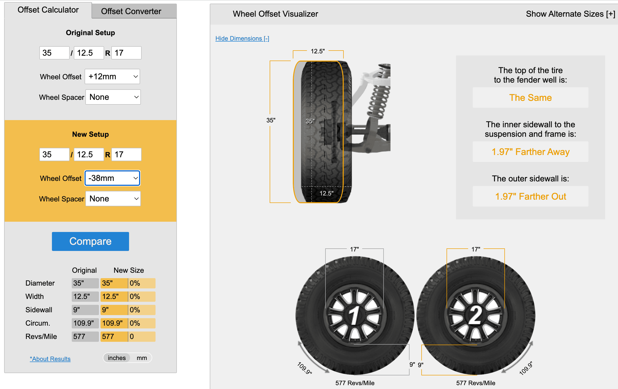

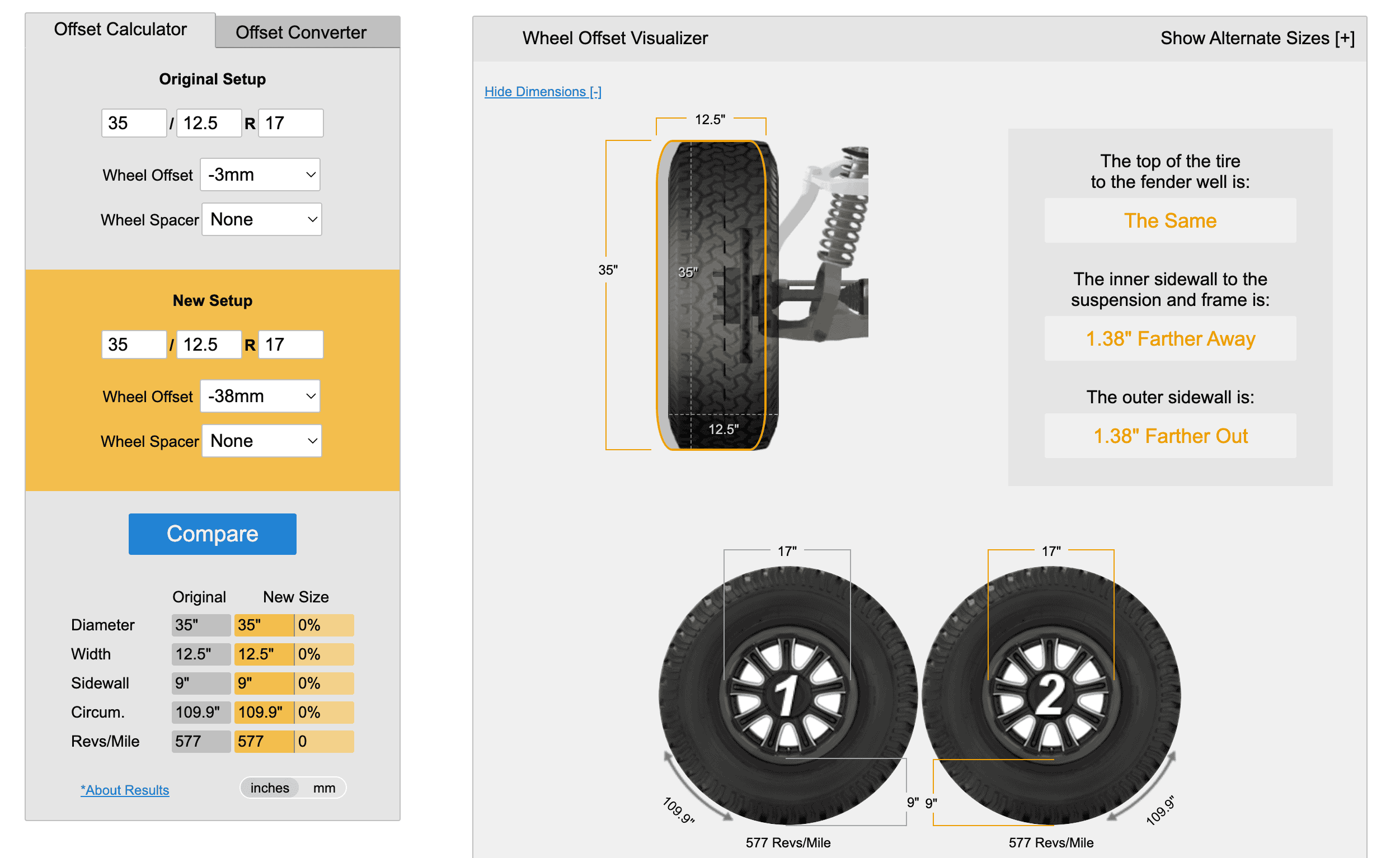

Old
Mopar beadlock capable - 17x8 , -3 ~4.4” bs
New
KMC - 17x9, -38 ~3.4” bs
Looks like my total difference is 1.38" out
Yes but the Mopar beadlocks were already pushed out from the stock +44mm offset. So it's 3.25" total.

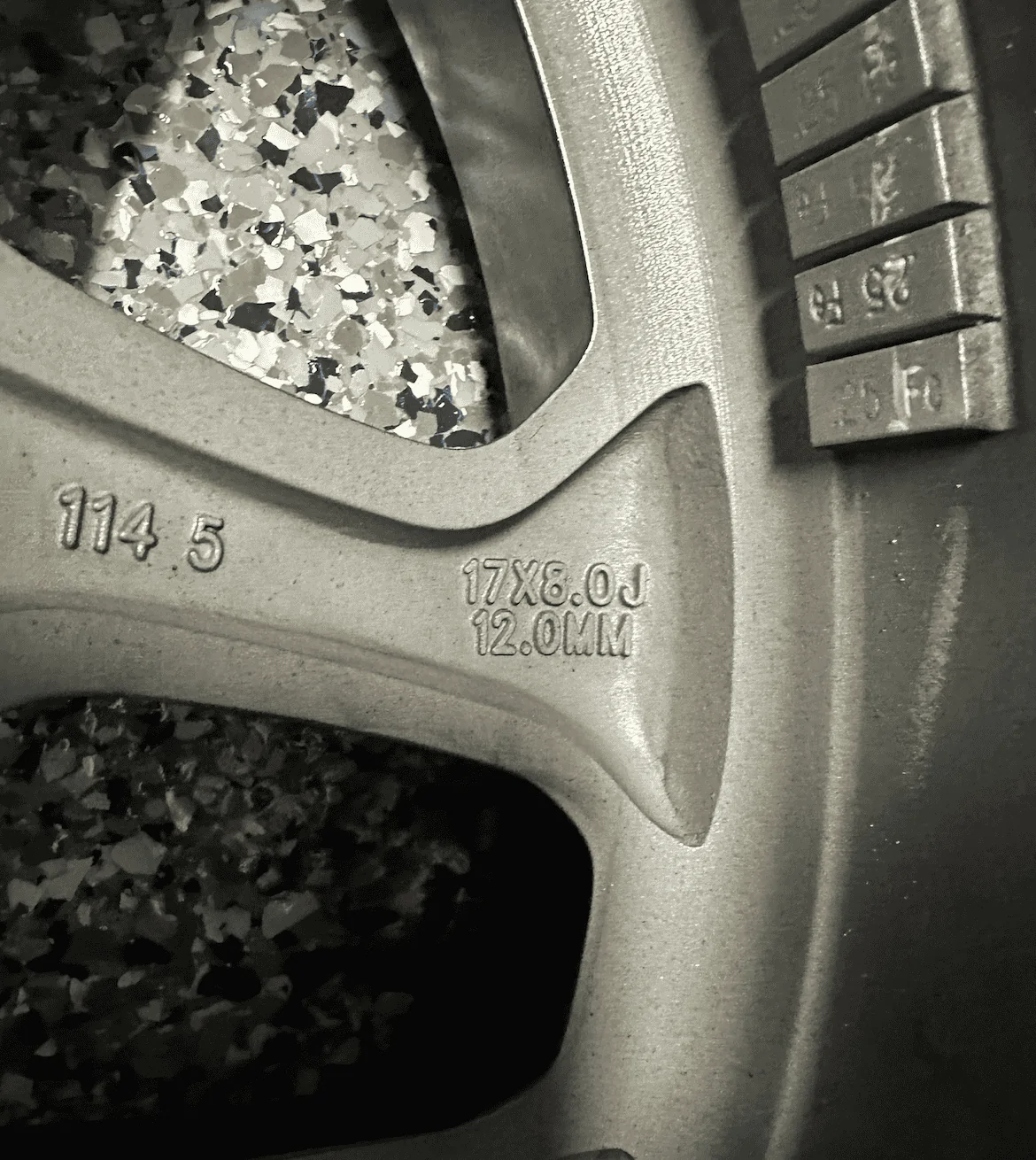

Finally went out to look at the stock rims , looks like we were both wrong they are +12mm 17x8
so 1.97 inches pushed out net

Sort of. Stock is still +44, but if you buy an XR with 35s, the stock wheels are +12mm. But that's already a change where Jeep has pushed the wheels out to fit 35s. +44mm is still the normal offset. The problem is the rest of the steering geometry is unchanged--same as a regular JL--so at +12mm you're already increasing the forces on the tie rods, etc. That's why I feel 12mm isn't a fair "zero" point for comparisons. But technically if you have an XR, yes.
In any event, you're down the rabbit hole now. Hopefully the steering upgrades solve your problem. If not, you keep throwing money at it with more upgrades until it rides nice ?

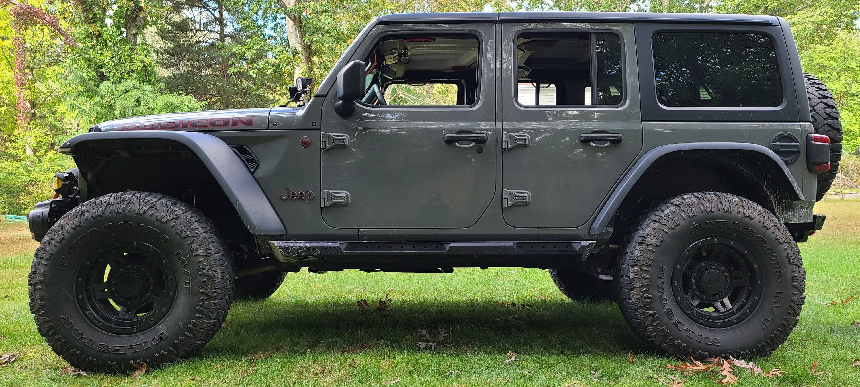

The wandering is the result of too low of a caster angle and/or tire pressures being too high.
Also, the 35's are exaggerating the heavier scrub radius. The taller the tire, the more it will offset the scrub radius. You might consider skipping 37's and looking at 38's or 39’s, although there are less tire options in those sizes. The 3.5" Metalcloak Gamechanger will likely net 4-4.5" of actual lift over a standard Rubicon.
For reference, here's my JLUR with chopped fenders back when it had the 3.5" Gamechanger and 38x13.5's wrapped around 17x9 KMC wheels with 4.53" backspace and -12mm offset...
