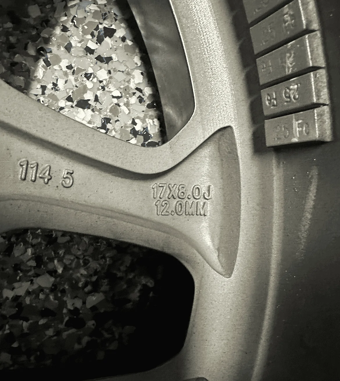

That is a typo on the Mopar website. The beadlock capable wheels have exactly 5 inches of backspace. my brother ordered them last year and I specifically took the time to measure them before they mounted a tire on them.

and you are right mopar site is wrong they are +12mm / 5" BS
