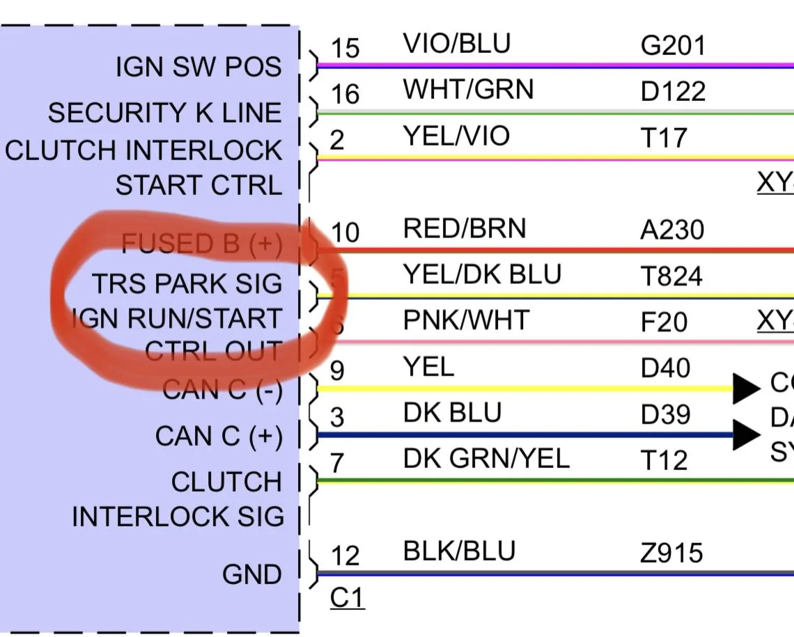

This isn’t as long of a shot as some would think. The “trans park discreet in” has caused issues in the JK, as mentioned.
I doubt this would cause it, however, the circled discreet is a requirement for the start sequence.
An inspection of the plugs may find a partially pushed pin, which could easily create an intermittent issue.
