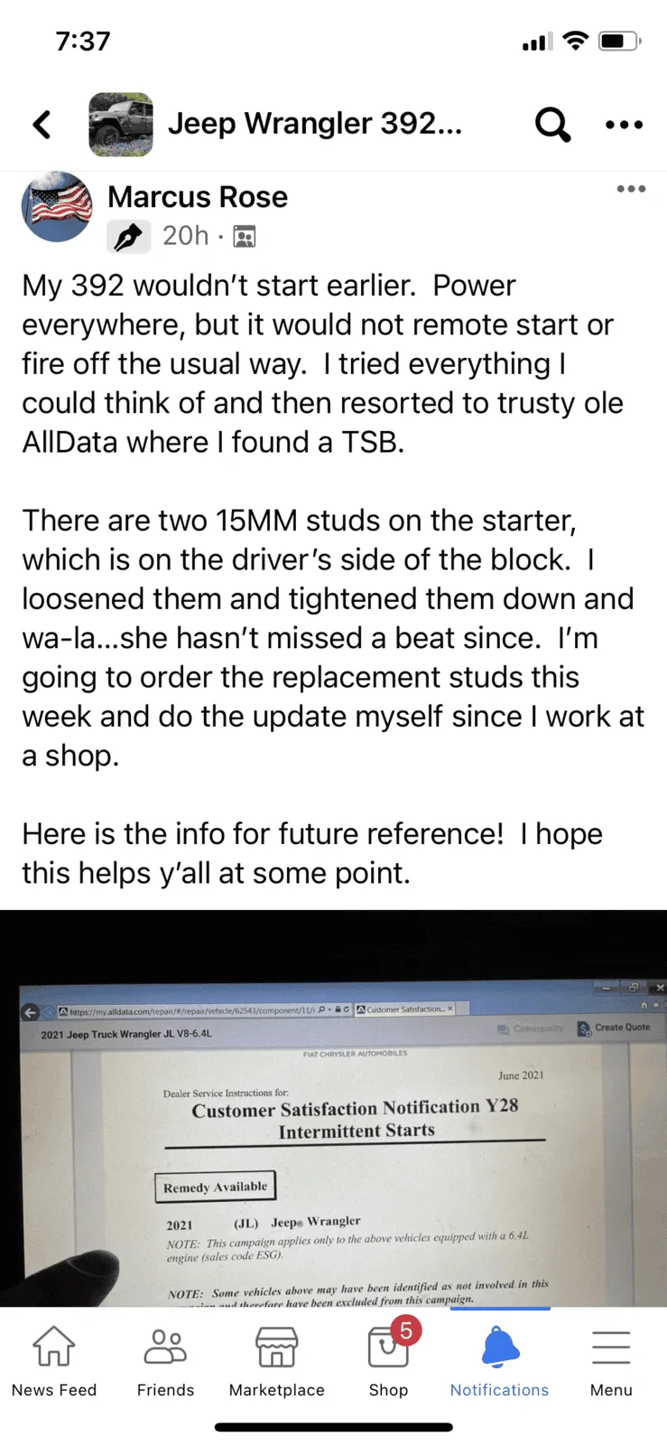

Sometimes when I start my JLUR the starter just turns over and doesn’t start, then I push the start button again and it will stop, then push it again Jeep will start......?...... only happens every so often, no pattern or reason. Anyone else have weird shit happening, but doesn’t warrant a trip to the dealer, which I avoid like the Covid.......?...... of course my apologies if already been asked and answered.
edit: ....... and yes... I pushed down all my fuses, and I have a catch can... so this kinda thing shouldn’t be happening...?
I know old thread and may not have anything to do with it but strange the 392s already have a TSB out. It may be a ground issue with bolts. Saw this from Marcus on FB and thought would throw out there.
Thanks Rick.... I’ll check into it.
