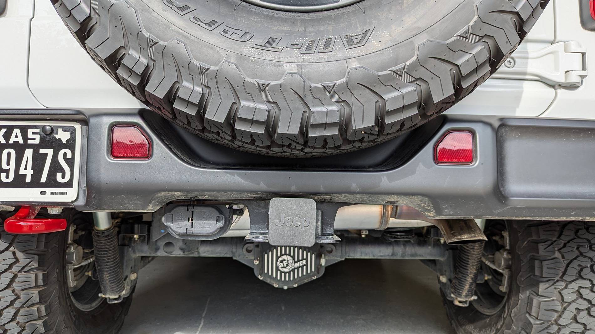

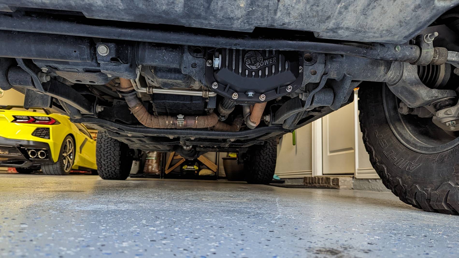

A few main reasons I added the aFe differential covers (front & rear) to my wife's JL after she peeled the stock rear cover on a rock:
1. Increased fluid capacity + more magnets
2. Better cooler (cast aluminum)
3, They look cool (just being honest)
Jeep Wrangler JL I have a (probably) stupid question 1000002233
Jeep Wrangler JL I have a (probably) stupid question PXL_20231202_232043691
I do like the sight glasses to check fluid condition too.

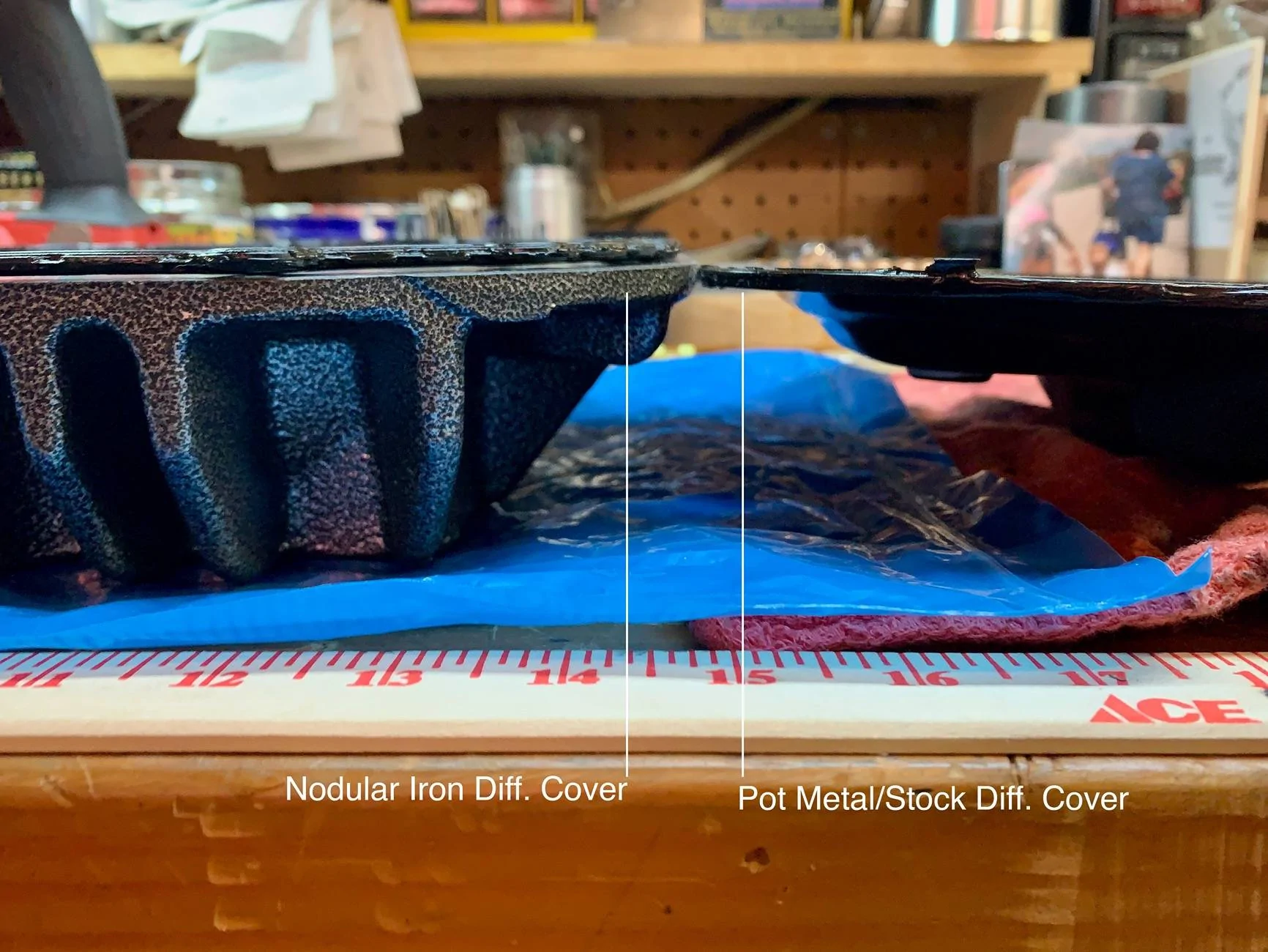

Why do folks buy aftermarket diff covers - some say for rock-bashing durability - when the diff covers are on the BACK of the diffs?
Today while admiring my Advantek Nodular Iron diff covers I thought about your question, and remember making this picture when I changed my covers after re-gearing. I'm sure someone's already mentioned this, but like many other things on the Jeep as it leaves the factory they're probably trying to keep weight to a minimum. The weight difference between the stock diff cover and the Advantek nodular iron cover is substantial. It's worth noting that the Dana crate axles ship with these nodular iron covers - not the cheap, pot metal covers. Some of the reasons may be they care less about weight and more about protection, aesthetics and stiffening up the pumpkin. And yeh, they look good too.
