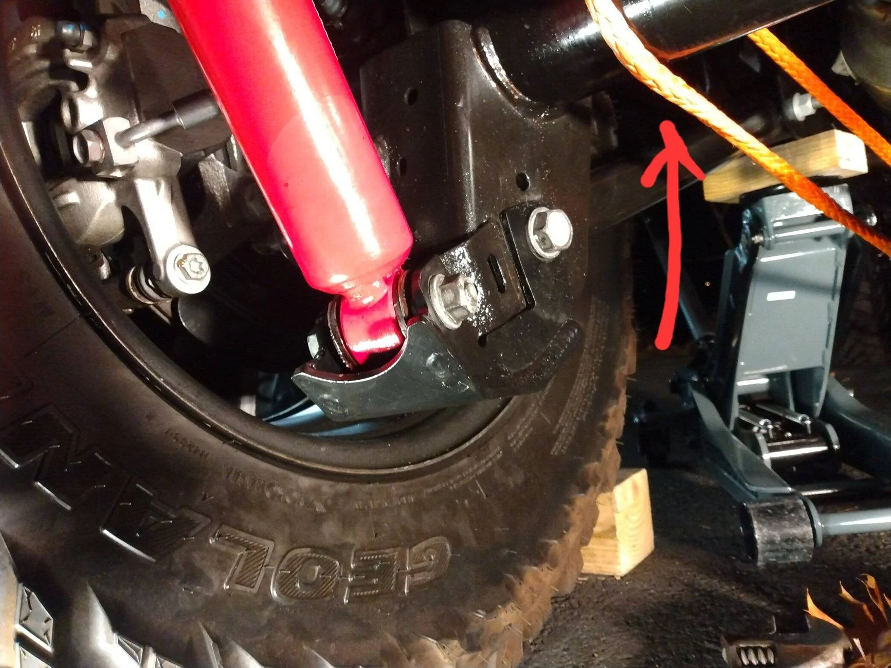

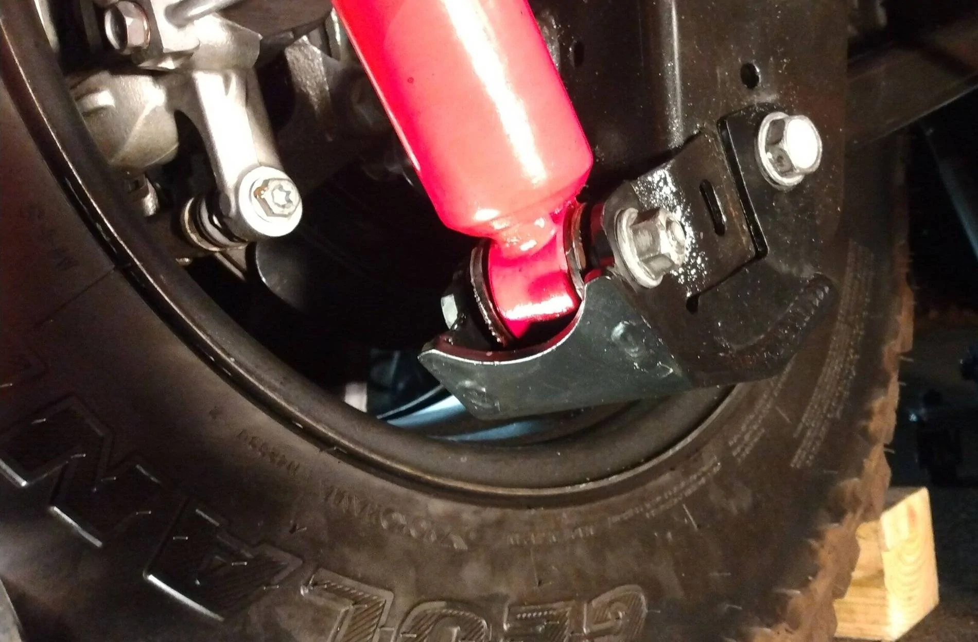

I went with EVO's, they were right around $80. @Northridge4x4
Installation: I believe I made the mistake of not loosing the bolts on both sides. I installed one side and the axle shifted. I tried a cheap ratchet strap to pull it back but it exploded right near my face and I almost took an S hook in the eye. I actually used my winch, under my jeep, around the axle, lined up the bolts, done. The other side, didn't shift, 2 bolts, piece of cake.
Fyi, it doesn't take much of a hit to damage/deform those shock mounts. My first time on the trail after installing them, BOOM! the EVO skid takes a hit, zero damage, worth every penny.
