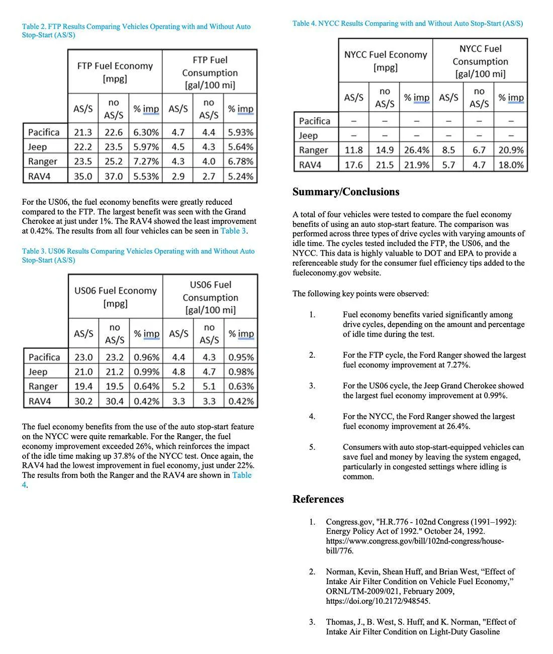

You know there is good data in the DoE and EPA studies which found the benefit can be a 25% increase in fuel economy from stop-start tech alone. Of course, those studies have been ripped down from those websites because, well...you know why. They don't support the current narrative. But those studies still exist, and the data was sound.
Here's the study. The ~25% mpg improvement figure is based on the single biggest outlier datum (resulting from a simulation of a light truck traveling 1.18 miles over 10 minutes in NYC traffic).
Sounds like a very real use case.
Everything else can be assumed to be in-between, which I'd say isn't ignorable.
It's "like a very real use case" that's intentionally designed to not represent overall "benefit... in fuel economy from stop-start tech". The fact is, that particular test shows a 26.4% improvement in mpg requires idling a Ford Ranger for 37.8% of the test period.
It's clearly not a "good" study with "sound" data; the authors chose 4 relatively inefficient vehicles for unscientific reasons ("The use of these particular vehicles was highly opportunistic."), and inexplicably didn't put 2 of the vehicles through one of the 3 tests. It also looks to me like they sloppily inverted table data/labels, but maybe I'm missing something. In any case, it's a somewhat interesting experiment, but concluding from it that ASS-tech can improve fuel efficiency by 25% is a poor way to summarize it.
You'll see from the summary/conclusions that "Consumers with auto stop-start-equipped vehicles can save fuel and money by leaving the system engaged, particularly in congested settings where idling is common."
Based on their tables, the more ASS engages, the higher the fuel savings.
The most popular vehicles in the US are full-size pickups so I find their vehicle choices (a midsize SUV, a minivan, a small pickup, and a midsize crossover) to actually under-represent reality, so it's possible larger and less efficient vehicles could stand to save even more.
I don't actually (personally) like stop/start systems, but I'm not going to discredit a valid study that says there are savings. On a fleet average that adds up to a LOT of fuel and emissions over years of use.
