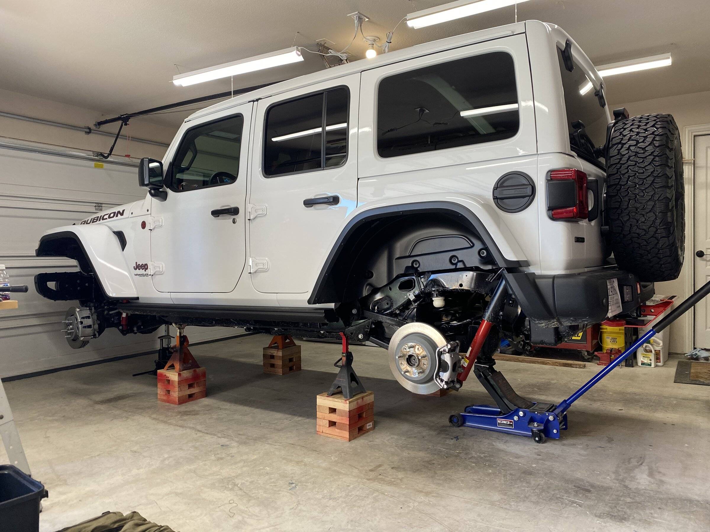

As mentioned, you either need spring compressors (and a death wish) or you’ll need to get the Jeep high enough in the air that you can droop the axle far enough the springs fall out. This happens right before your brake line becomes taut though, so watch them carefully.
To get the Jeep high enough you’ll either need TALL jack stands (like for RVs) or some cribbing blocks. Normal people jack stands don’t go high enough.
After pricing tall jack stands I decided to make cribbing blocks. All nailed and glued with plywood top and bottom. Bonus: I can put them next to the front tire to stand on when working under the hood.
You’ll also have an easier time if you have two jacks. That way you can lift either side of the axle independently. Put left spring in, raise axle a tad on left so spring doesn’t fall out. Repeat on right side.
Cribbing blocks under jack stands:
