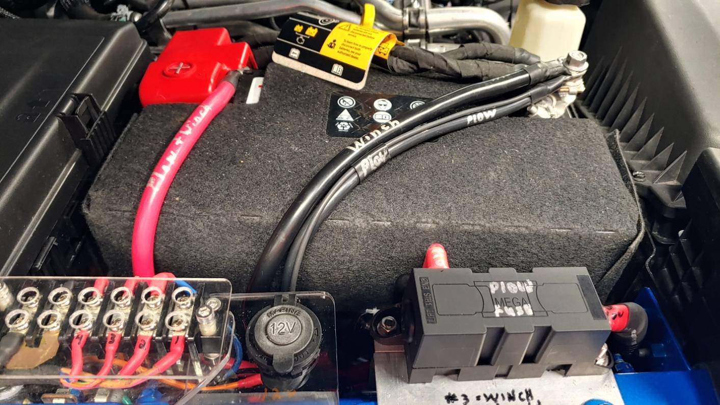

Wire to the battery - but don't bypass the IBS.
This, for example, is fine ->
Jeep Wrangler JL HELP - unsafe steering issues 20221109_160609_HDR
The ground comes from the top of the IBS, just like the ground for every other part of the Jeep.
I also have RSE power steps wired to the battery - ground going to one of the chassis ground studs on the fender by the battery.
These vehicles are subject to ground issues - there's even TSBs out there on steering pump grounds and other ground issues, showing how to check and clean them and so on.
