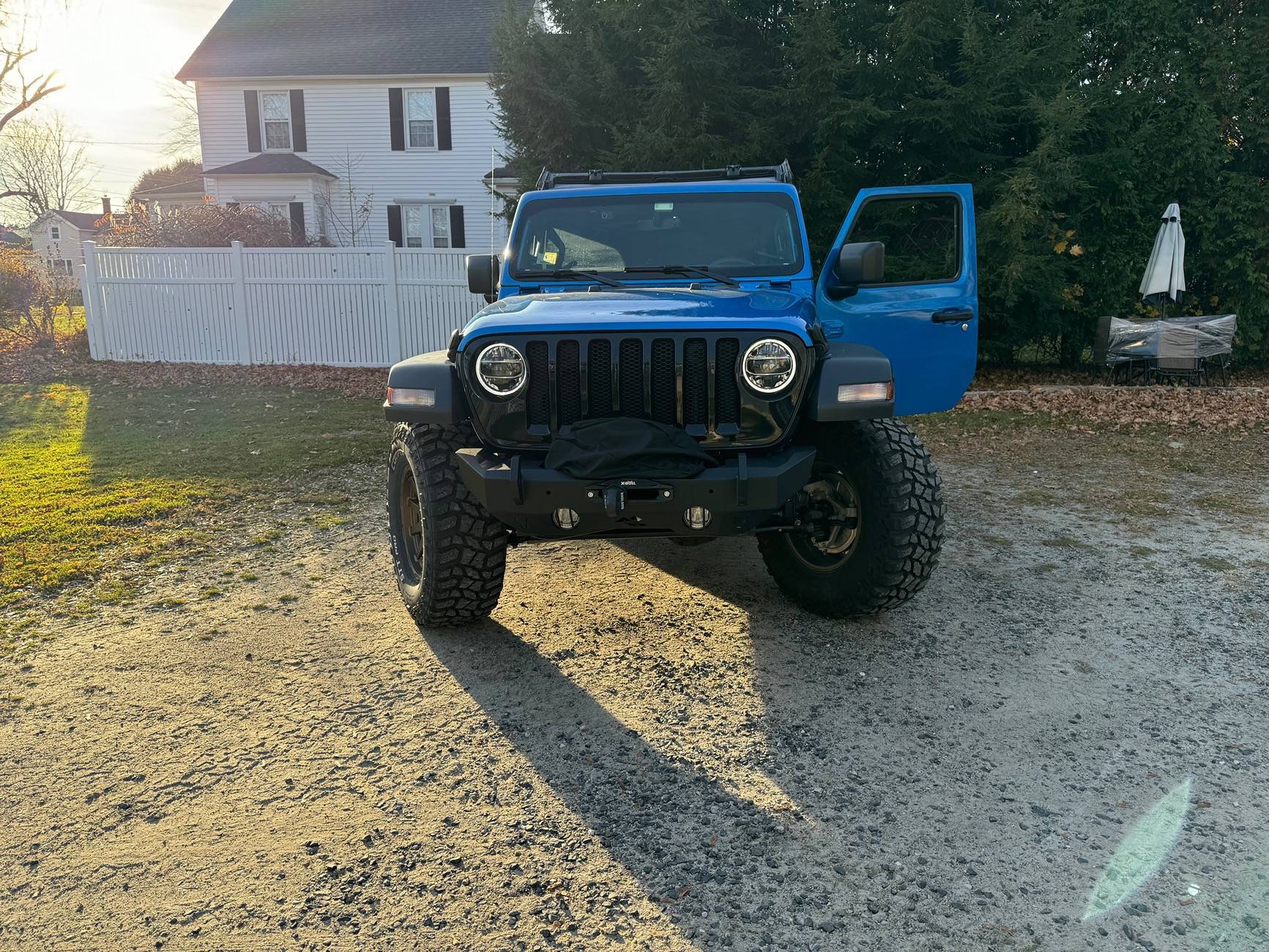

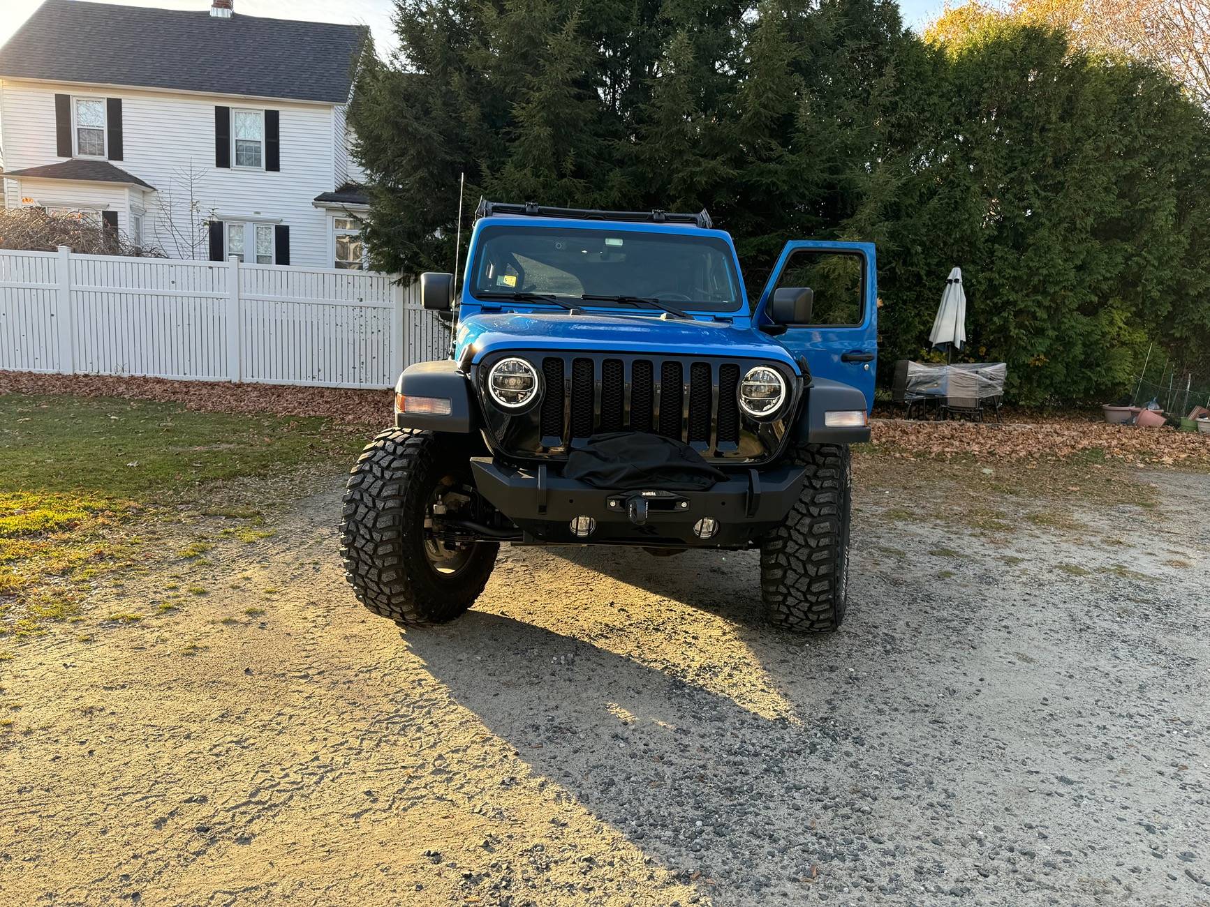

When going straight the jeep pulls right pretty bad. Is also affected under braking. The ball joints were replaced and an axle tube I believe. The insurance still will not provide a detailed work order same with the dealer. They stated they replaced parts that they didn’t, track bar is the one I put on. Is my only vehicle and is undrivable. Here is photos of it at full lock where I can feel it binding up.

What should I look at to do to make it right. When I installed everything it was perfect. Now I have to rely on ships since I injured my back and cannot do the work myself

Alignment sheet? Could be as major as a bent axle or as minor as a toe adjustment. Without specs you're throwing darts in the dark.

I think it would be more cost effective to take it to an alignment shop and get actual specs before guessing and throwing parts at it. Just tell them you want closer to 6⁰ of caster not the 4⁰ Jeep recommends. Drives much better at that setting.
