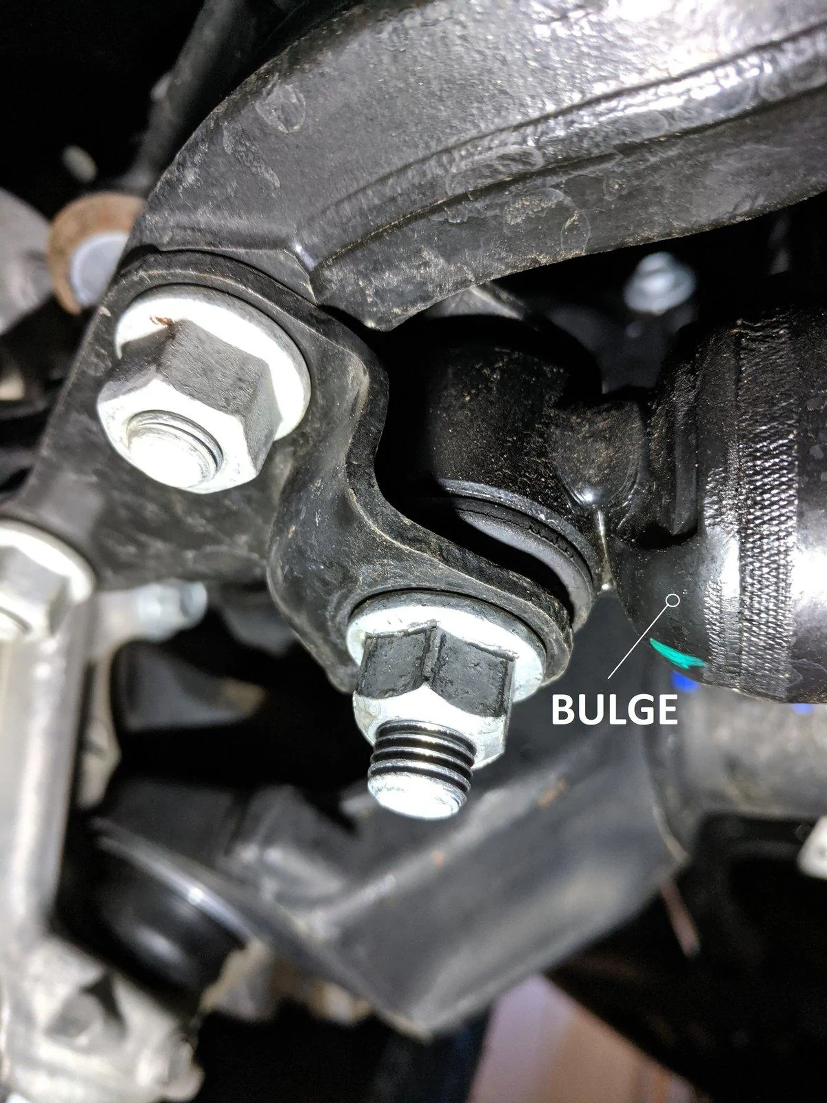

As you can see from the attached pic, the bulge in no way interferes with the mounting of the stabilizer. Seems to be plenty of room to me.
Excatly.....a 8mm socket and 3 minutes sets it correctly if the dealer install didn't get it right.

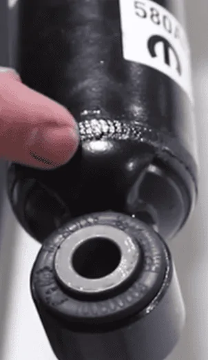

Hey all... I just want to reiterate to check that the bulge on your replaced steering stabilizer was indeed installed in the down position. Don't take it for granted.
When mine was installed I told the service writer about the need for it to be installed downward and he said "oh ya, we know, we do this all the time" and then disregarded any further communication. Then when they finished, I checked and sure enough the bulge was in the upward position. The tech then came out to look at it and was not happy with me when I nicely explained the new stabilizers need to have the bulge in the downward position. I became the "bad" guy. Why are some dealers so arrogant and can't accept the fact they don't know it all.
As one previous post joked about; The dealers are still putting 6 quarts of oil in the JL's. I too had six quarts in mine!
Wow thanks! My steering has been awful since they changed it (it was perfect before!). I just noticed they also have it upside down. This from one of the largest dealers in Idaho! I would have much rather had the $$ and purchased aftermarket!

Did they install the steering damper correctly? Many people are posting that there's was installed upside down, they don't work properly if installed wrong.
