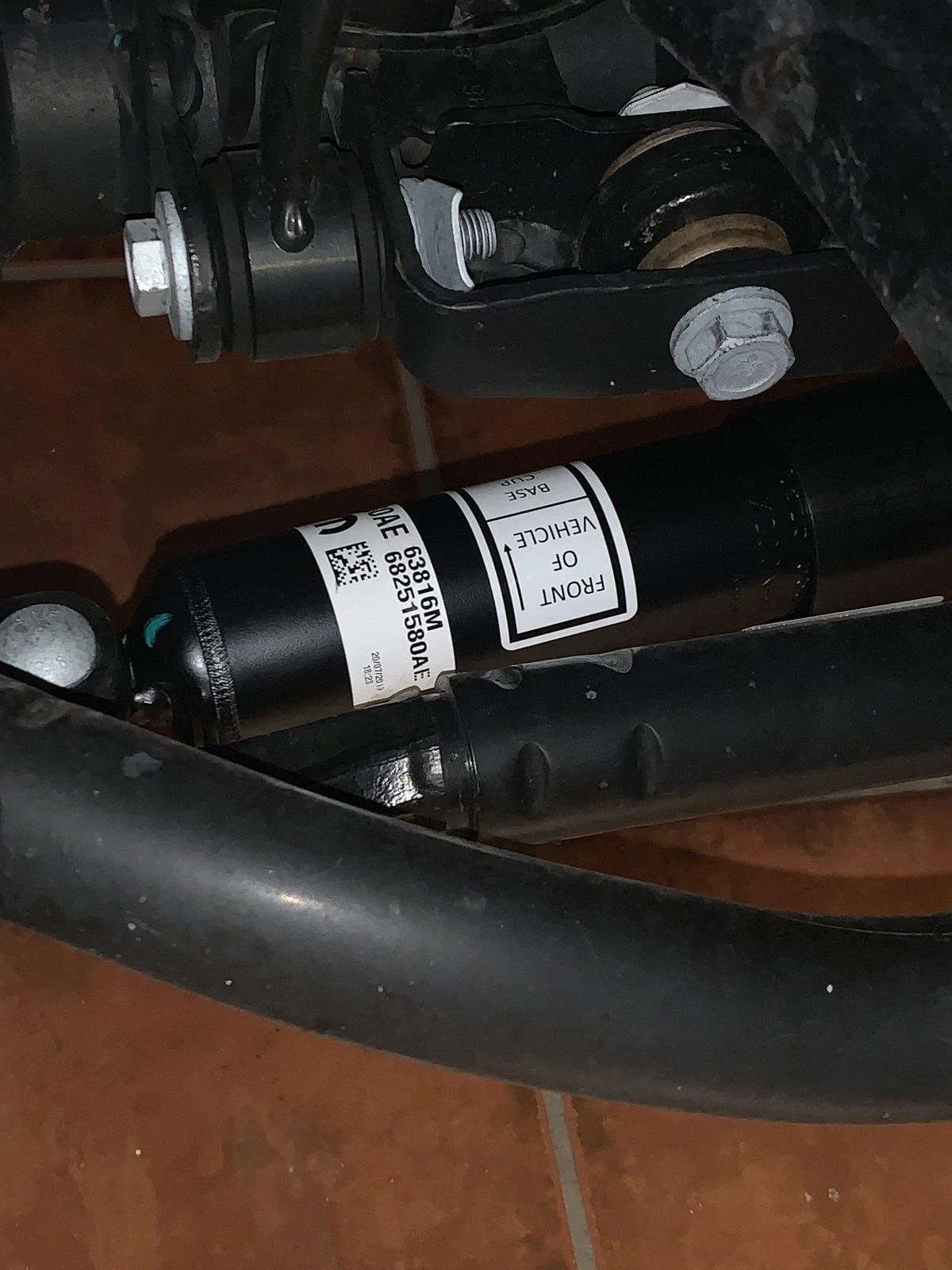

As you can see from the attached pic, the bulge in no way interferes with the mounting of the stabilizer. Seems to be plenty of room to me.
You are absolutely correct !, I don't know what they initially were talking about, come to find out "it was done properly the second time ,they turned it 180 at my insistence and it fits ,with no rub or binding,....torque to 51 ft.lbs., and good to go, albeit a non fix, i see no difference,however with a BRAND new jeep,I should not ,unless other suspension parts are bad, or the other item causing wobble or vibration....these dealerships leave a lot to be desired. I can't figure out if lazy, stupid,inept,or just dishonest...we shall see

Is this pic the correct or incorrect. I’m waiting at the dealership now and that looks like the way mine is installed currently. Want to bring it to their attention if it’s incorrect.
View attachment 227247 View attachment 227240 Thanks for the post on the damper being installed in the wrong direction . . Had the recall taken care of and they installed it incorrectly . Took it back the next morning and it was redone.
They said they had a meeting half the techs knew about the correct installation position the other half admitted they didn’t read the diagram / instructions . Very easy for owners to do a visual inspection to verify . Thanks again for all who posted pictures .
First pic (incorrect )
