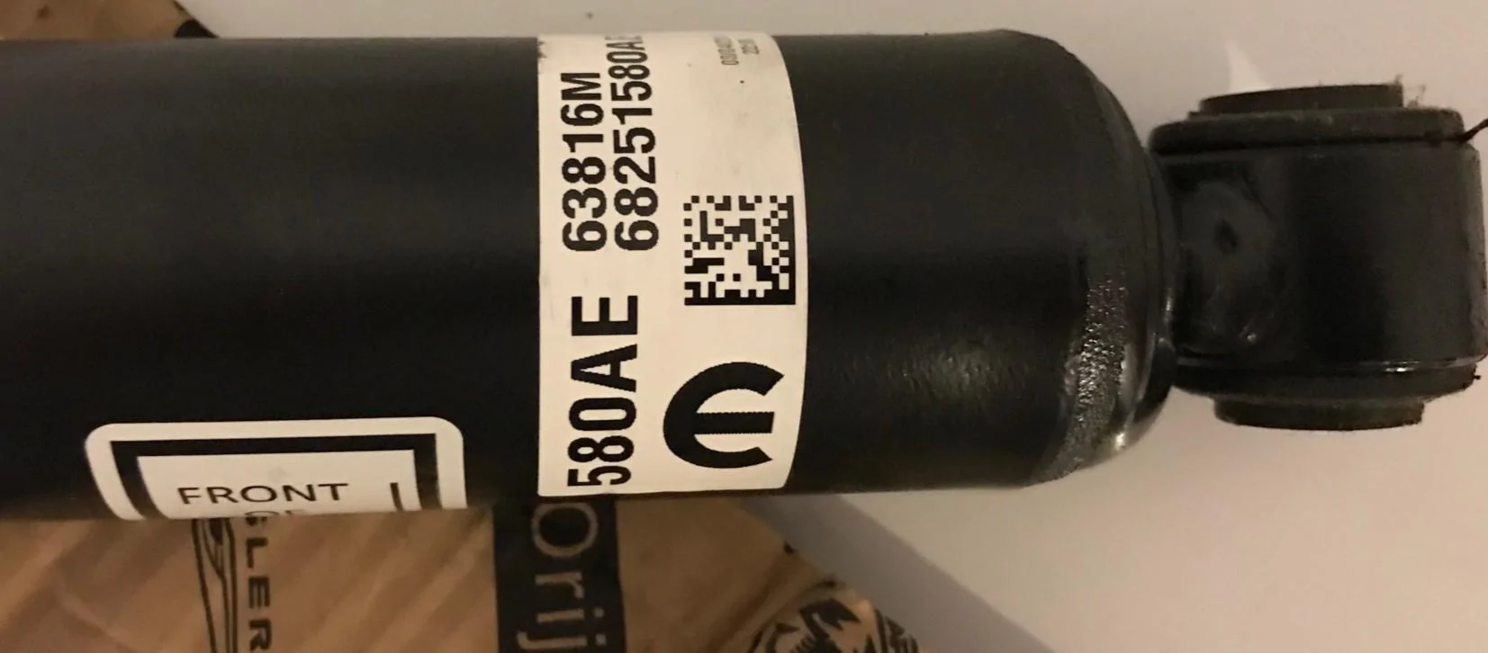

Is this pic the correct or incorrect. I’m waiting at the dealership now and that looks like the way mine is installed currently. Want to bring it to their attention if it’s incorrect.

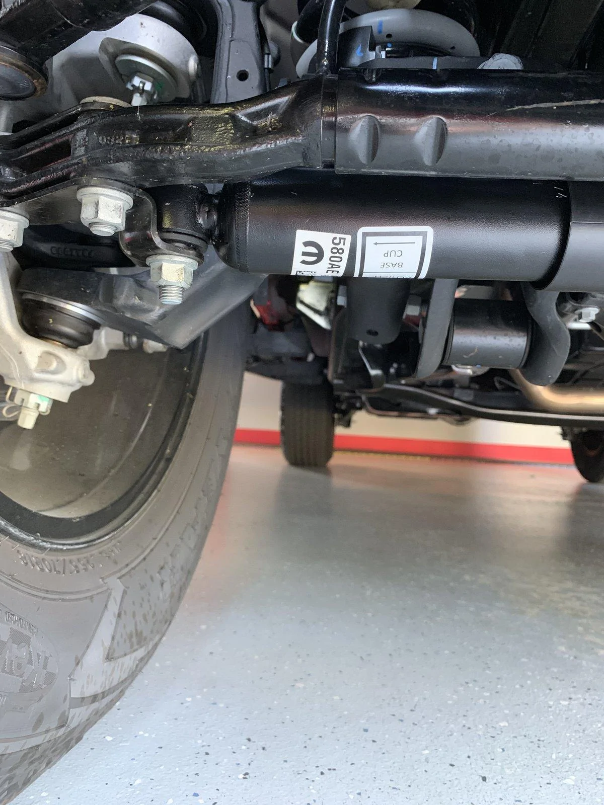

View attachment 227247 View attachment 227240 Thanks for the post on the damper being installed in the wrong direction . . Had the recall taken care of and they installed it incorrectly . Took it back the next morning and it was redone.
They said they had a meeting half the techs knew about the correct installation position the other half admitted they didn’t read the diagram / instructions . Very easy for owners to do a visual inspection to verify . Thanks again for all who posted pictures .
First pic (incorrect )

Took 3weeks to get in but looks like it’s done correctly from other post I looked at!
I'll be dern if i know why the bulge needs to be on the bottom, but I assume this insures oil inside does some miraculous thing in that little bulge

Update to my post, mine was in fact installed wrong... definitely check! This pic is the wrong way.

After opening a case with Jeep Cares and finally getting to speak with the Service Manager (who insisted it wasn’t possible to install the damper incorrectly), I brought it back. The Service Manager called out their “Master Tech” who proceeded to tell me the sticker didn’t matter and it was installed correctly. I asked him about the bulge on the intake cap and got a blank look, so I whipped out a printout of the CV41 pdf and handed it to him.
I’m in the waiting room now while they install it correctly, but unbelievable that I had to go through that.

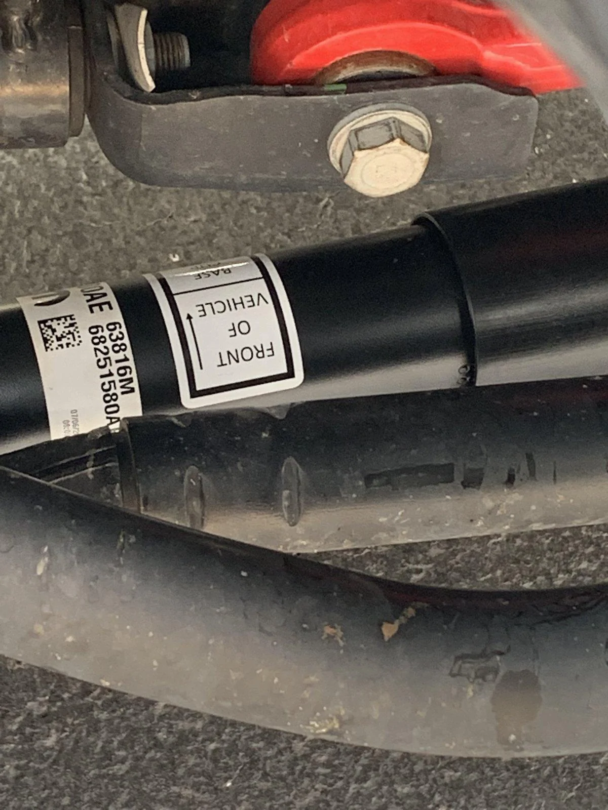

My wife took this picture with her today to have the dampener changed.
Showed it to the service writer upon arrival.
It was installed correctly....
Seems to have tightened it up a bit on the 50mph twisty state route.
Haven't had it 70mph on the interstate yet.
That picture is wrong though...why take a wrong picture

That's why I took the picture. To show them how NOT to install it.
oh...lol. I have to take mine tomorrow. i want to tell them what to do, but I also don't what to seem like a know-it-all....I hope they do it correctly
