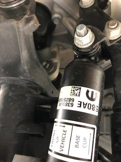

Mine was done correctly this morning in about 30 minutes. I only drove it home, seemed fine. Not really sure I ever noticed an issue.
Attached is a photo from underneath. Not sure it will help with reference.
Don
Jeep Wrangler JL Got the V41 recall work done IMG_9877

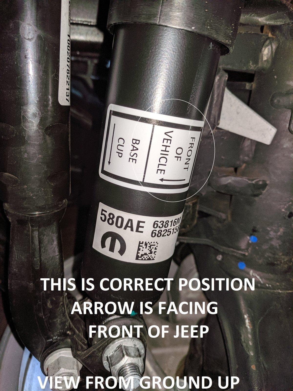

tk2fast
Terry
Jun 2, 2019
91
47
Arizona
2018 JLU, 2000 TJ, 2001 XJ
Can someone post a pic of how it's supposed to look then? All the pictures here show it backwards lol
If the arrow is on the top pointing toward the rear of the Jeep it's backwards.
Arrow should be on the bottom facing toward the front.
Jeep Wrangler JL Got the V41 recall work done JL V41 PROPER

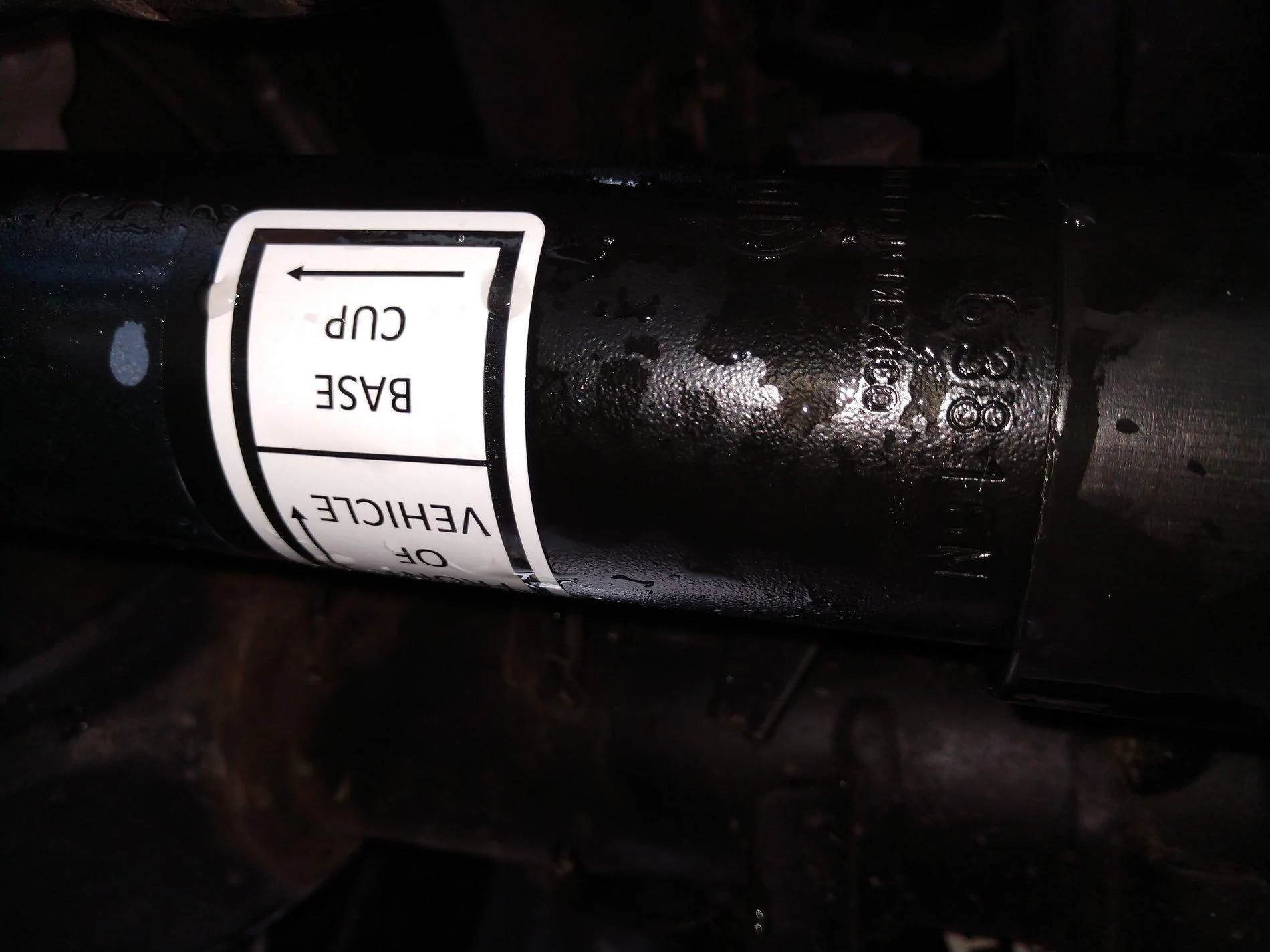

Dropped mine off for the recall- that's all they had to do. Got a text around 11 AM with a link for a video walk around - hood up, air filter out. Service guy was narrating trying to sell me all the the things I should get done while it's there, change air filter (only 16K miles), nitrogen charge the tires and get my state inspection done a month early. Tell them no, I'm good. Go pick it up and they even washed it.
You had one job.....
If they spent as much time doing the actual service as they did trying to enrich my "experience", maybe they would have got it right.
(upside down)
Jeep Wrangler JL Got the V41 recall work done sXE1NJ4u_FXFcVxiP5ciiyS00F5Wc2qUvNnoTvgRVI72V0JfyM5U3A69GR7sDOIvmtwOZP9Y6tDT0YK-Fi=w1139-h854
