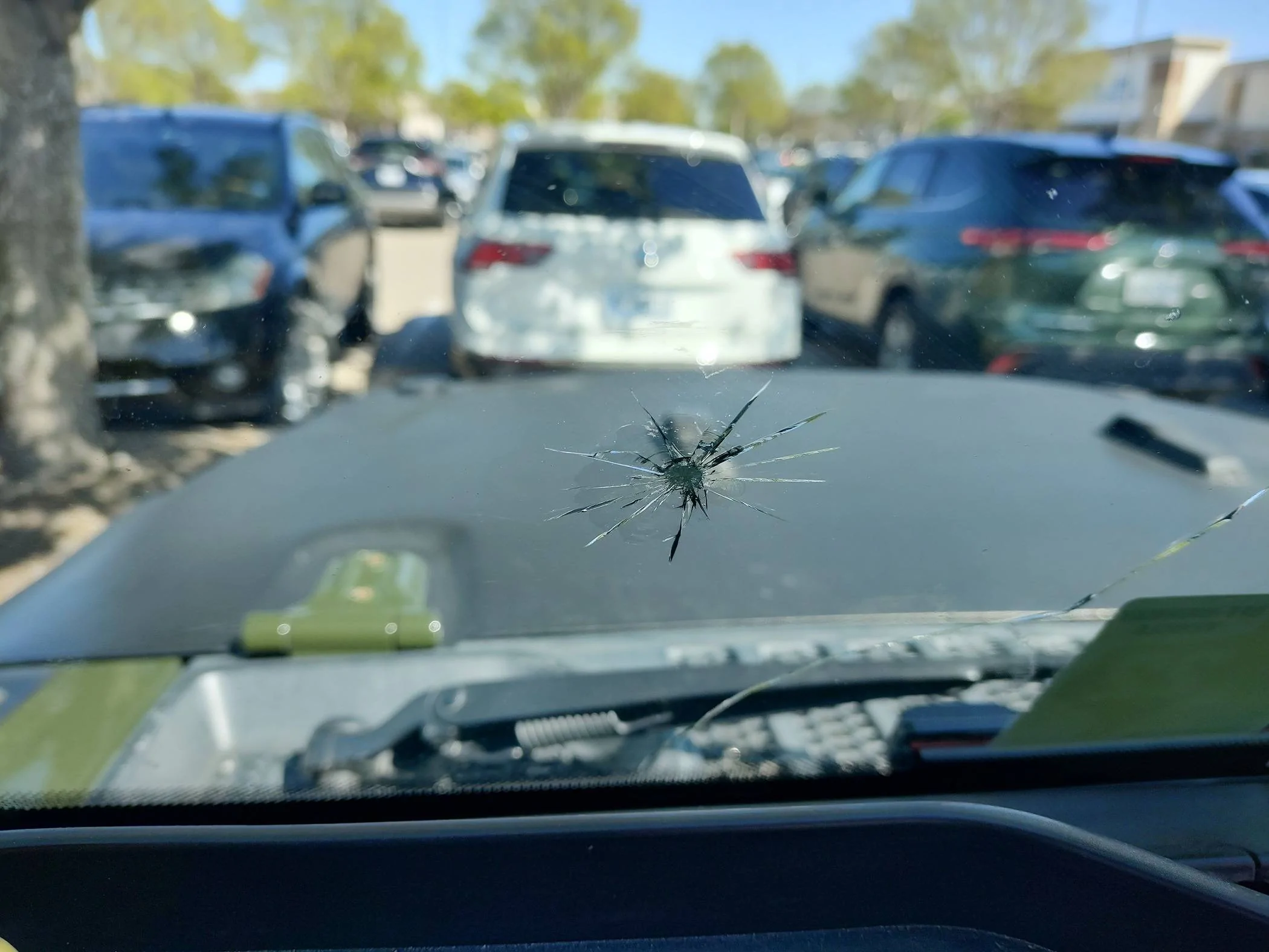

This is my OEM non-Gorilla Glass.
Jeep Wrangler JL Gorilla glass breaking without impacts? IMG_20240319_154607653_HDR
The big crack I got last summer, it started off as a small little rock Chip, I patched it up and the second came to winter and I put the heater on, it just went up to the top of the window.
Jeep Wrangler JL Gorilla glass breaking without impacts? IMG_20240319_154604747_HDR
The massive spider crack there happened last week driving home from work. The window got hit by a marble-sized pebble as I hopped into the fast lane. I did a DIY fix again and it seems to not be spreading right now, but who knows. ?‍♂
So yeah, 2 years in and my base OEM glass seems to be holding up a lot better than a lot of people's gorilla glass. The only real downside being, if I do replace my window, it's not free or covered under warranty.
That's actually most the reason why I haven't replaced it yet. Also too I want to find something a little more expensive and possibly bullet resistant to replace it with. That way it can maybe will handle a couple of large rocks coming towards it, and not crack up real quick.
Honestly the Wrangler window being the angle it's at, I'll probably go and replace it every 5 years instead of after a crack or two.
I feel like it's a losing battle, a war you're never going to win, so why bother trying to fight it. Just go with the flow. ;):like:
