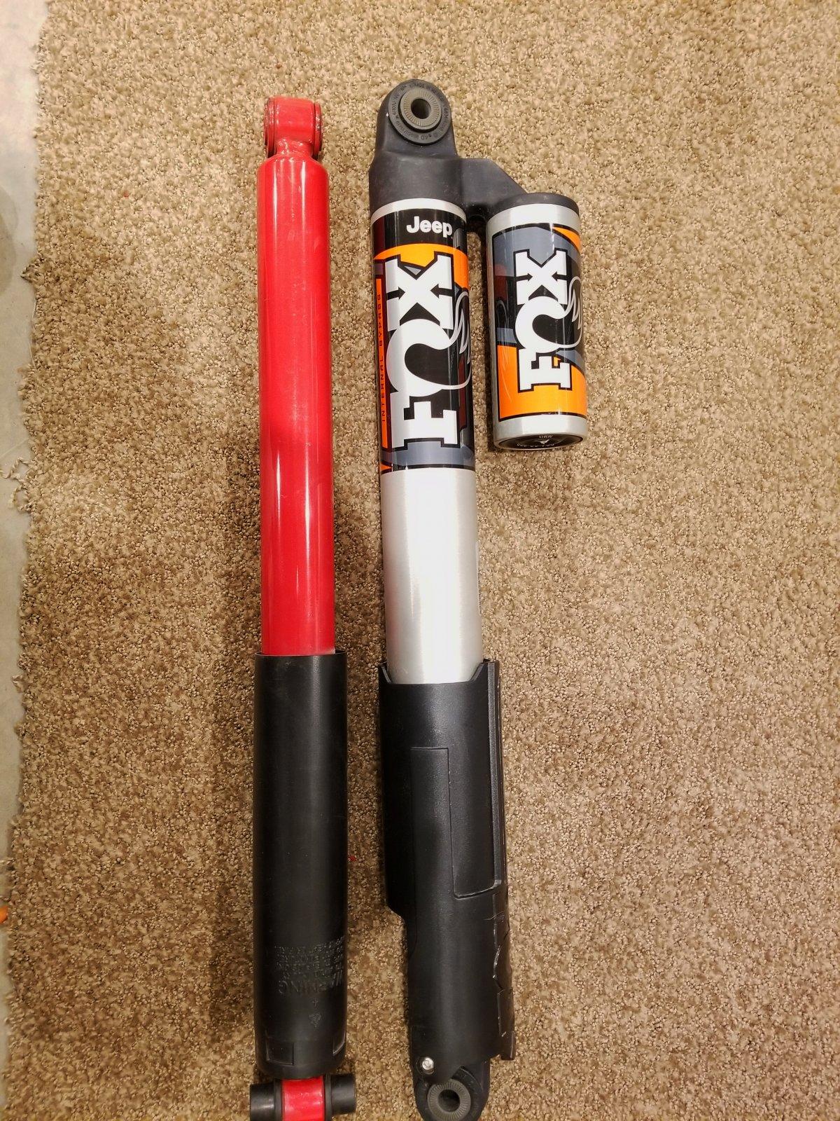

The non tech feel of just smashing them by hand, they are in-between the JT Rubicon Fox and the stock JL Red Rubi shocks. But, they have internal bypass that kick's in at the top and bottom of travel. They really firm up the last 2" or so of travel, both top and bottom, both compression and rebound.

It's crazy, I'm actually excited about these. I had Fox LSC's and other's, but these are just super cool.

I have a set of Fox JT Rubicon shocks for sale in MA in the classifieds if anyone is looking for a set.

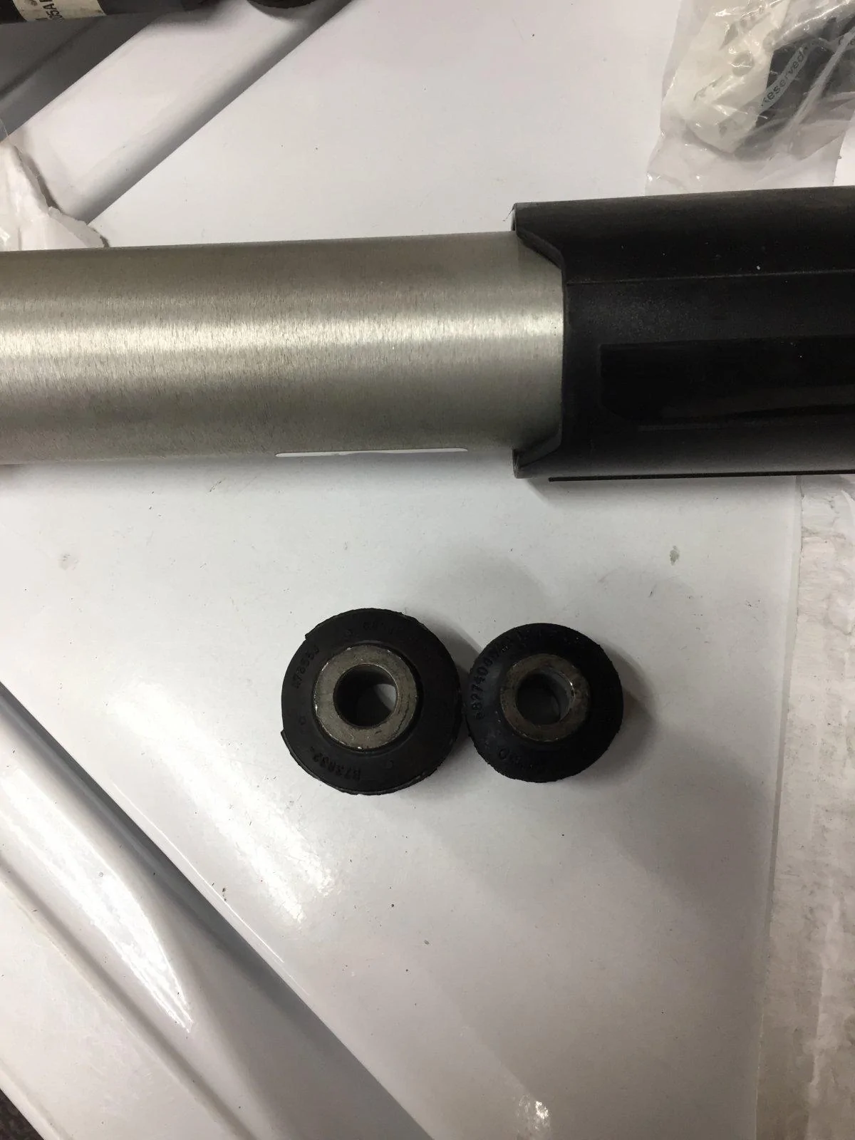

Easiest way to make rear JT Rubicon shocks work on JL is to order and install the JT Rubicon front bushings in them.
Top PN 68274895AA
Bottom PN 68274045AA
I ordered these and while the top is correct the bottom is not. The outer diameter is too small see picture below,
Hope this helps others, meanwhile i’m Looking for the correct one.

To further elaborate on this, the bushings have the same part # but are clearly different. I am Able to insert the bushing with my hands, it is not a press fit.
I went ahead and installed them and they are an improvement over the red Rubicon shocks. They are much less jarring over bumps. I am ordering M14 bolts and nuts for the bottom mount and will reinstall the original bushings.
Now I am in the market for another set for the other JL!
Gregj
You’re right, the bottom is push fit, and not press fit.
I installed them anyway, and it works fine.
Do you think I should remove it and use the proper bushing?

Idk, I ordered m14 bolts and nuts and will put the original bushing back in.

I think eventually they will get loose and end up with a klunk in the rear end.
Gregj
I'm thinking if we can order the JL Rubicon(or sport/Sahara) bottom bushings and install them on the JT Gladiator rear fox shocks.
