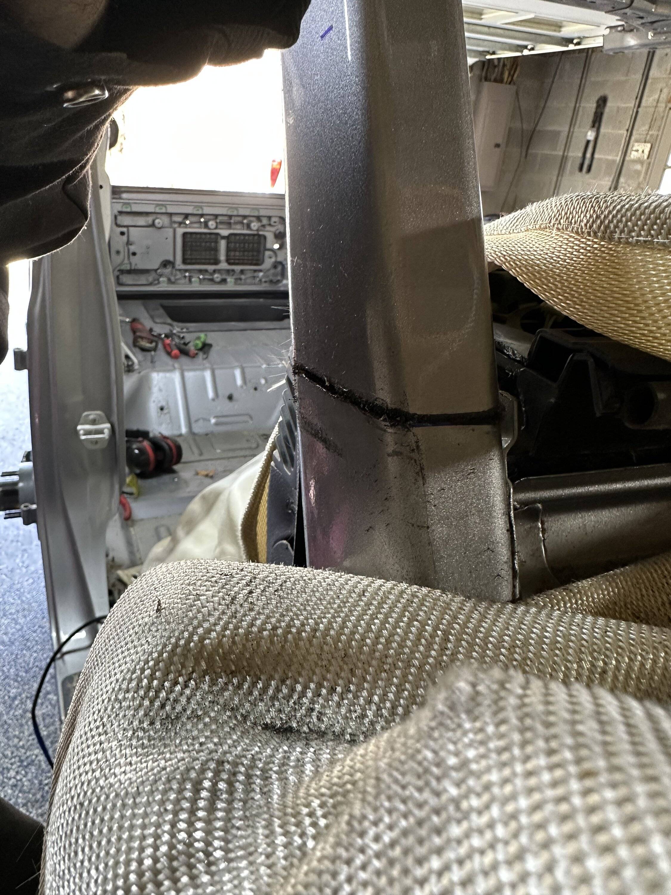

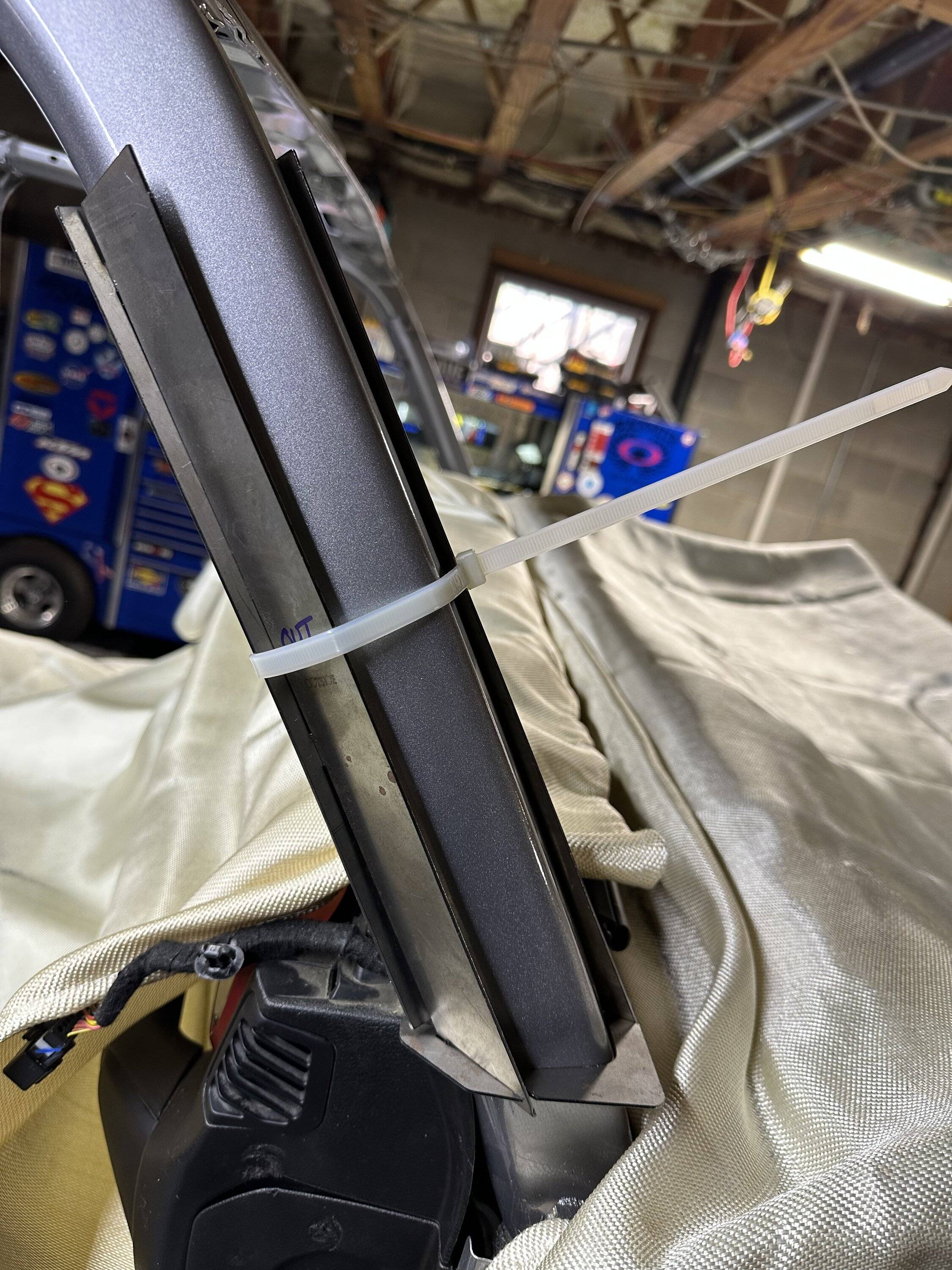

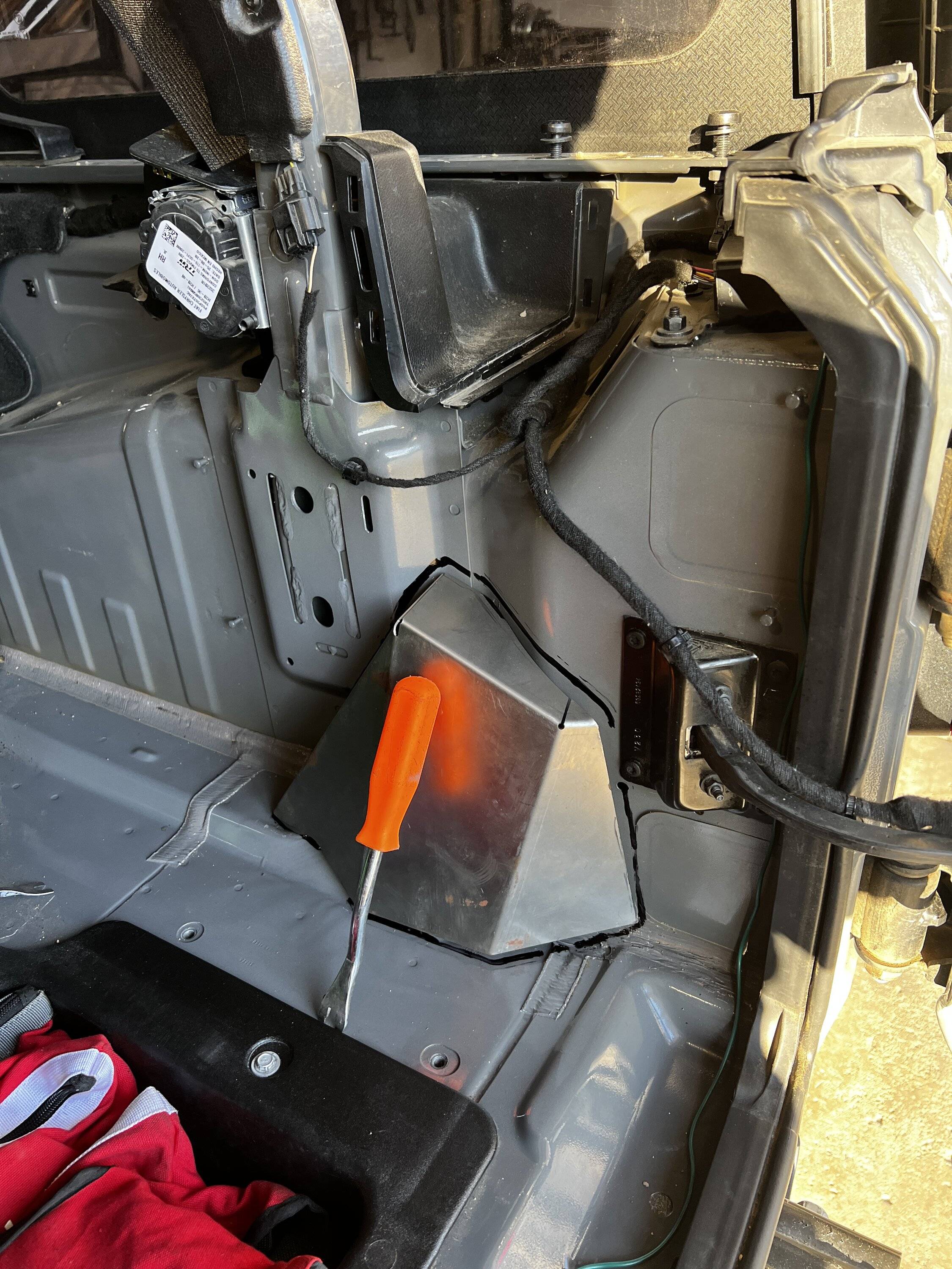

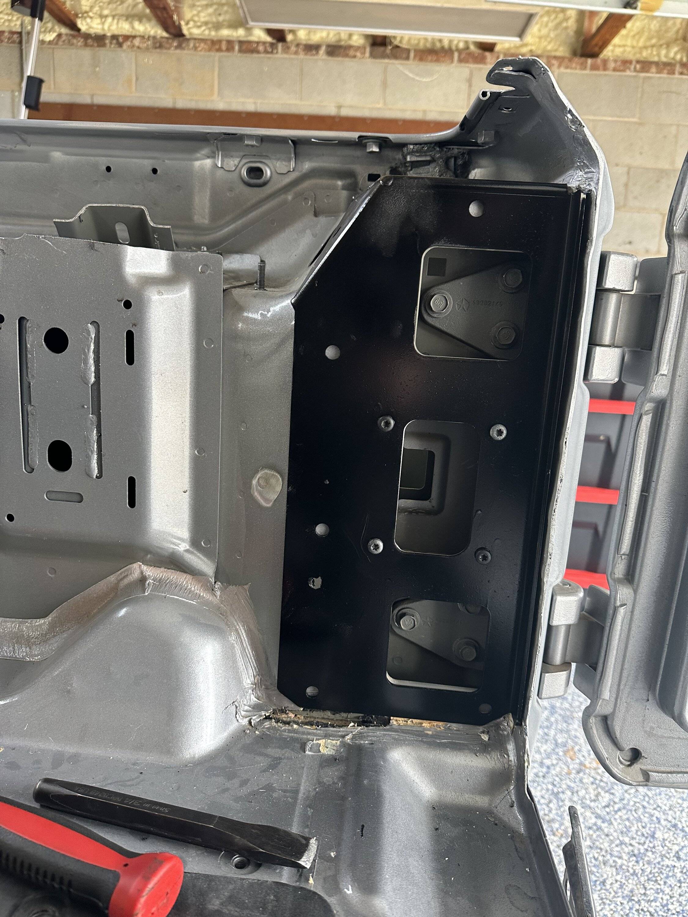

Yeah I’m working on the Motobilt rear towers at the moment to remount my coilovers, I’m curious to see how much modification those rear brackets under the d -pillar will need modified. Coming along nicely as well, i wonder how cleanly the b pillar comes apart from the top tube. You planning on Sawzall or angle grinder?

somehow missed your newest pics, can see you used the cut off wheel
When I had to drill the b pillar for my harness bar I realized how hard the structural steel was in that area and was surprised how many drill bits I went through haha

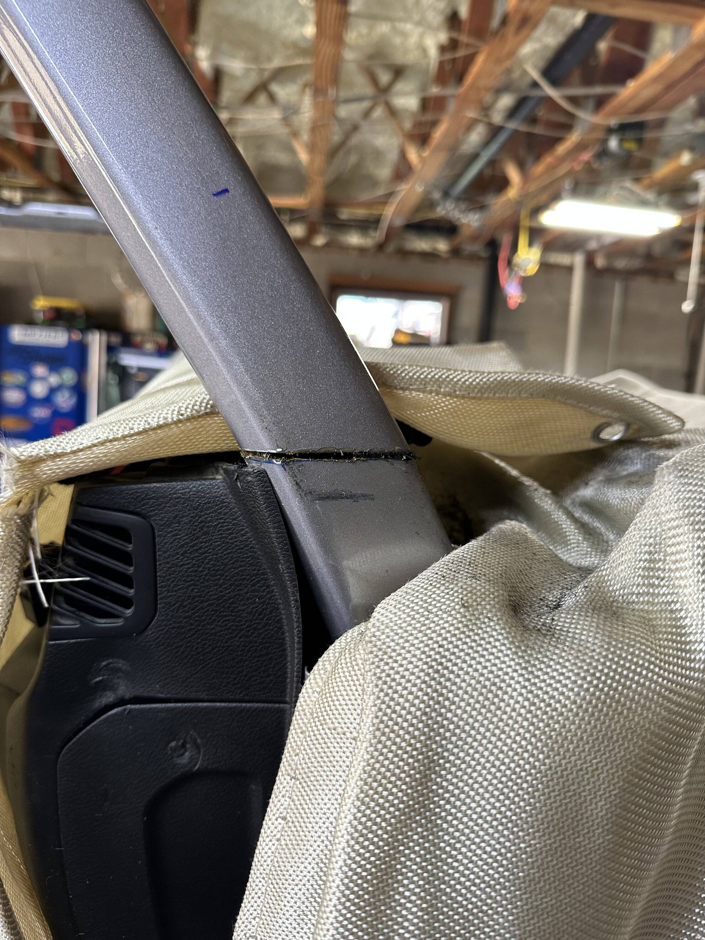

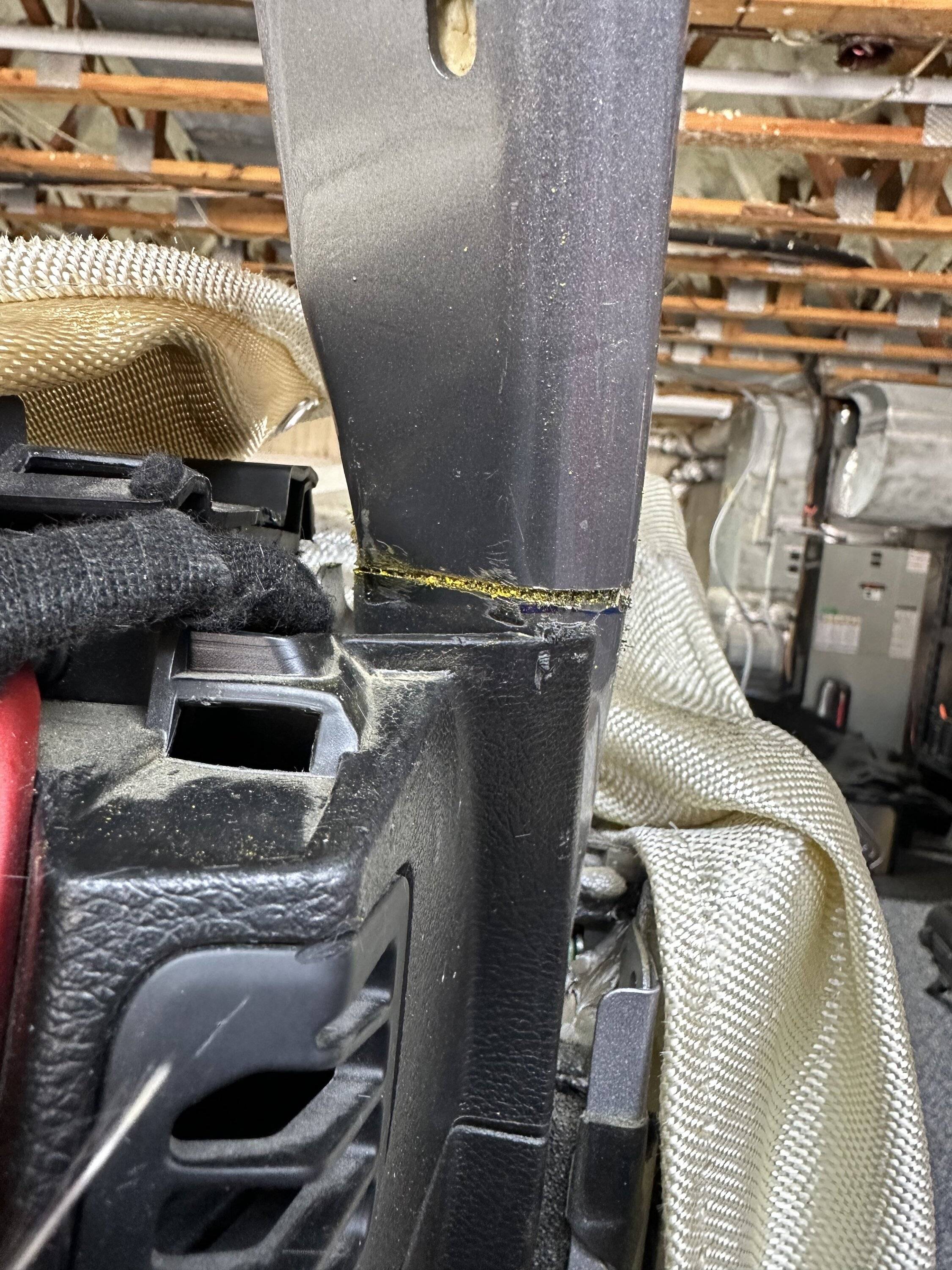

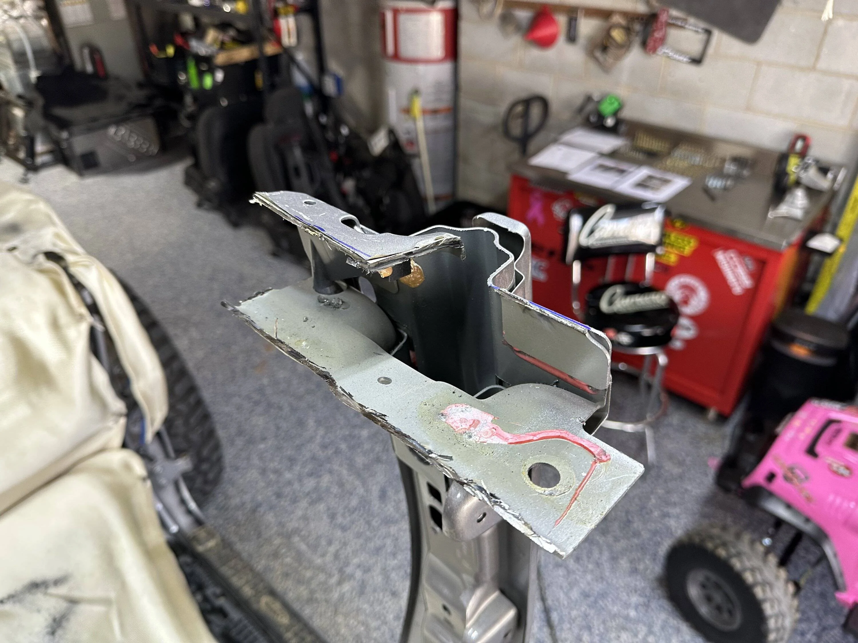

Edit

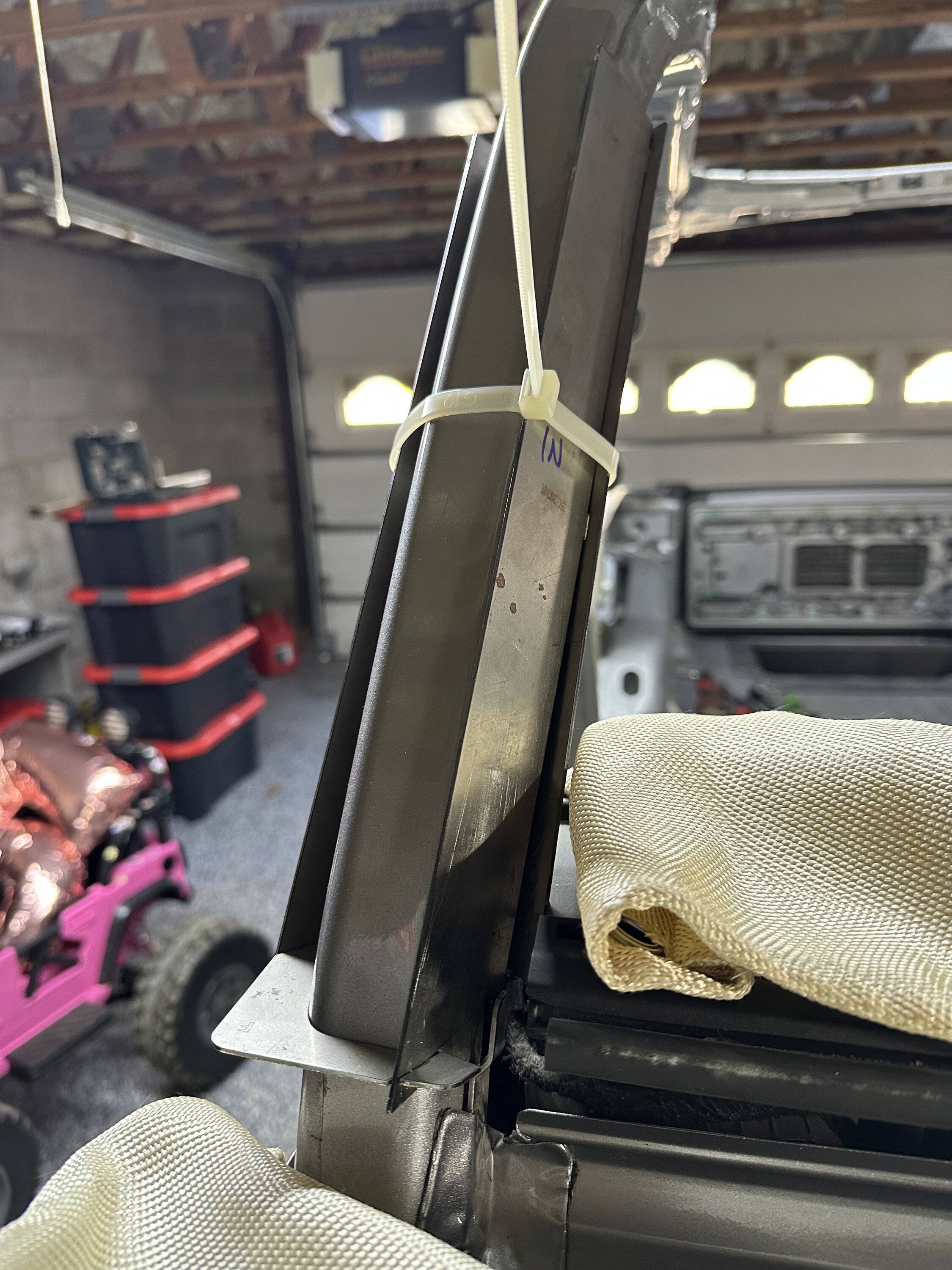

The D-Pillar is next. I'm cutting the A-Pillar now.
I'm using a standard 4 1/2 grinder with cutoff wheels. I needed the sawzall for the A-Pillar though. You can only get about 75% of the tube with the cutoff wheel.
I'll post the A-Pillar cuts next.
Oh yes... the factory cage is made out of a super hard alloy.
