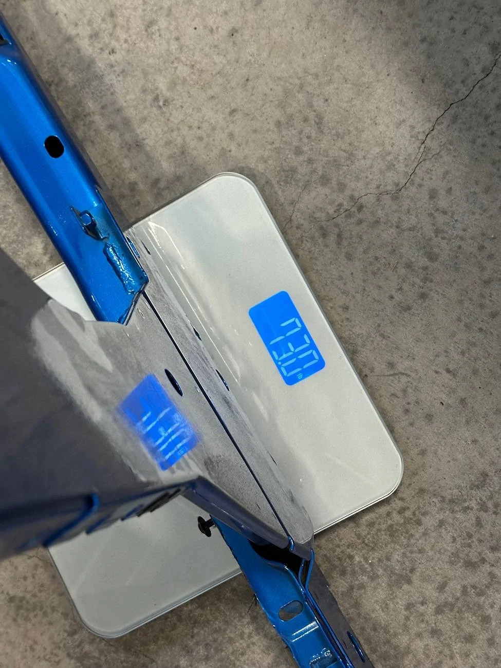

I cut my factory one out today. I was curious how much it weighed because the FedEx packages from Genright totaled up to 346 pounds (including the cardboard). Looks like we are adding 250+ pounds overall.

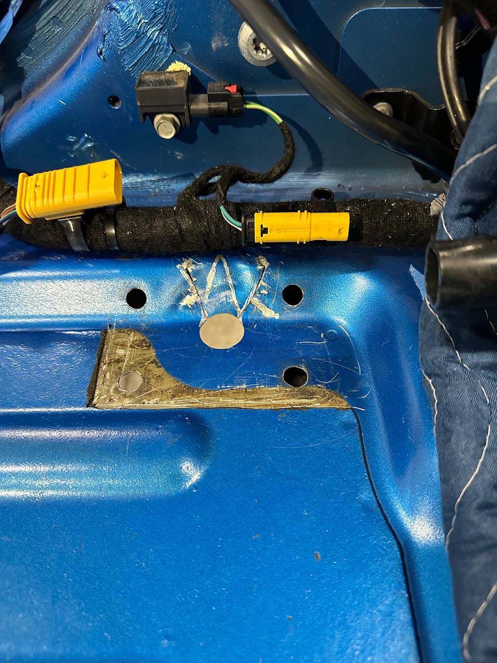

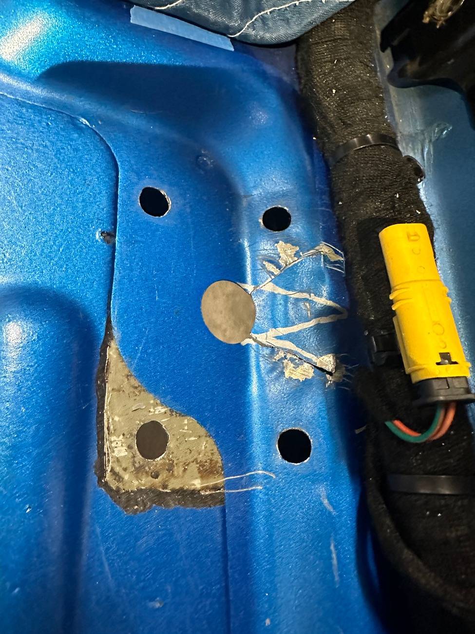

A couple more pics to compliment all of Shawn’s above. This is the floor after the needed changes are made. You can see the inner triangle gray line - this is where Genright tells you to cut. That didn’t make sense to me because they call them “relief cuts”, but that would remove the whole triangle. In Shawn’s video, he drew the lines where I cut mine. After the floor is formed to match the brackets, the sheetmetal basically touches itself in both cuts.

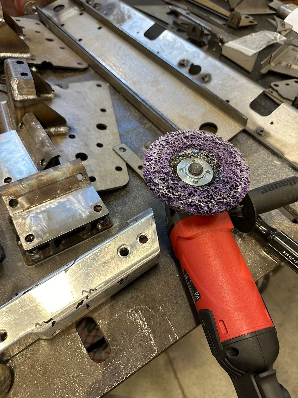

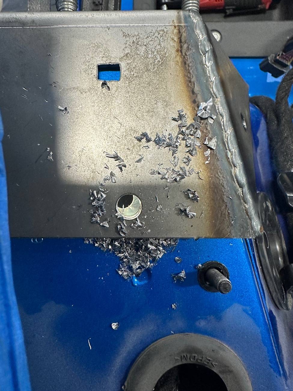

A couple notes from today, I used this grinding wheel (I think they are used more for paint removal?). It removes plenty of aluminum at a time, but less than a flap wheel - so you don’t take off too much at once.

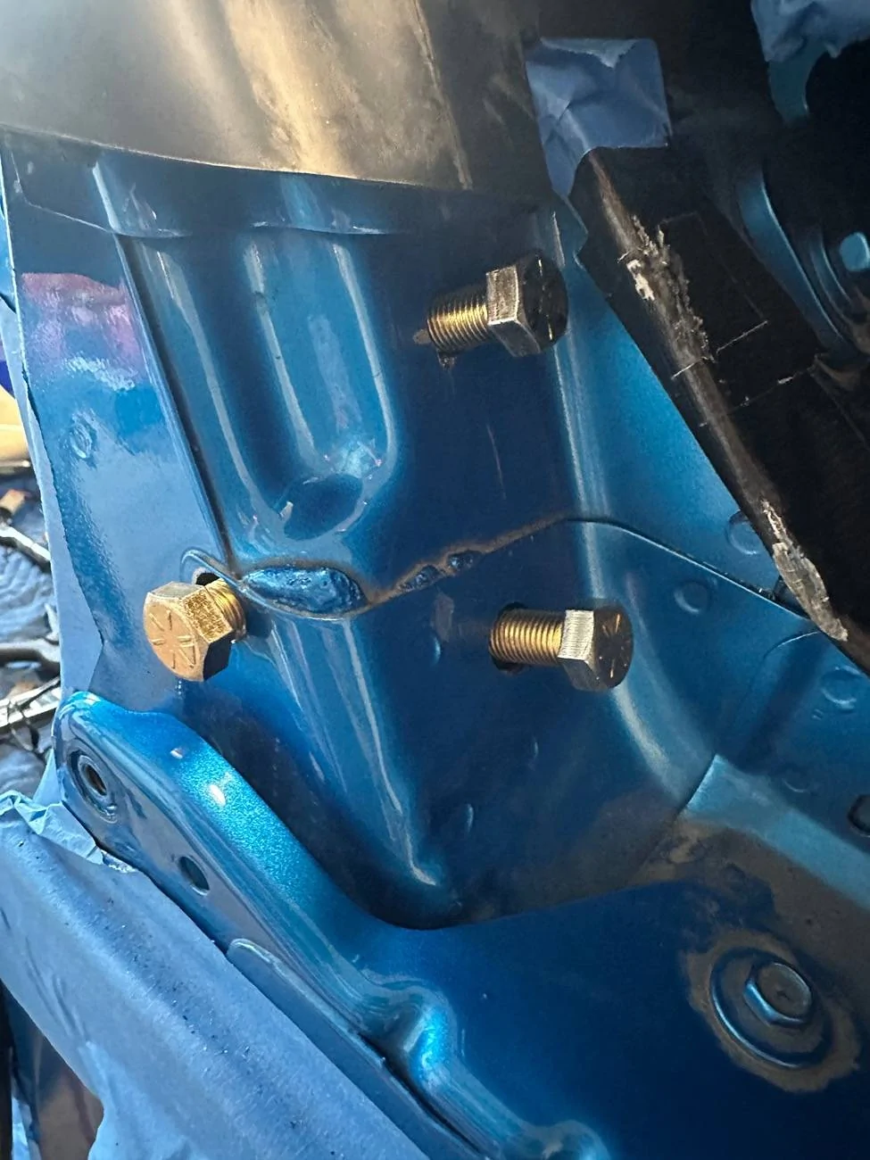

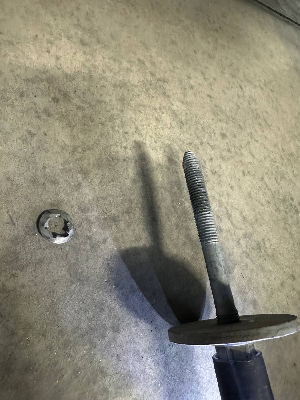

A few of the body bolts didn’t want to come out completely. Once I jacked up the body, I found these clips holding them in. Grabbing them with a needle nose while turning the bolt, they came right out.

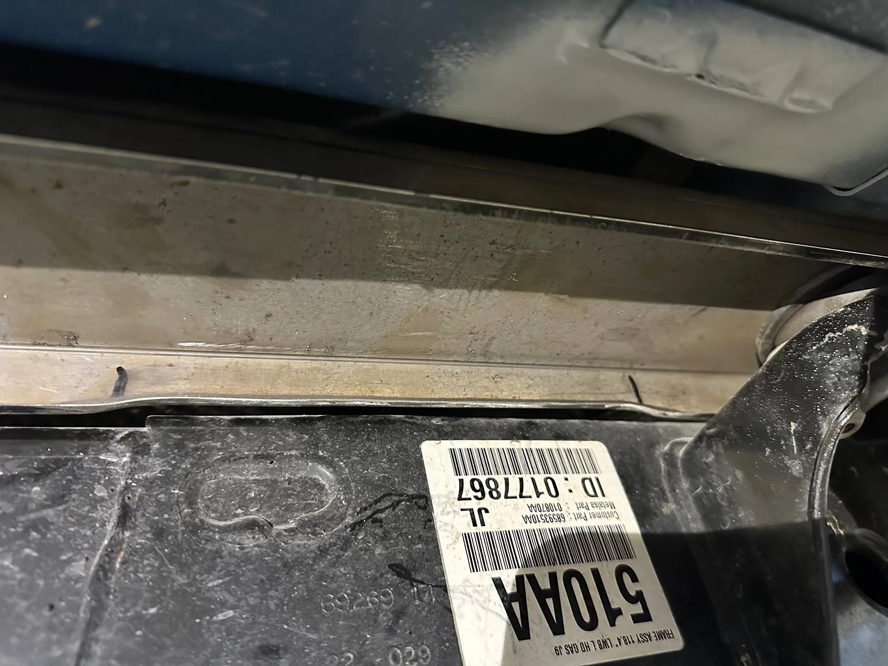

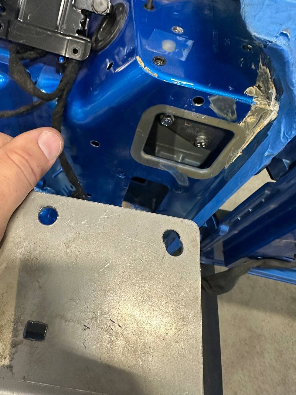

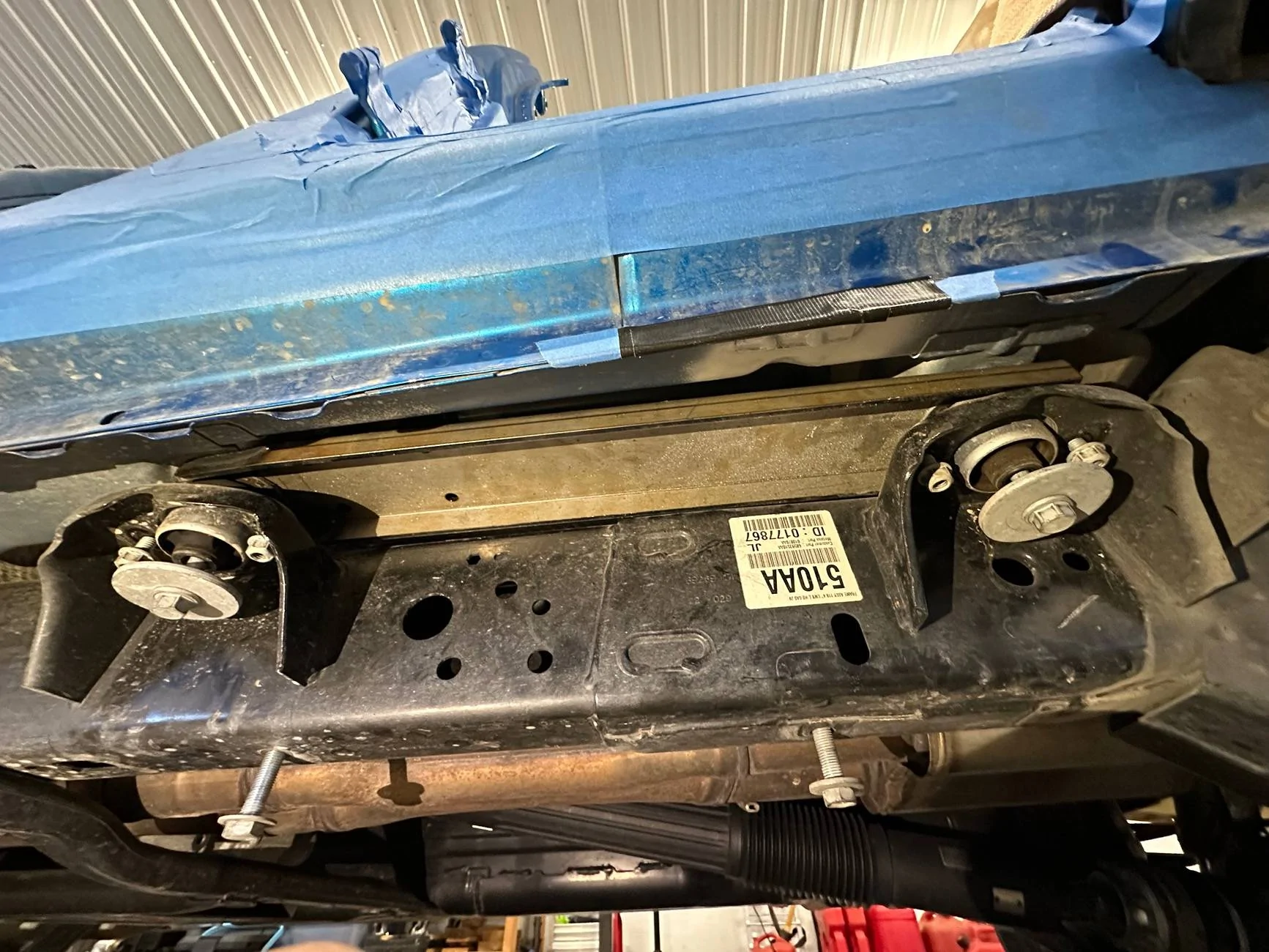

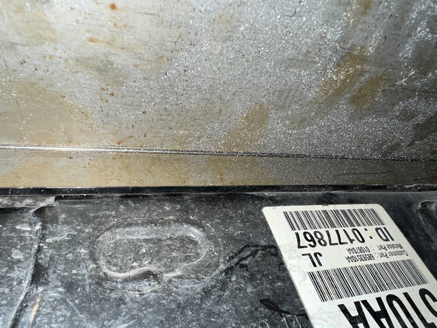

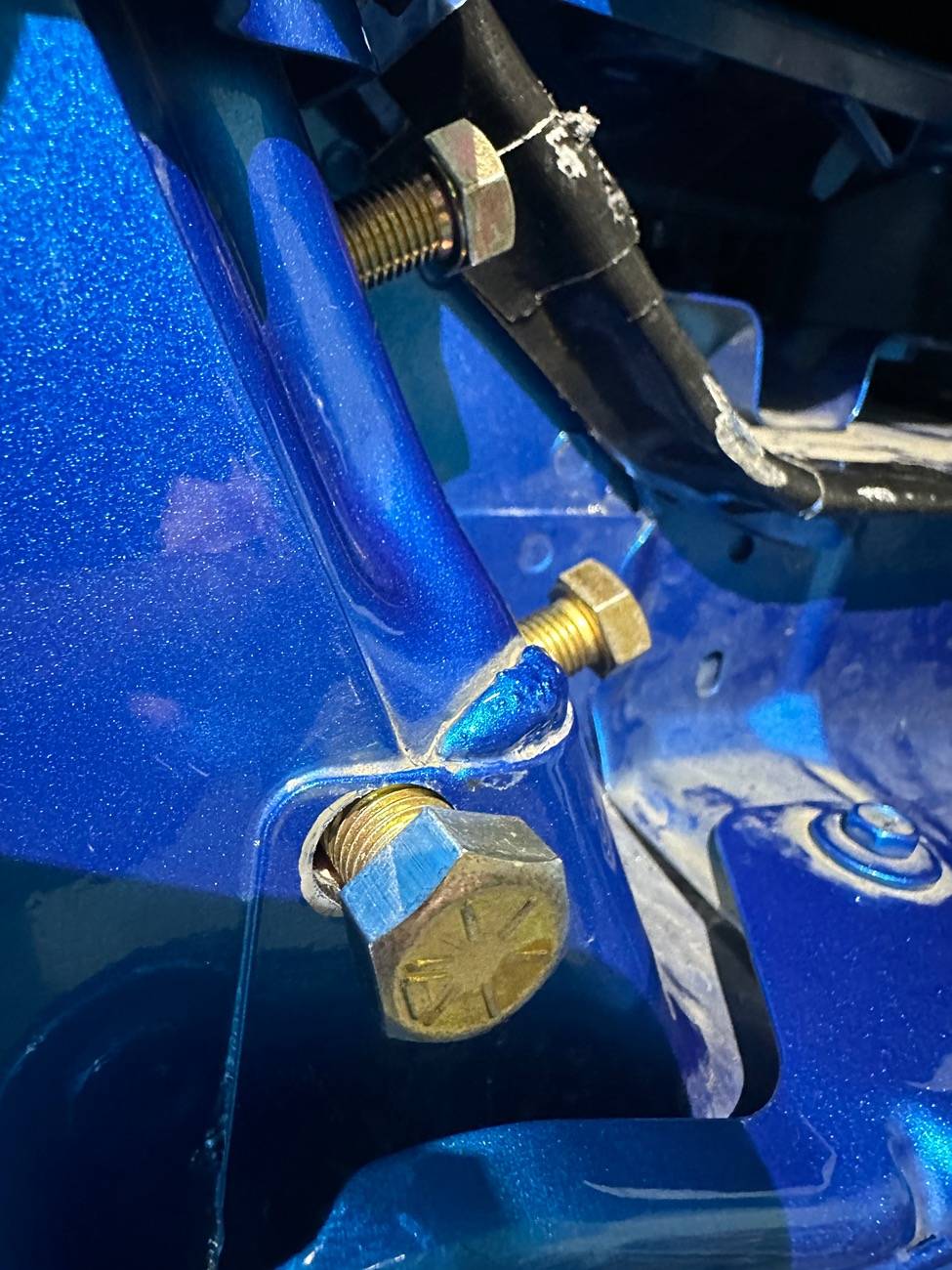

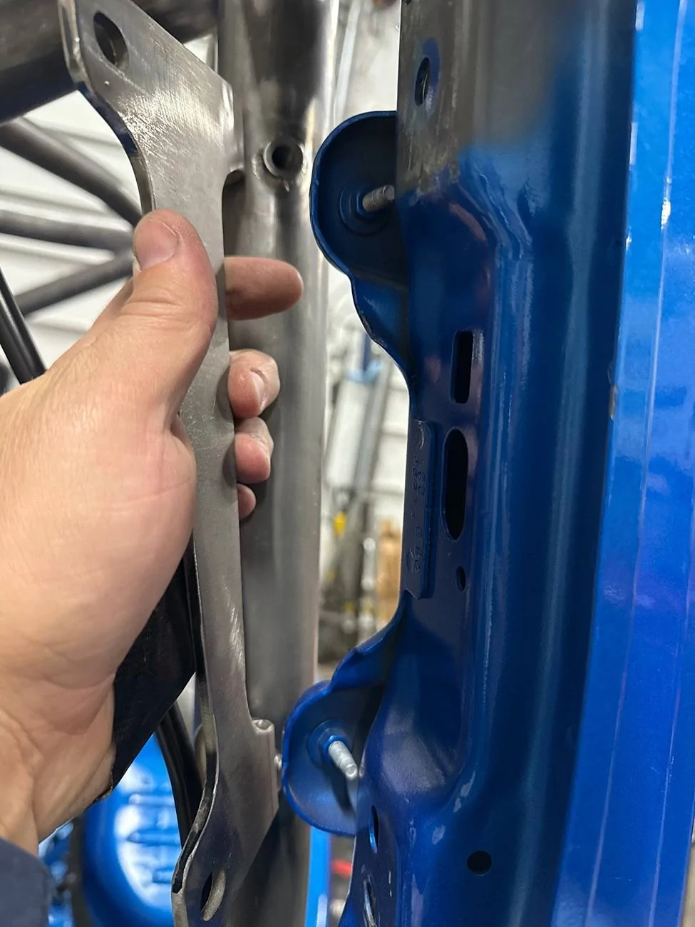

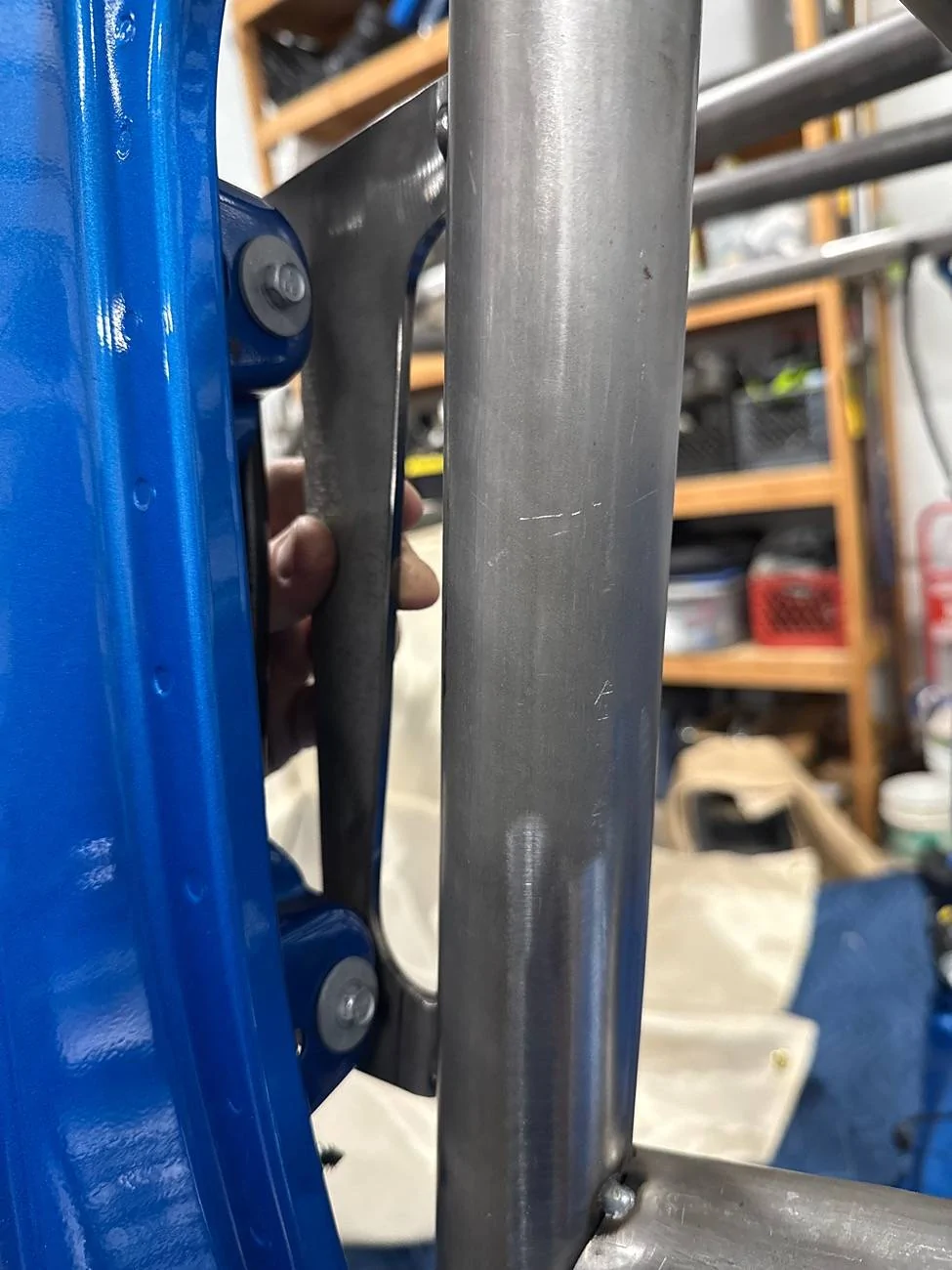

The driver side B pillar support plate was way to close to the frame for my comfort, like 1/16”. Once the Jeep is put back together and loaded, I’d imagine it would easily contact it and cause squeaks and/or vibrations. It‘s been a tedious process test-fitting everything before paint and final install and I almost didn’t with these supports. I’m so glad I did. Shaving an 1/8” to 3/16” off this section gave it the clearance it needed. The passenger side was fine.

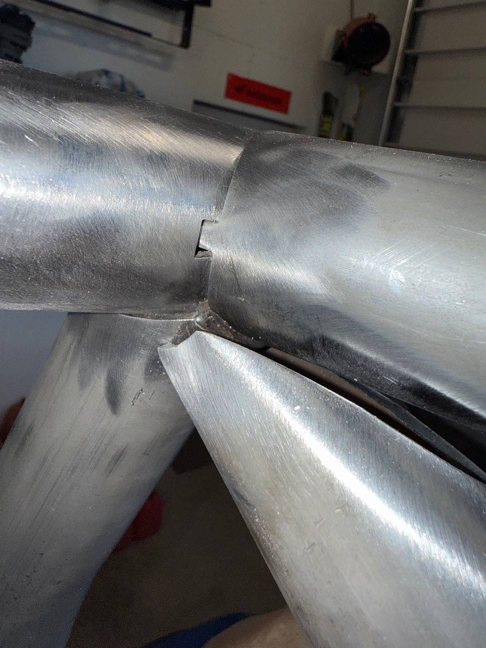

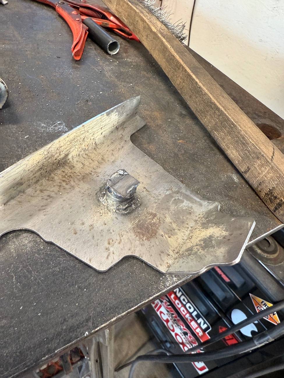

Genright’s instructions are excellent, but they failed on a couple points I noticed today. They don’t tell you to weld the joints that get covered by the X bars. I called them to confirm, and they stated I should weld there first. You can see here where I did on the C pillar joints. I stopped short of them interfering with the fitment of the X bars.

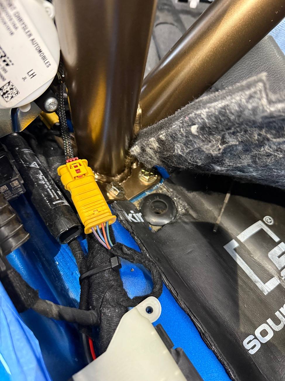

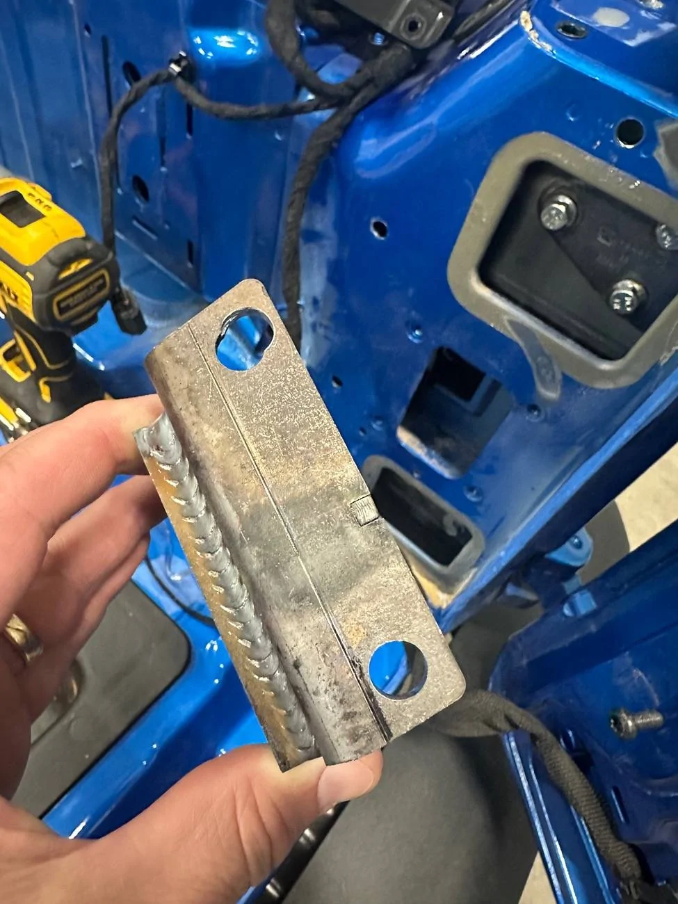

I also realized they don’t tell you how to deal with the upper B pillar support brackets, they completely missed it in the booklet. I’ll have to cut off the portion where the factor grab handle bolted to in order to fit everything in. This picture is in the B pillar chop kit supplement, but even it doesn’t address it.

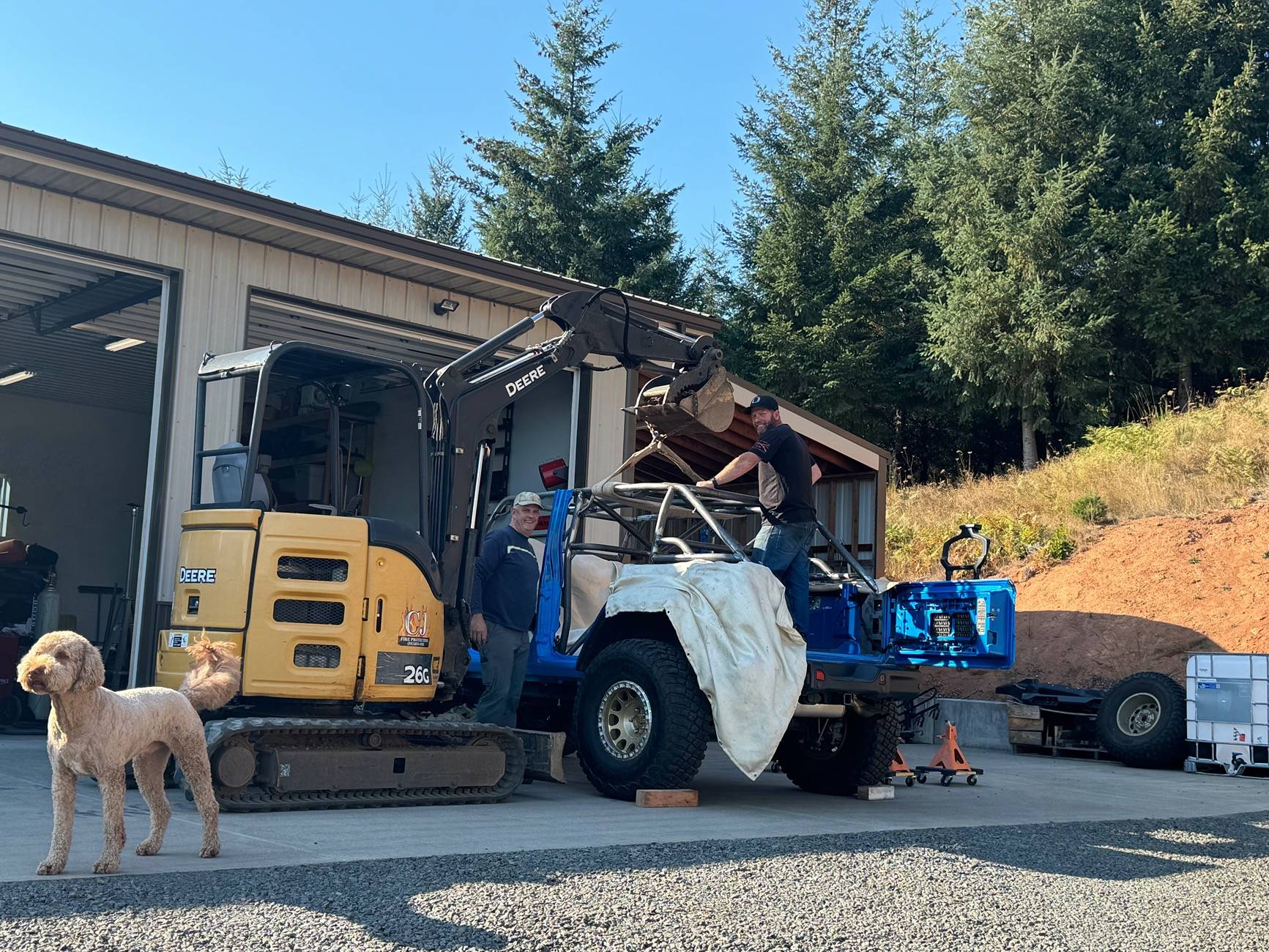

My buddy that was with me in my last jeep when I rolled it is also a welder, I had him weld it up this weekend. In case you don’t have 6 friends handy to help you lift out the cage like Shawn does (I do have 6 friends, but I live 30 minutes from town), a mini excavator works great 😉

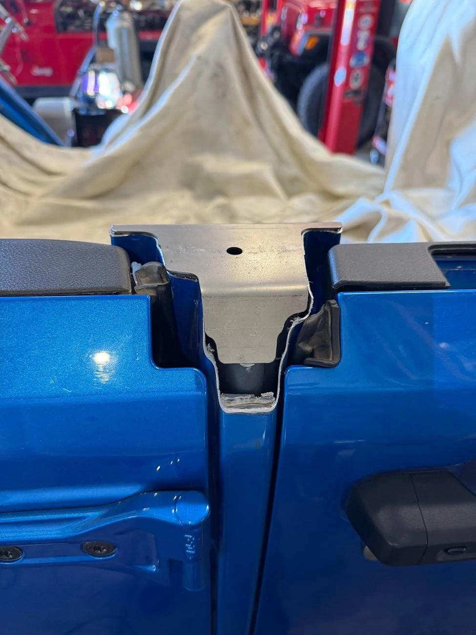

Couple notes after I started into the B pillar chop. Unfortunately, the Genright caps for the chop are only meant to match their half doors. As you can see here, they are too short for a chop that matches the factory half doors. I’m planning to fill the gaps with pieces from the A pillar cut template that came with the kit. This photo makes it look like I cut too low below the body line, but matches up.

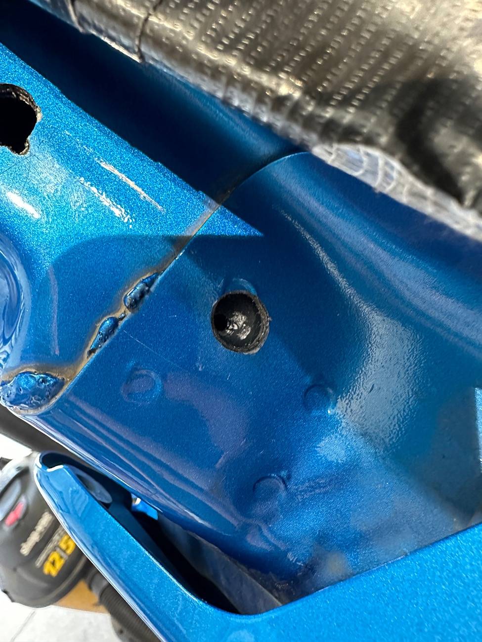

I didn’t like the idea of the lower cap just being an open hole for sand, dirt, mud, water, etc to just funnel into the B pillar cavity. I ended up “capping“ the hole with random scraps of metal. If I ever change my mind later, I could just drill it out. (When you see these welds, you’ll understand why my buddy did the cage 😂)

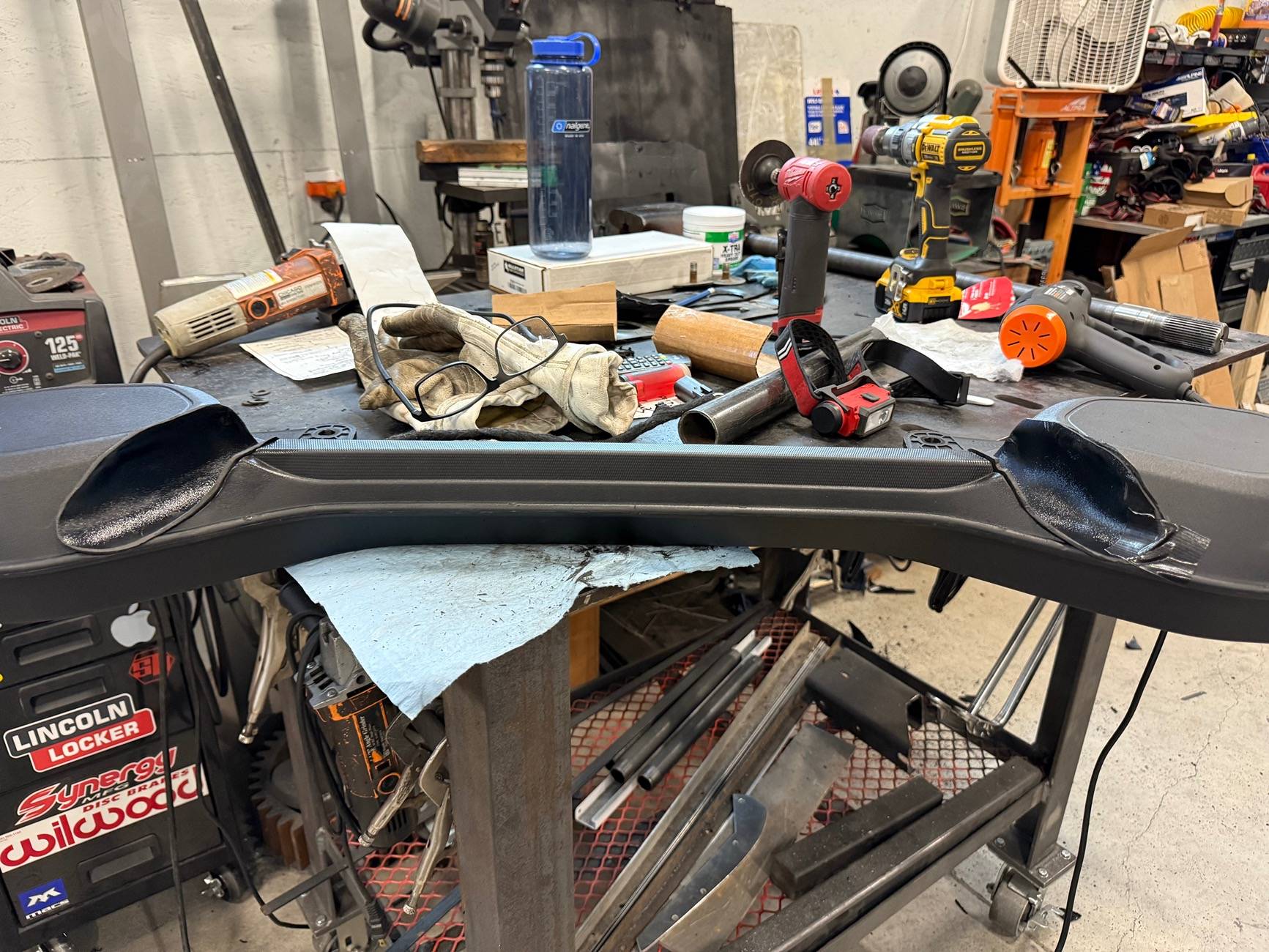

I called Genright to ask them what the included sticker template was for and learned they have supplemental instructions for the plastic trimming above the windshield. They are as detailed as the main instructions and should save me a bunch of time. Make sure you get this if you order the kit.

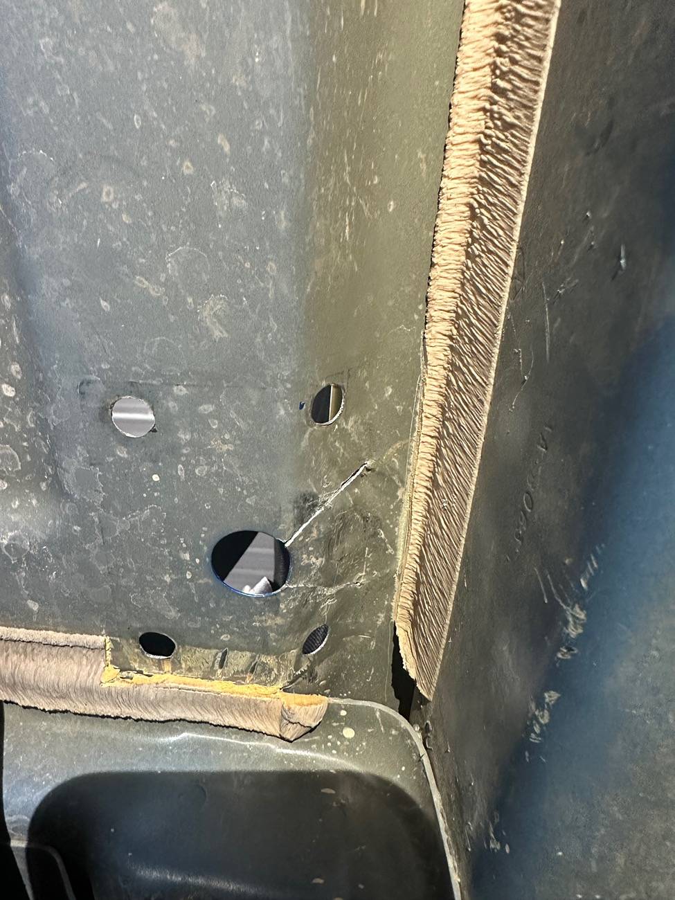

Life has been full of interruptions, so I’m still not fully done with this. I have ran into a couple more tidbits I thought I’d pass on.

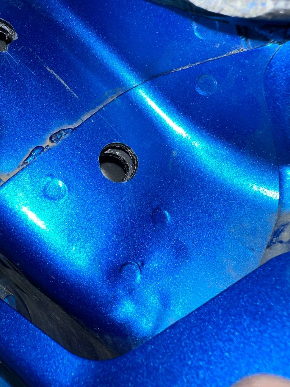

Here is where I relocated the drain tube holes to. Just behind the B pillar landing plates, they will still be hidden behind the plastic trim (when I can get that dialed in).

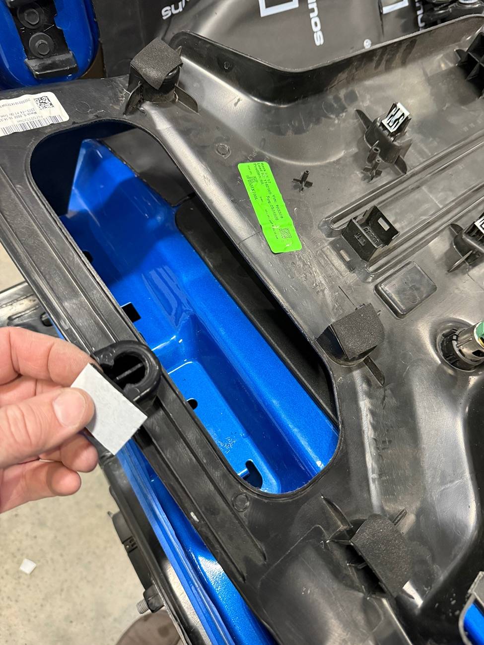

On the rear trunk area side panels, you lose several mounting tab points. I think the floor panels will lock them in okay, but I was worried about rattles or rubbing. I attached foam to the face of all of them to combat that.

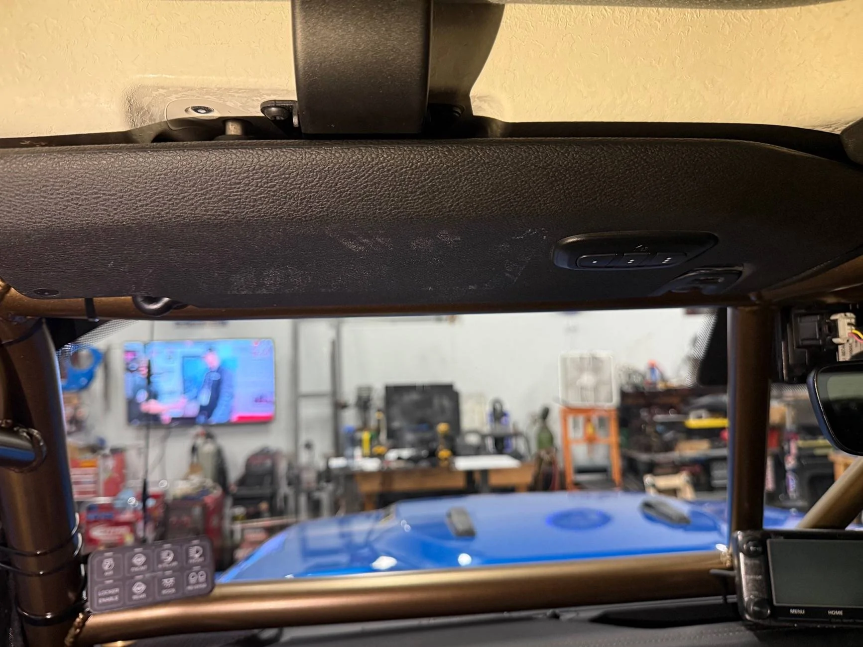

Finally got the jeep driveable a couple weeks ago, but I still have most of the interior plastic and wiring to complete. It’s taking hours upon hours. If you are detail oriented and anal like myself, it is a SLOW process. For instance, it took me 3 hours this morning just to get the front header panel wiring cleaned up (all the factory clips removed, felt tape added, etc) and installed (Had to move windshield forward, etc.) I have the sun visors on and the plastic above the driver’s visor trimmed and installed. As you can see in the pics, the visor is above the bottom of the roll bar, so it doesn’t limit visibility at all.

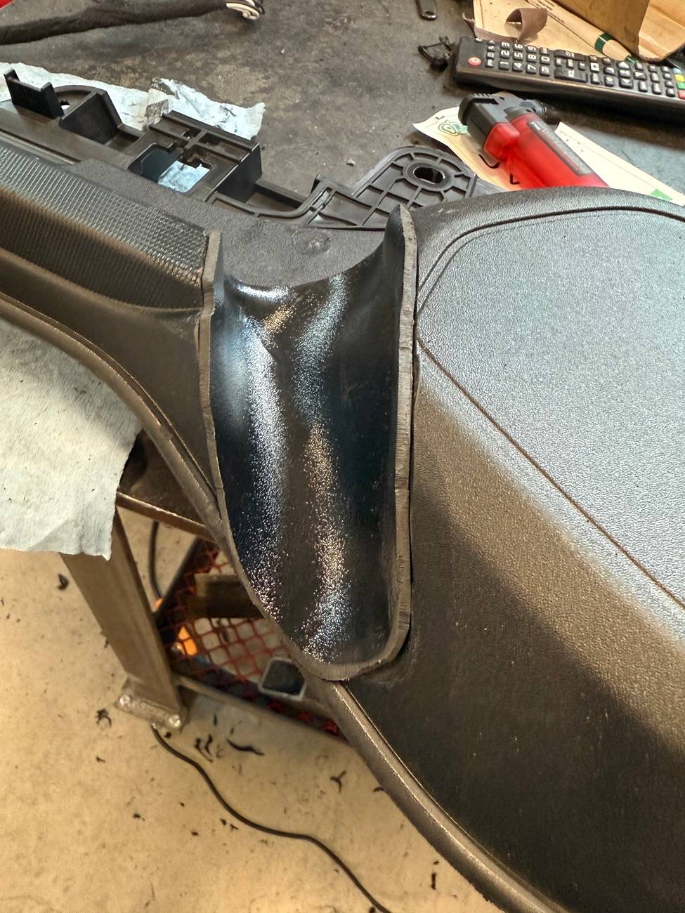

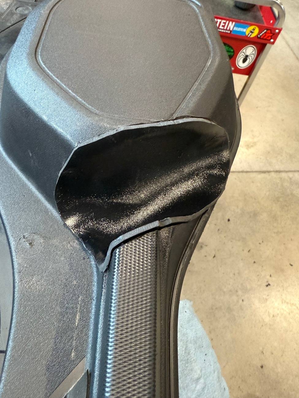

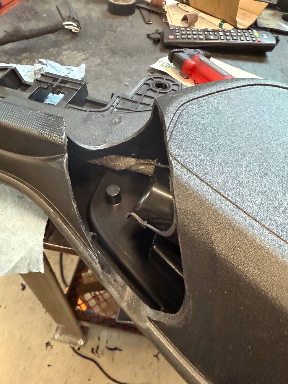

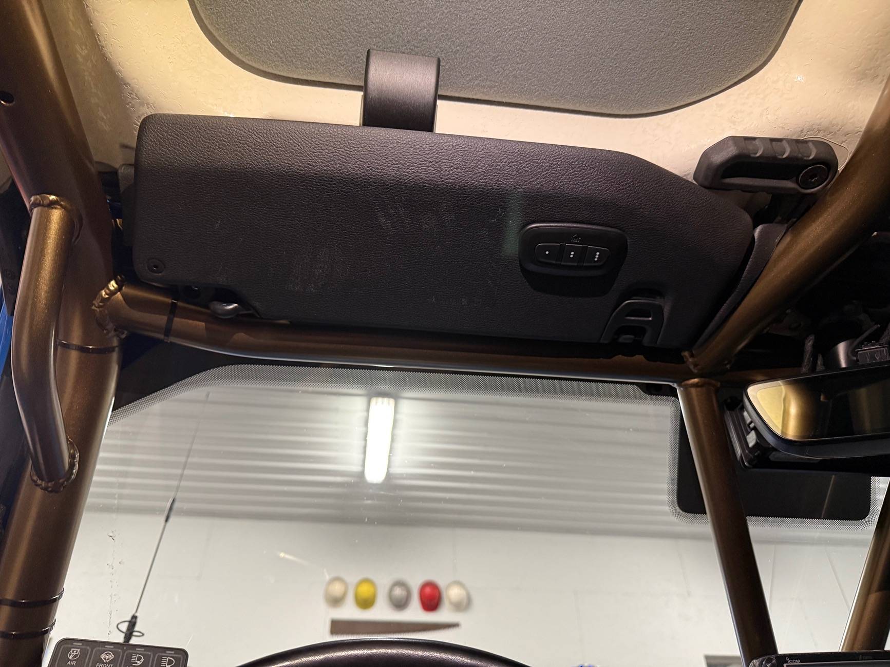

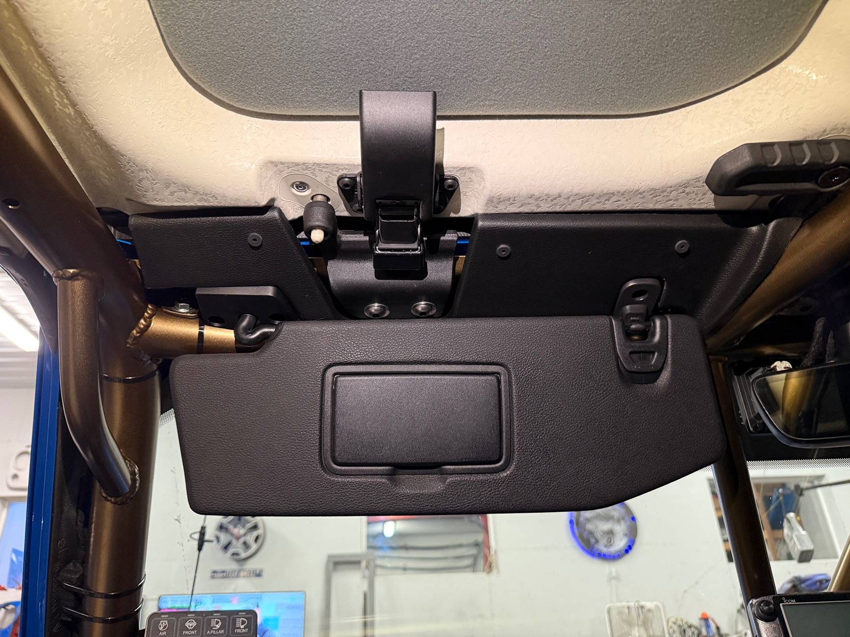

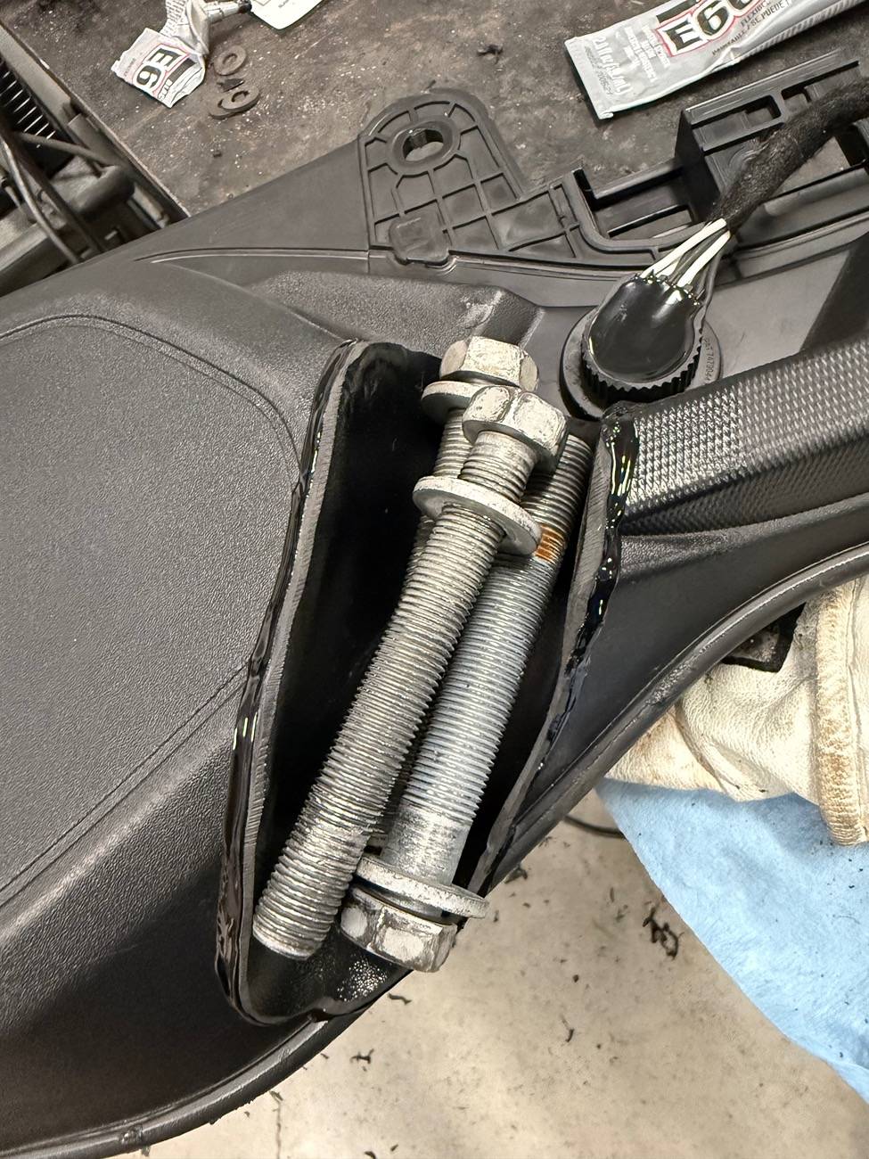

Just now getting back to the soundbar fitment today. I planned to plastic weld these plastic/kydex “caps” in place, but the 2 types of plastic didn’t want to stick together. I will clean the edges up a bit more once the glue (E6000) cures. This detail work takes an INSANE amount of time.
Jeep Wrangler JL GenRight Roll Cage Install IMG_4527
Jeep Wrangler JL GenRight Roll Cage Install IMG_4524
Jeep Wrangler JL GenRight Roll Cage Install IMG_4525
Jeep Wrangler JL GenRight Roll Cage Install IMG_4531
Jeep Wrangler JL GenRight Roll Cage Install IMG_4529
lashlee
Sep 23, 2021
789
556
Knoxville, TN
'18 JLUR 2.0 Turbo 4 (Sold), Tesla M3P
If the e6000 fails (I don't expect it to, it's quite good for that type of situation) you could try some 3m 4240 plastic adhesive. Expensive it you need to but the specific gun as well as the tube itself, but will typically bond any two plastics without issue.
