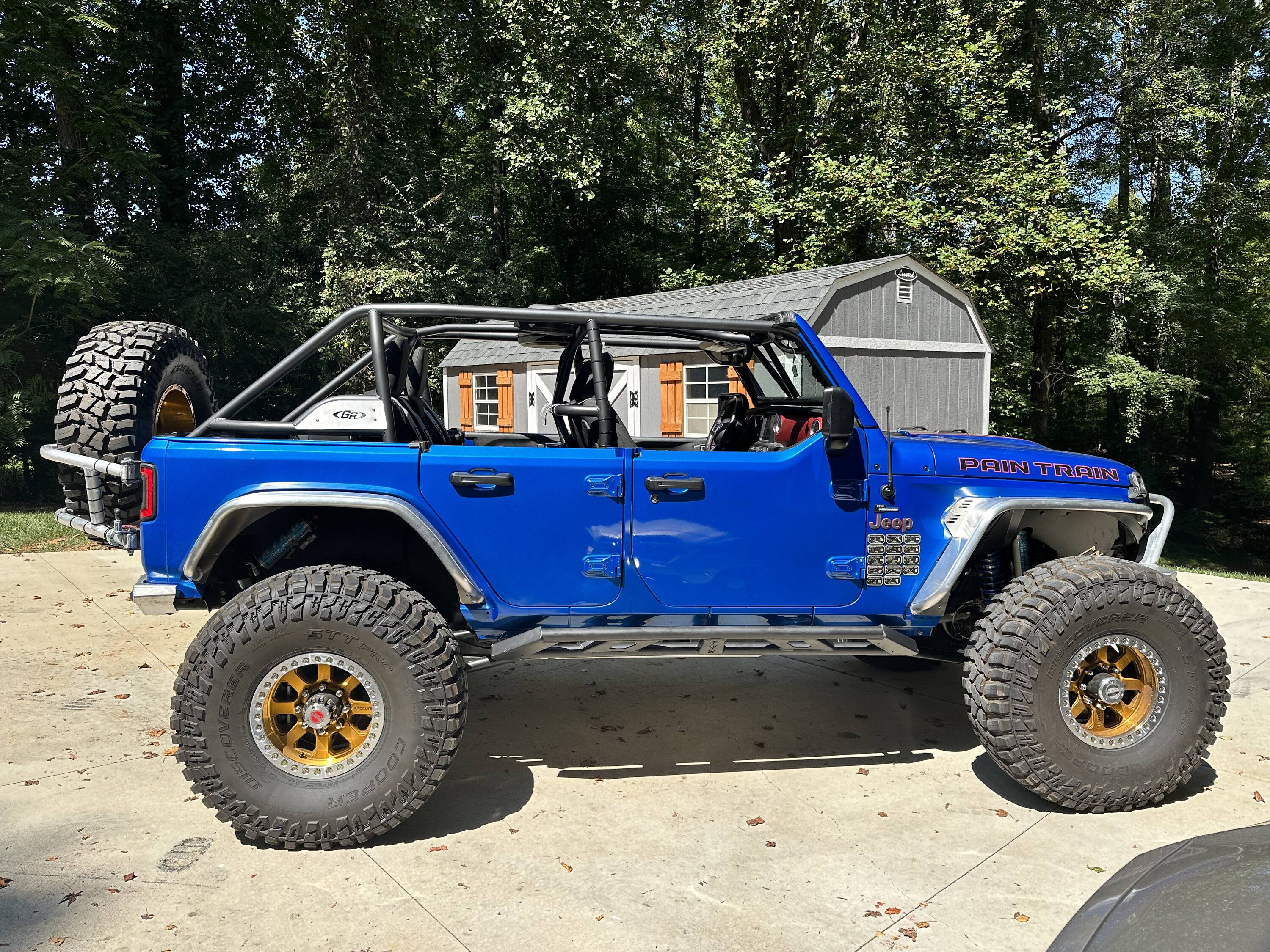

Latest pic showing the cage. Once I get around to the freedom tops, I'll post some more here. Otherwise, it's completely finished now. (I've placed this picture in a few different spots on here.)
Jeep Wrangler JL GenRight Roll Cage Install IMG_0193
Looks great brother ……

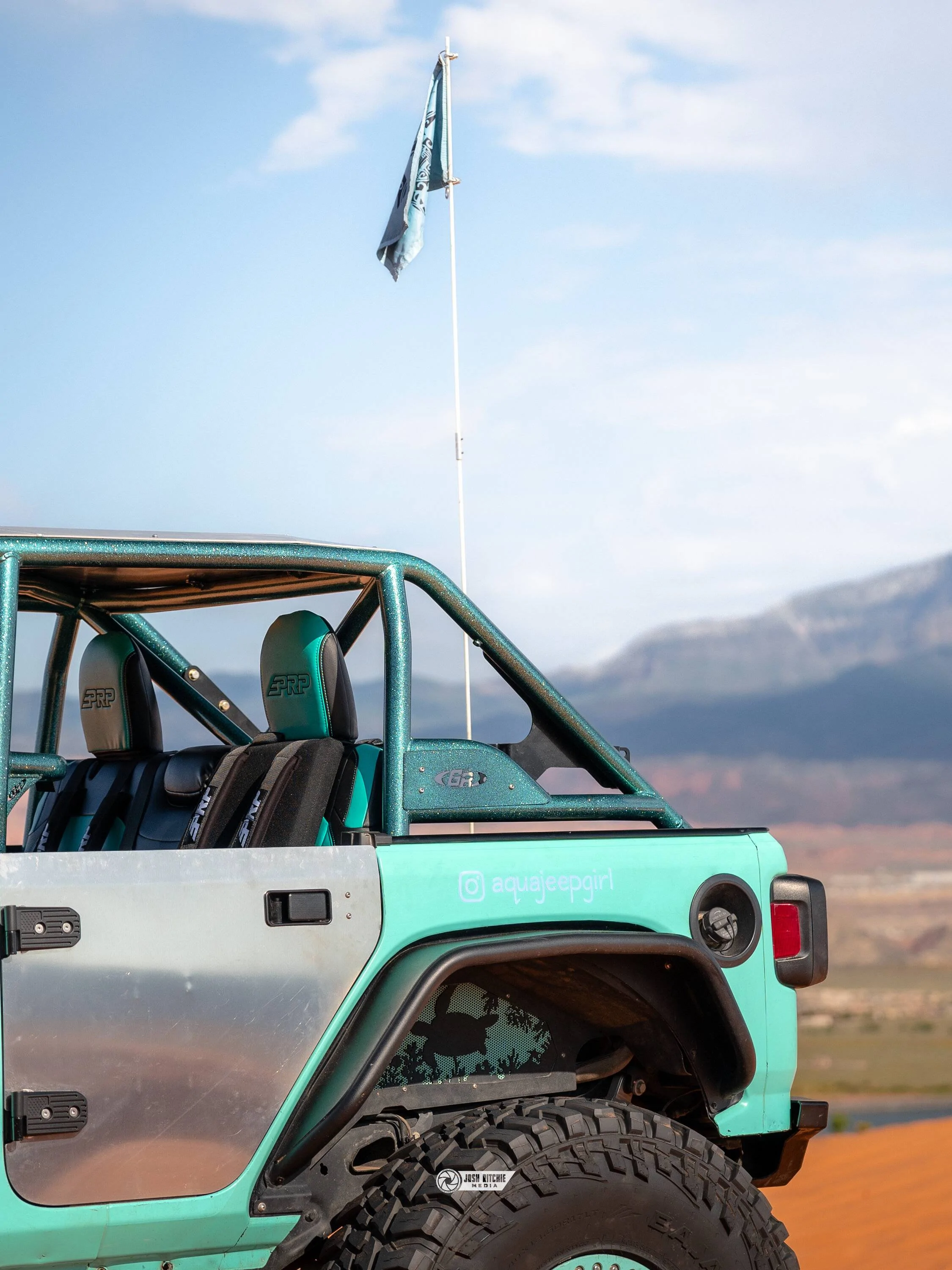

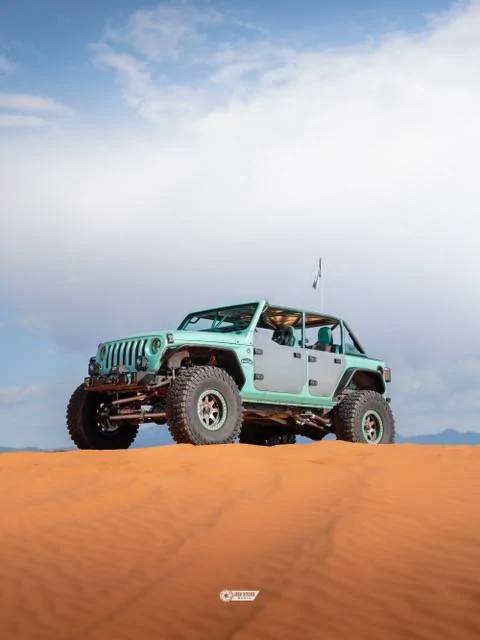

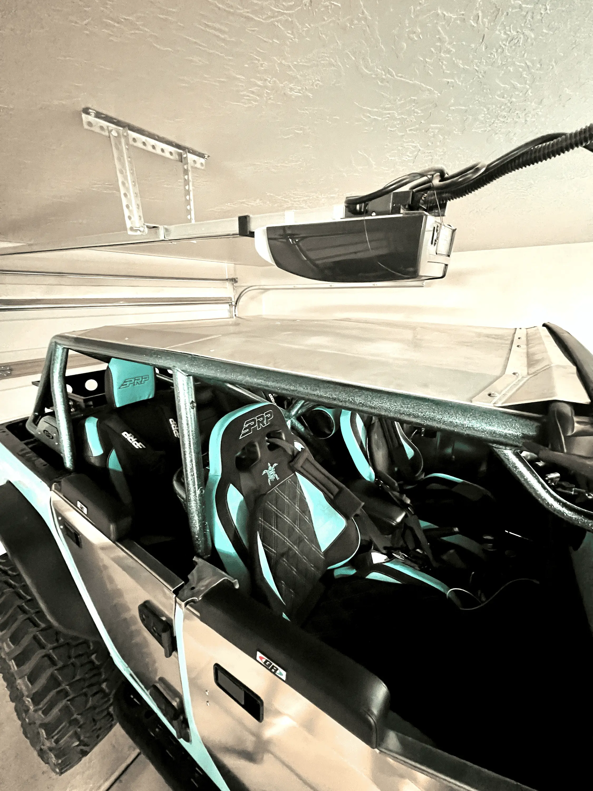

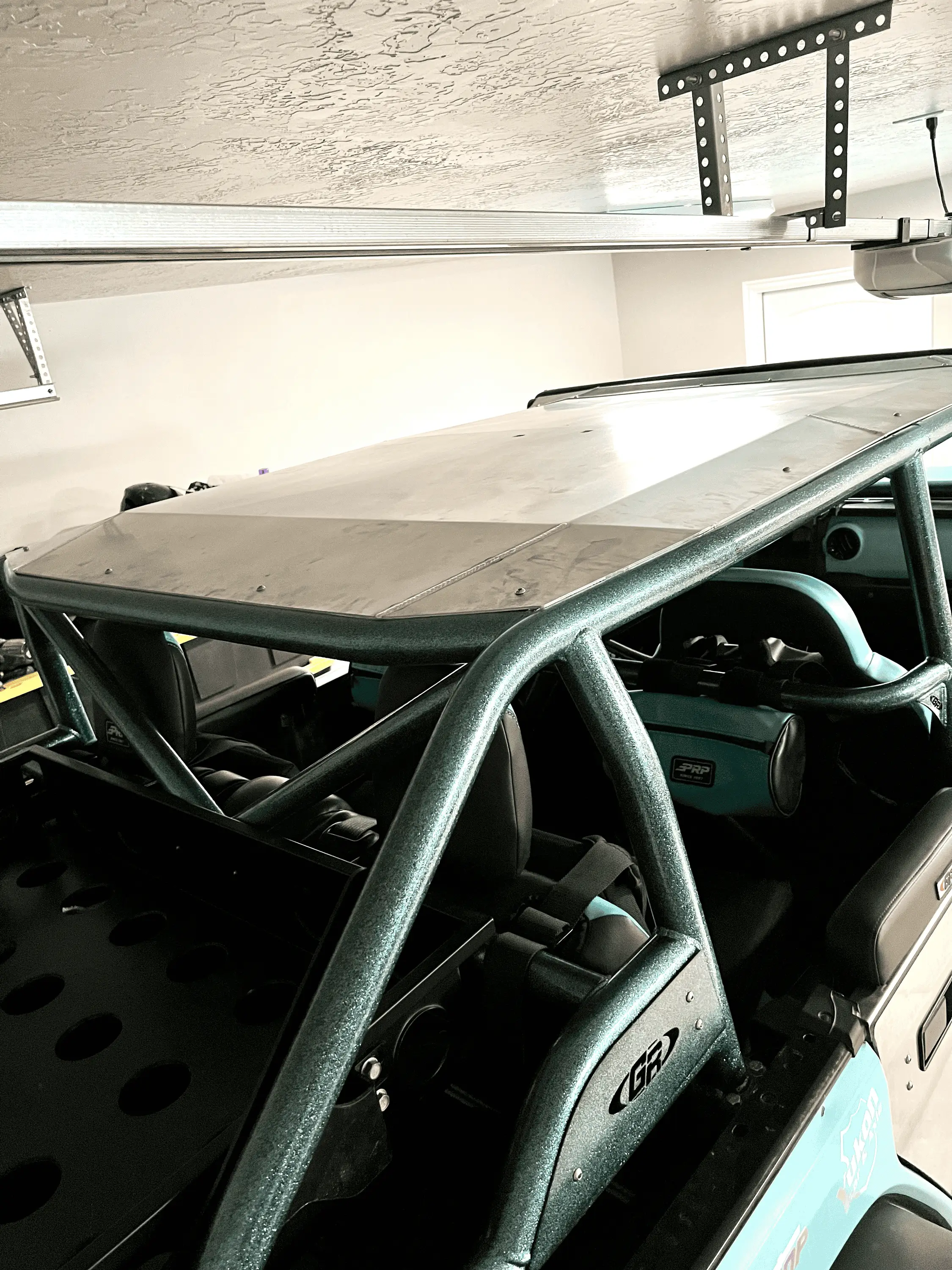

That looks great!! I am so impressed you did all of that yourself!! It's quite a project!! I just got mine back and am loving it! It's such a well engineered cage!! I added the aluminum roof and half doors with the B-Pilar chop. It looks so good!! Here's mine:
Jeep Wrangler JL GenRight Roll Cage Install lr_file-670
Jeep Wrangler JL GenRight Roll Cage Install smaller fil
That's awesome you got it finished up! Looks fantastic. Very sparkly. Lol

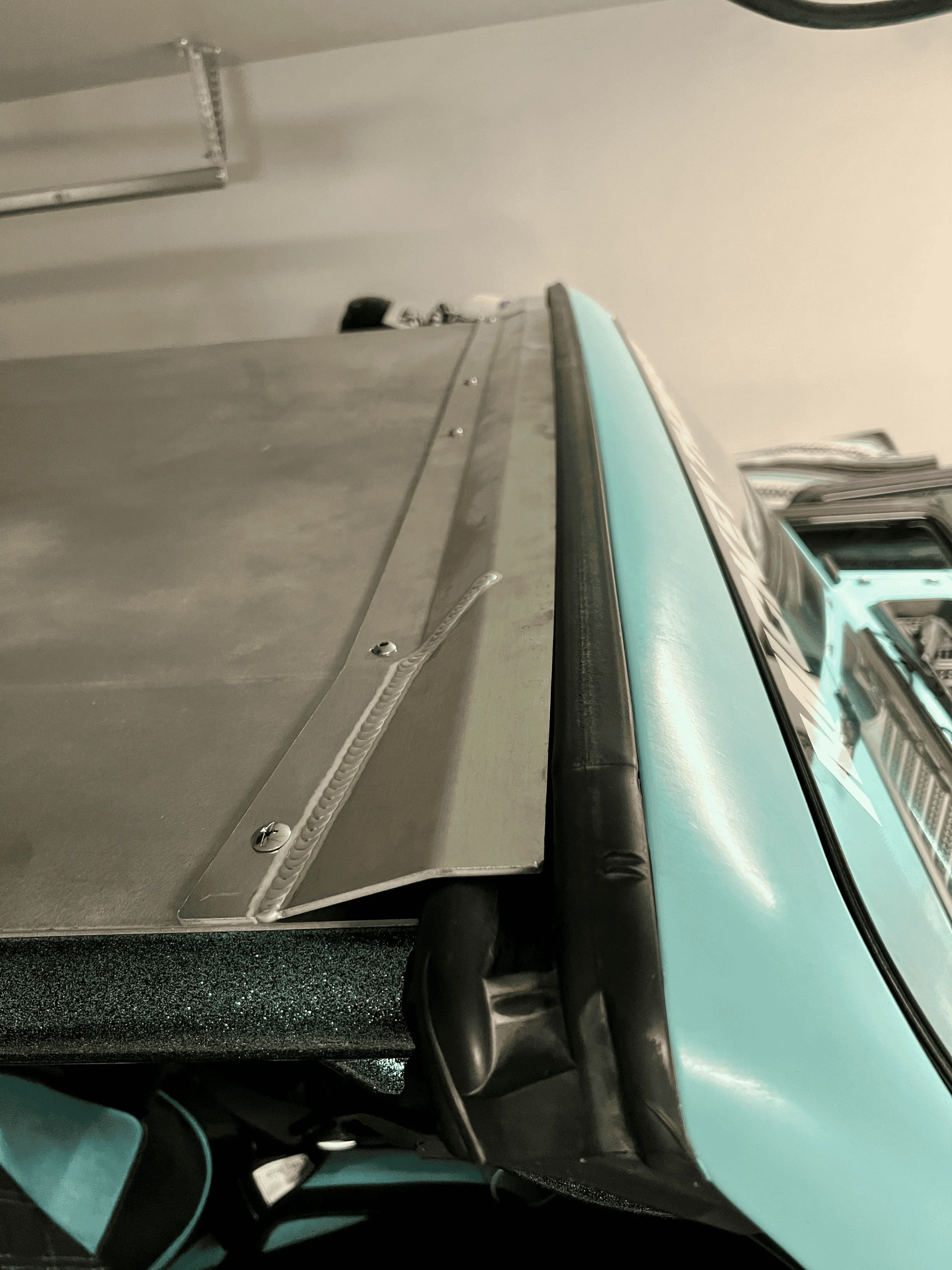

Can you throw up some more pics of the aluminum top? I've been thinking of getting that myself.

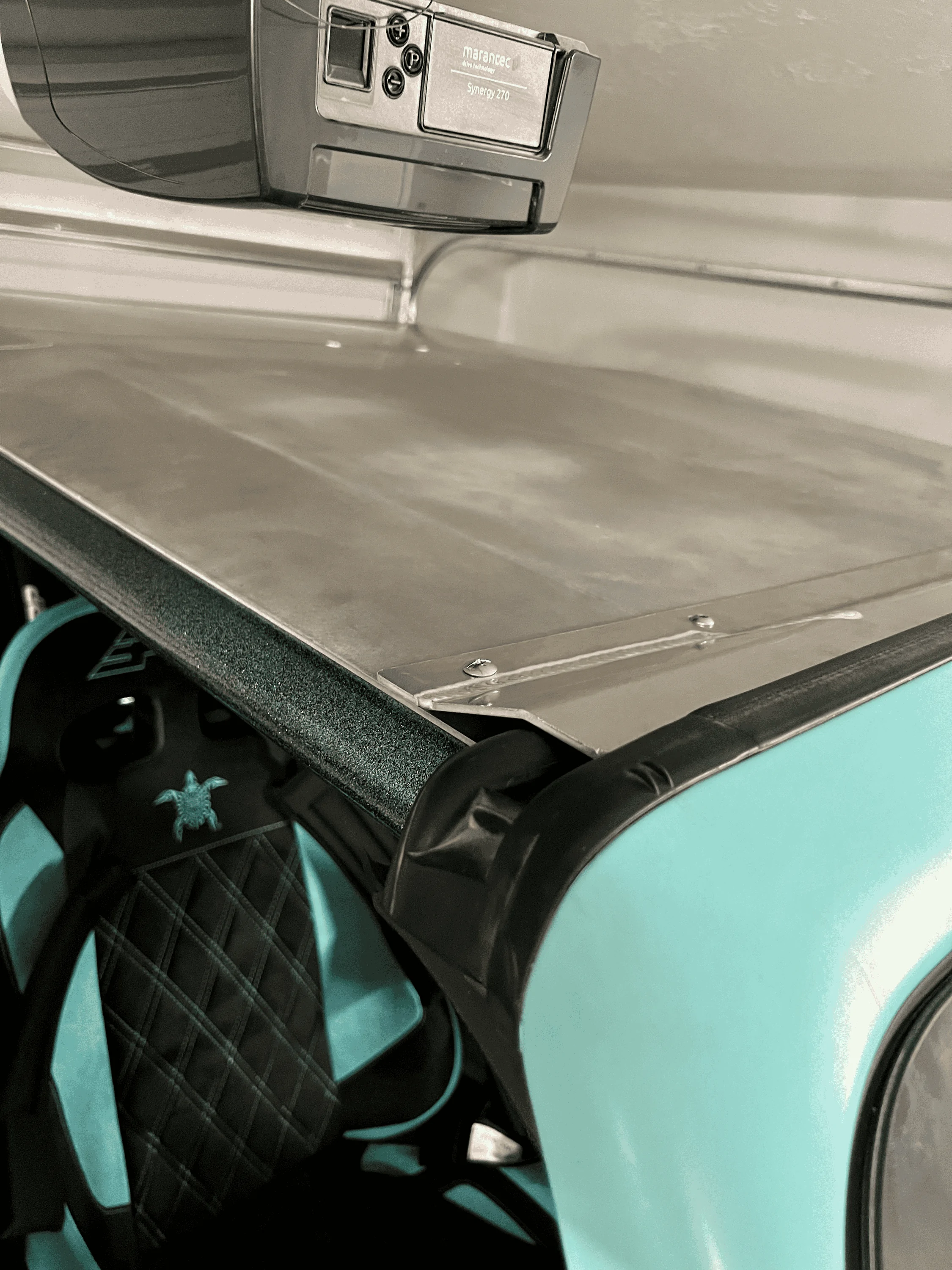

sure! I actually love it! I wasn't planning to get it initially but my husband really loved it, It is a really nice addition. These are in the garage but I can get better ones later if you'd like.
Jeep Wrangler JL GenRight Roll Cage Install tempImagesyBZ8I
Jeep Wrangler JL GenRight Roll Cage Install tempImageUaleS2
Jeep Wrangler JL GenRight Roll Cage Install tempImageQXUkKd
Jeep Wrangler JL GenRight Roll Cage Install tempImagekoaX29
Jeep Wrangler JL GenRight Roll Cage Install IMG_0705

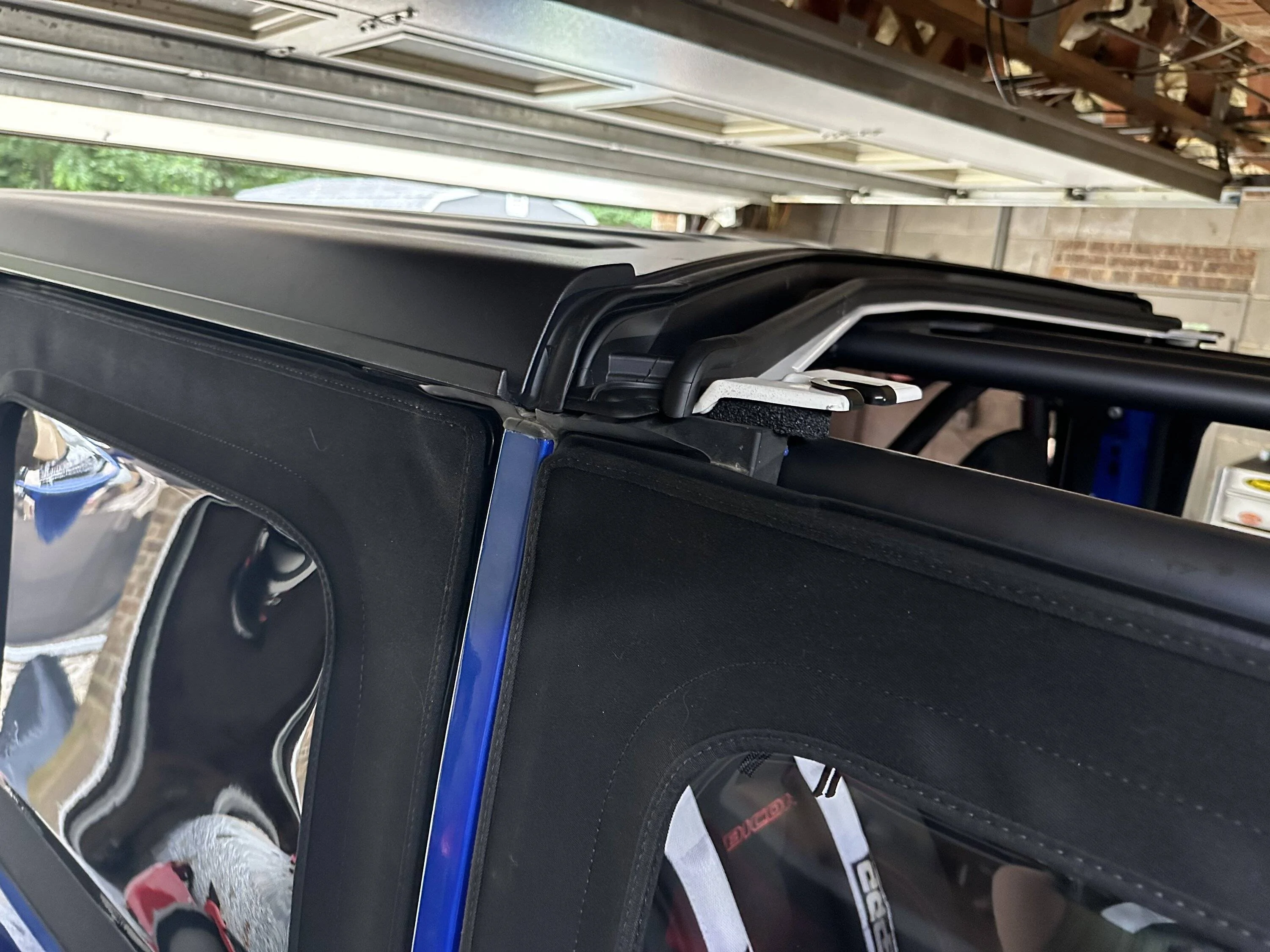

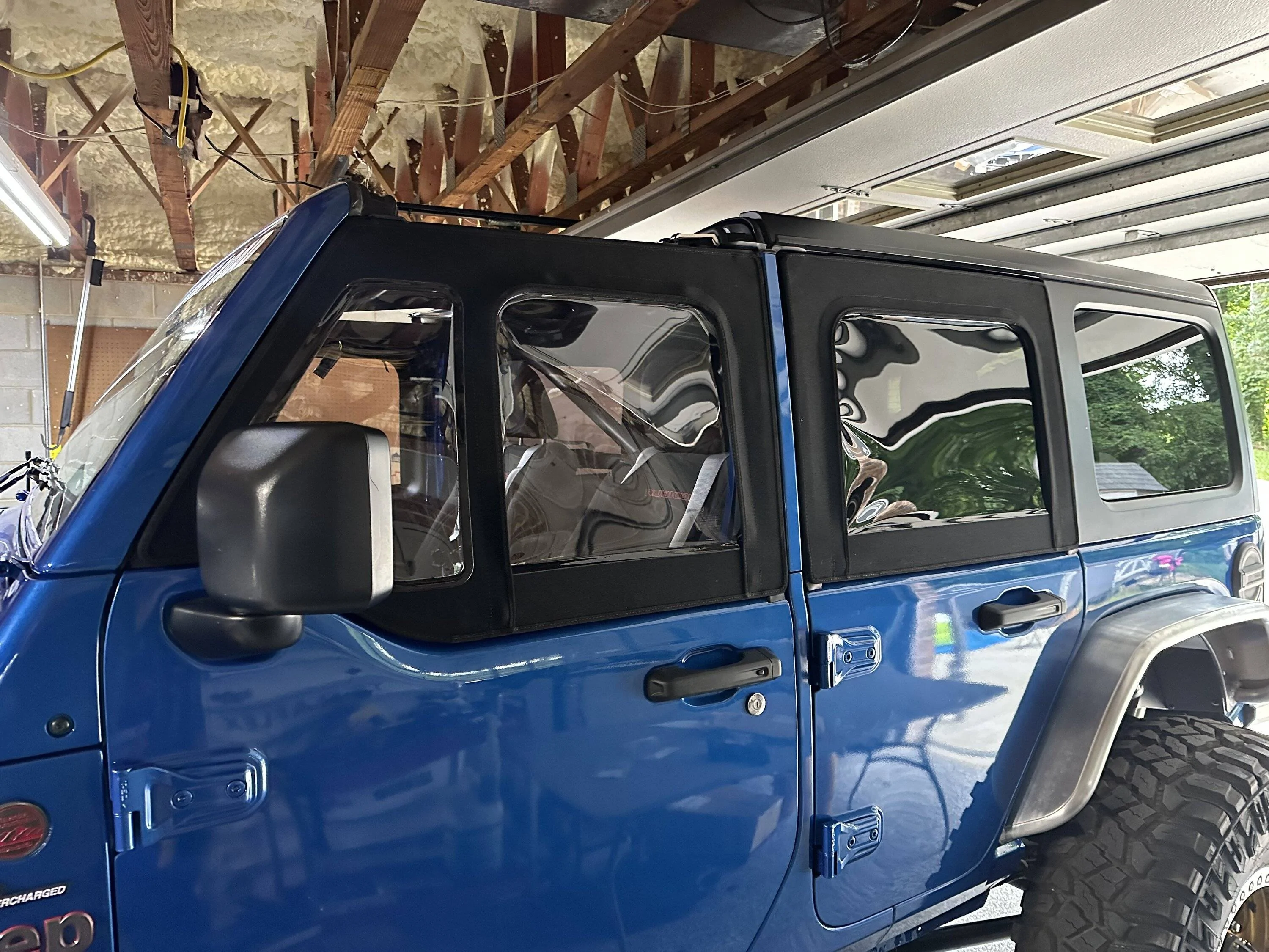

Yeah. The Jeep runs with a hardtop and half doors with uppers.
So, do you have to cut off those 2 areas on the B-Pilar so it can bolt to the bracket? I can't find any actual instructions for that part.
