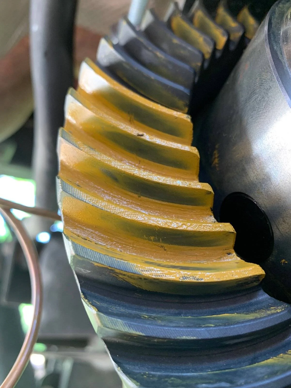

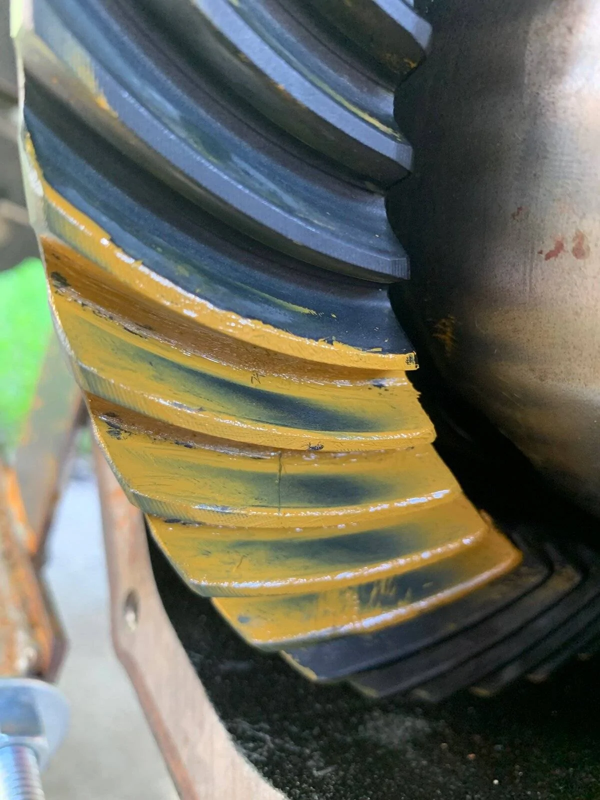

Would you call this good?
Jeep Wrangler JL Gear swap.  Check my pattern please. IMG_5353

It's set a hair to the performance side, but not enough to matter. You'll be good to go with this.
If you don't mind elaborating on this, I'd be very interested in learning something new. I've replaced damaged diff parts in commercial vehicles, but was never in the performance sector of mechanics.
Thanks buddy!

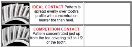

Edited to remove the ratio and rpm references. Added picture of a performance pattern from a standard pattern chart:
Jeep Wrangler JL Gear swap.  Check my pattern please. 1622059141845
Any pattern set to the inside of the ring circumference (center of teeth) would effectively be a performance (competition) set up. Under high levels of torque, the pinion is trying to unscrew itself from the housing. The torque applied is trying to do this, but the housing is much stronger, so the torque goes to move the tires instead. When you launch a drag car or equivalent high performance vehicle, this torque can distort the ring, pinion, and housing. This distortion under a performance setup would allow the pinion to move to the center of the ring teeth where it’s strongest. All that metal in there doesn’t just stay put under load. More load, more distortion. Any ring and pinion set more to the economy side (outside of center) would do well, but in a performance environment, the pinion would move further to outside of the ring. Higher risk of breaking the gear teeth. With all that said, none of these Jeeps produce that much power - normally, BUT when you’re in 4LO, that torque is absolutely distorting things. That’s why it’s best to have gears set up center or very slightly off from center.
It’s not always about keeping gears from making noise. It’s a matter of how you use the vehicle and load. The idea is to keep the pinion in the center and have enough backlash to use the oil.
