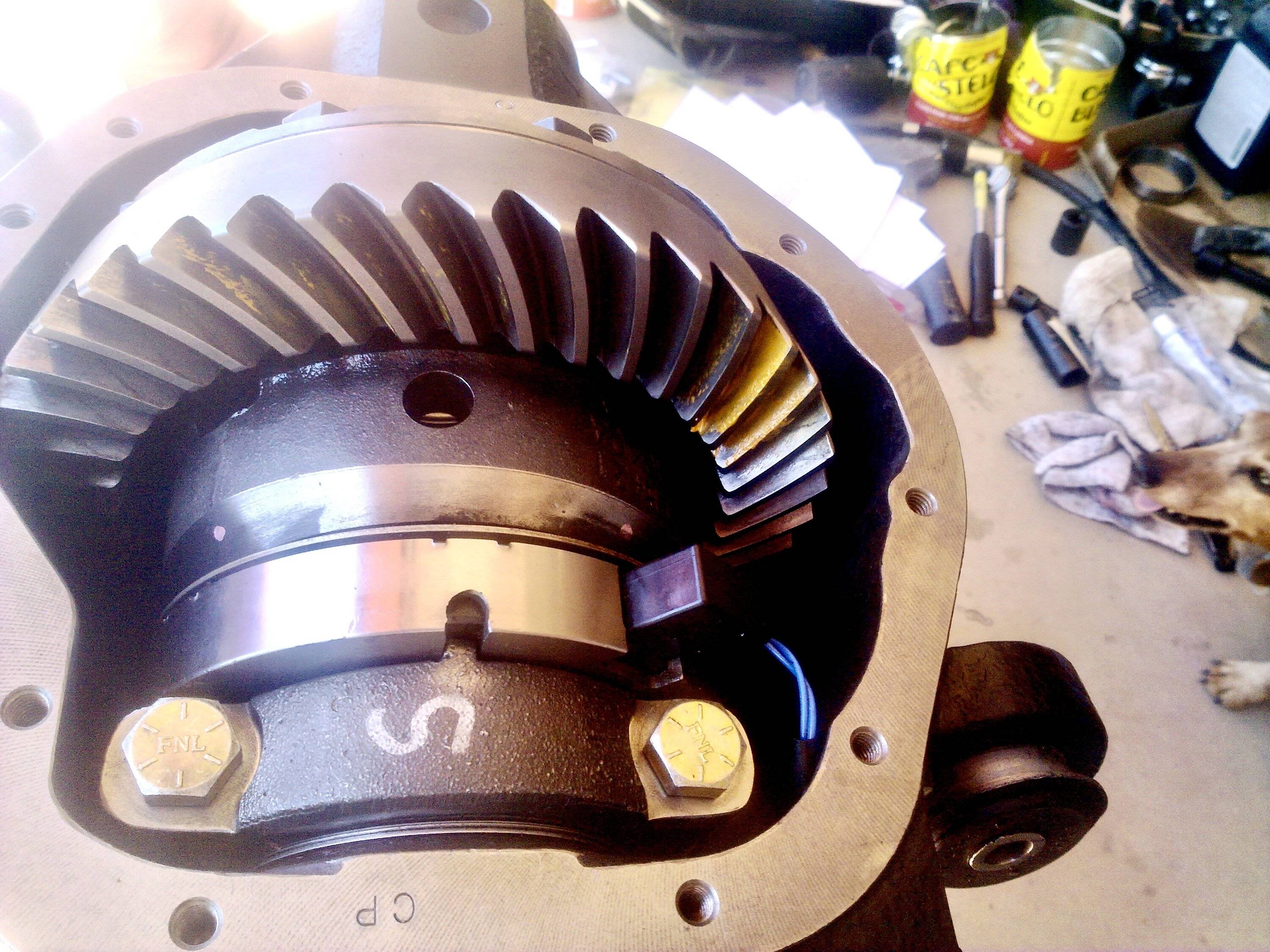

Just put in revolution 4.88. What do y'all think of this pattern? 18' Sahara LS Dana 44.

You are on your way and not far off...
Jeep Wrangler JL Dana 44 gear pattern 12052010678
When it's all said and done this is what mine look like...I only do a few at a time to keep it clean, hit this on my second go, and finished it after this...

Is there a pattern in there somewhere that you’re trying to show?
Yep, I had all but finished wiping off the markings when I remembered I need to take a pic. I document all my work for clients and send them. pics as I build their Jeeps. This does a lot of things primarily showing what I have done in accordance with their build sheet. My builds are generally complex.
I’m just not sure why you shared that picture in a thread asking about hear patterns. There is no discernible pattern in that picture.
Put you glasses on, nice an yellow, just not much of it...as I stated, I was getting ready to button it up, but had forgot to take pic and I had about 3 faces I had not wiped clean, and did need to do it all over again, this a pic for my client...
Thanks. I definitely got mine messy. I lost count how many patterns I ran...several.
I was lucky and my second pass I hit on the head and was excited I was not going to spend the afternoon with it so I started cleaning up and Ooops forgot the pic, so I stopped and still had about the last 2 or faces to wipe off, you can see some left markers on the other teeth, I don't like to leave it on...
