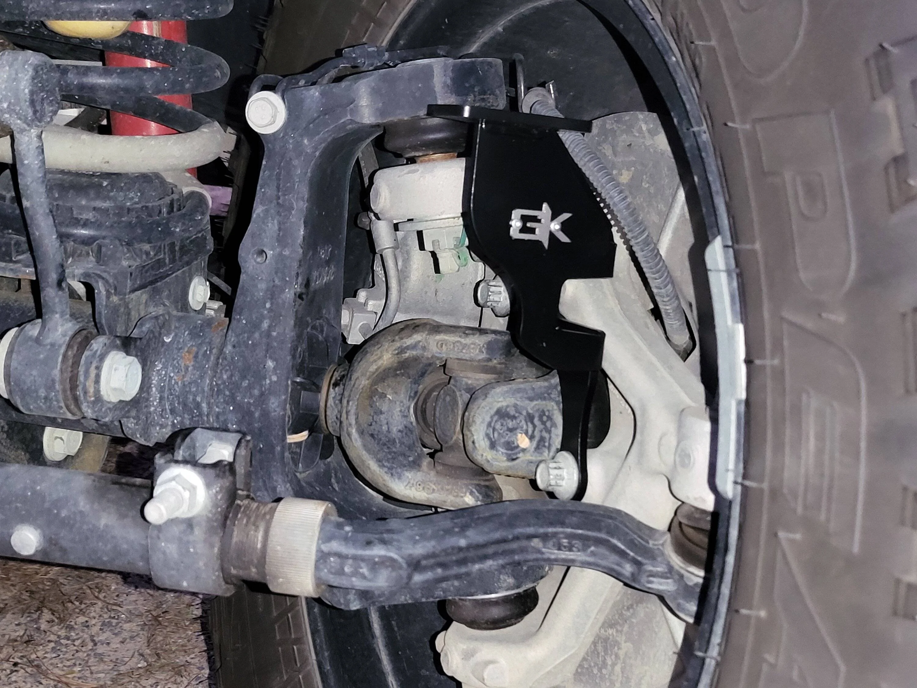

Well I must say this is a cool idea, the lights turn with your steering like a fancy car lol. Got the brackets and took maybe 10 minutes to put them on. Looks like stock 2dr rubicon height was not thier target audience, lights will be shining on the back of the bumper still. Bought thier lights but lost one along with the jeep key somehow while putting these on lol. Time to redesign it and buy a new key.

How do you think these would work with the OEM steel bumper in stubby mode?
That is what I am running. If you are a inch or more over a stock rubicon it should be fine. At stock height I can't aim them up enough without hitting the back of the bumper with the beam. Once you start Turning its fine though

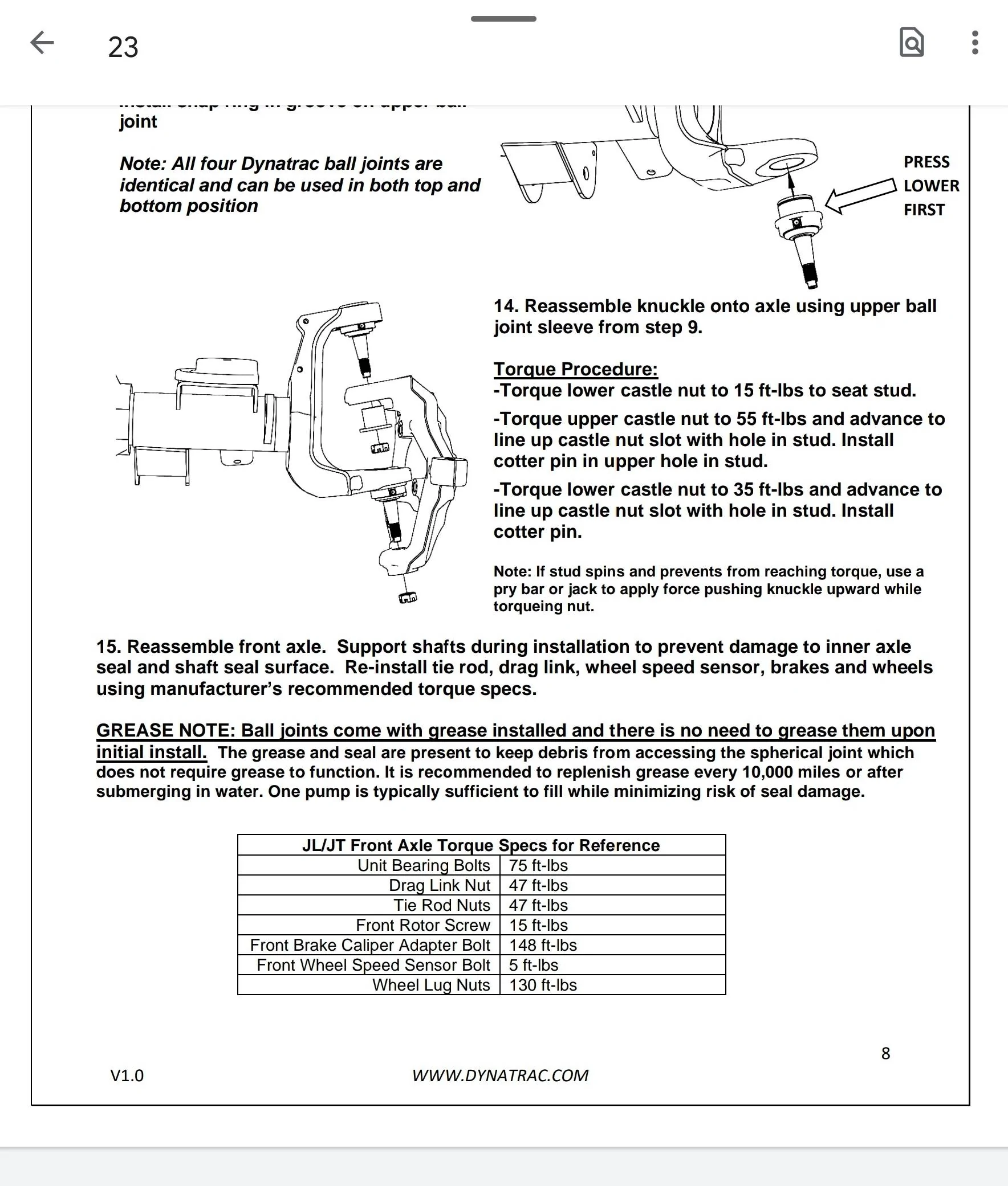

What did you torque the bolts to after install?

Are you mounting the light on top or under the bracket?
On top but I'm moving them under with some spacers and a plate I think. The slot wasn't long enough to mount low, the rear heatsink hit the bracket
