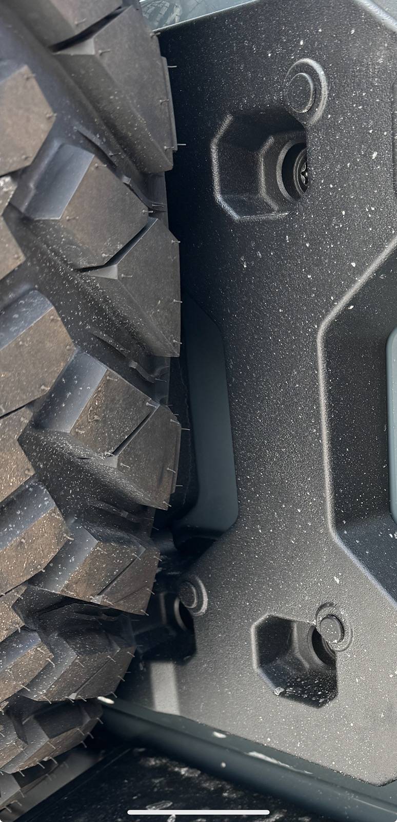

It supposedly does, if not I would like to know. 8.5” 1mm wheels ordered to replace the stock ones and planned on the Teraflex to snug it back.
It does. It’s very adjustable and you can get your tire right up against the tailgate. There’s not enough room between the tire and the tailgate for me to get a finger between the two. You shouldn’t have a problem.
I don’t have a better picture at the moment.

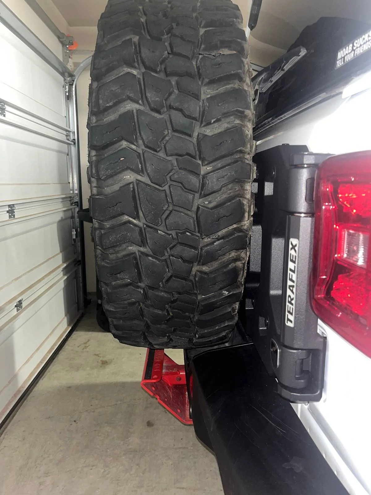

I guess I should have worded it differently. The wheel should be snug against it the Teraflex tailgate reinforcement.
My wheels are 0mm offset / 4.75” backspace and the tire is pressed tight against it and there is about 3/4” more adjustment available to go closer (if the tire wasn’t hitting already).

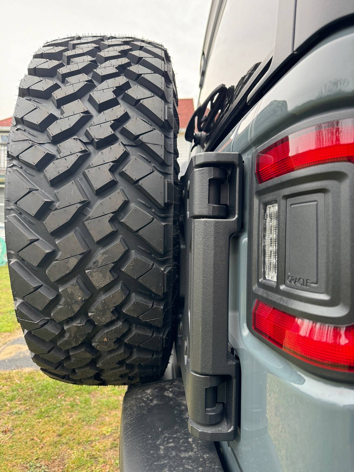

I am using their third brake light.
The light is a separate attachment. No hole to plug.
Here’s a better picture of how close I was able to get the tire, along with one of the third brake light attachment so you can visualize what I mean.

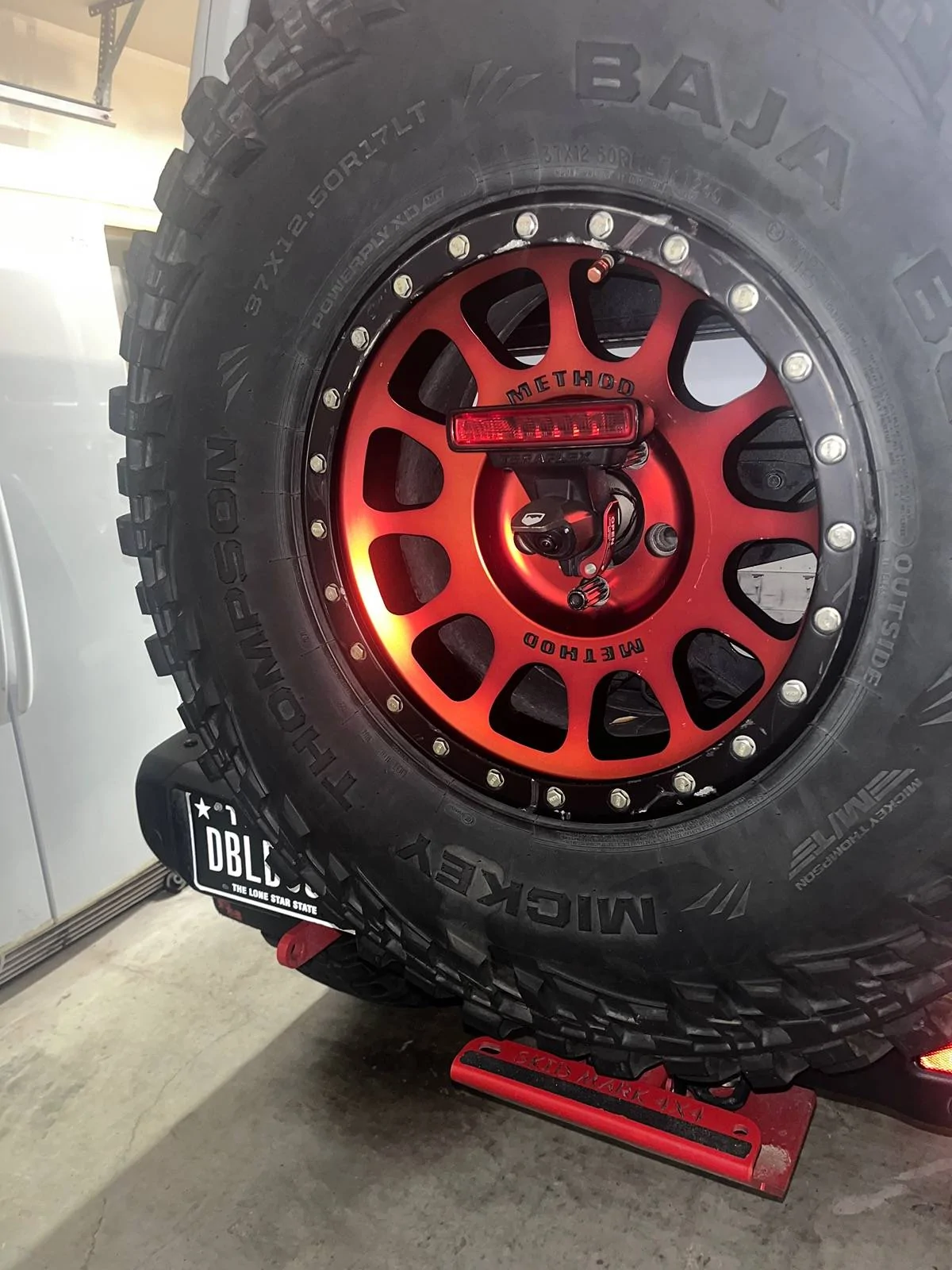

Yeah I did use the factory 3rd brake light relocated to the middle.
pics because why not

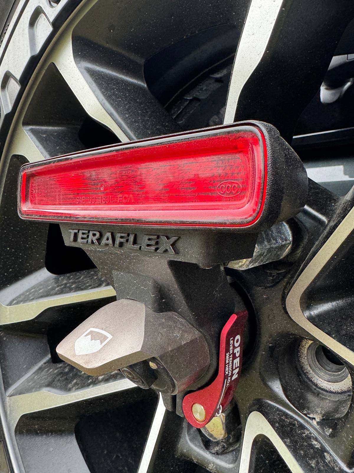

The pest is back, size is hard to judge from a pic but if I got an extra center cap and managed to drill out the center without ruining it. You think it would stick out enough to cover ?
