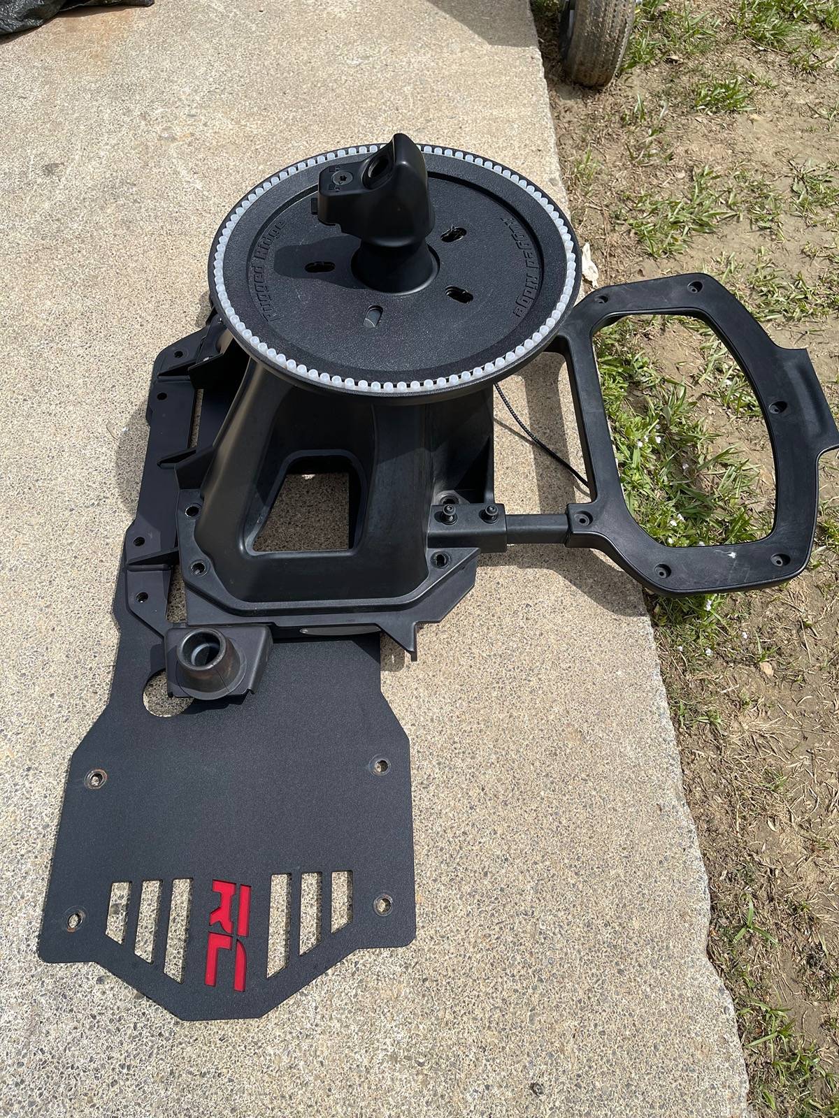

I went to 35’s a while back and installed a Smittybilt relocator to compensate for size difference. It utilizes factory camera mount wheel extension. Then I added a RC reinforcement plate that bolts to hinges and gate.
I recently went to 37’s so took it all off and went to the Smittybilt HD system which is super duty and takes place of factory hinges. Little pricey but heavy duty. If you stay with 35’s do the RC reinforcement plate with a relocator but if you have any plan to go to 37’s then just do the HD system and be done with it. By once, cry once!
Here is a pic of the RC plate and Smittybilt relocator I removed and am getting rid of in case you are curious as to what it looks like.
Jeep Wrangler JL Tail Gate Reinforcement IMG_4335

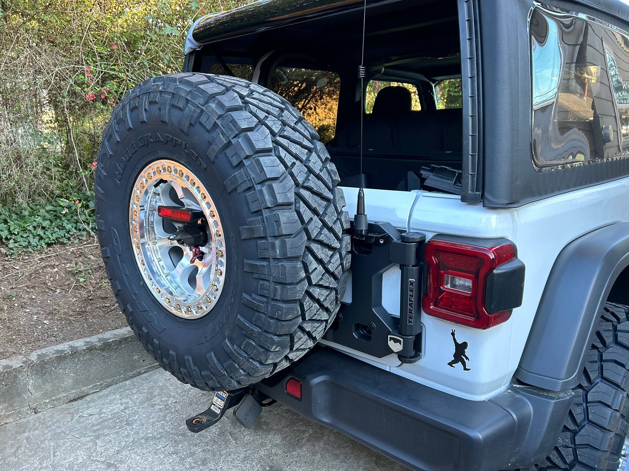

I have the Taraflex mount and gait reinforcement and love it.
Jeep Wrangler JL Tail Gate Reinforcement IMG_8007

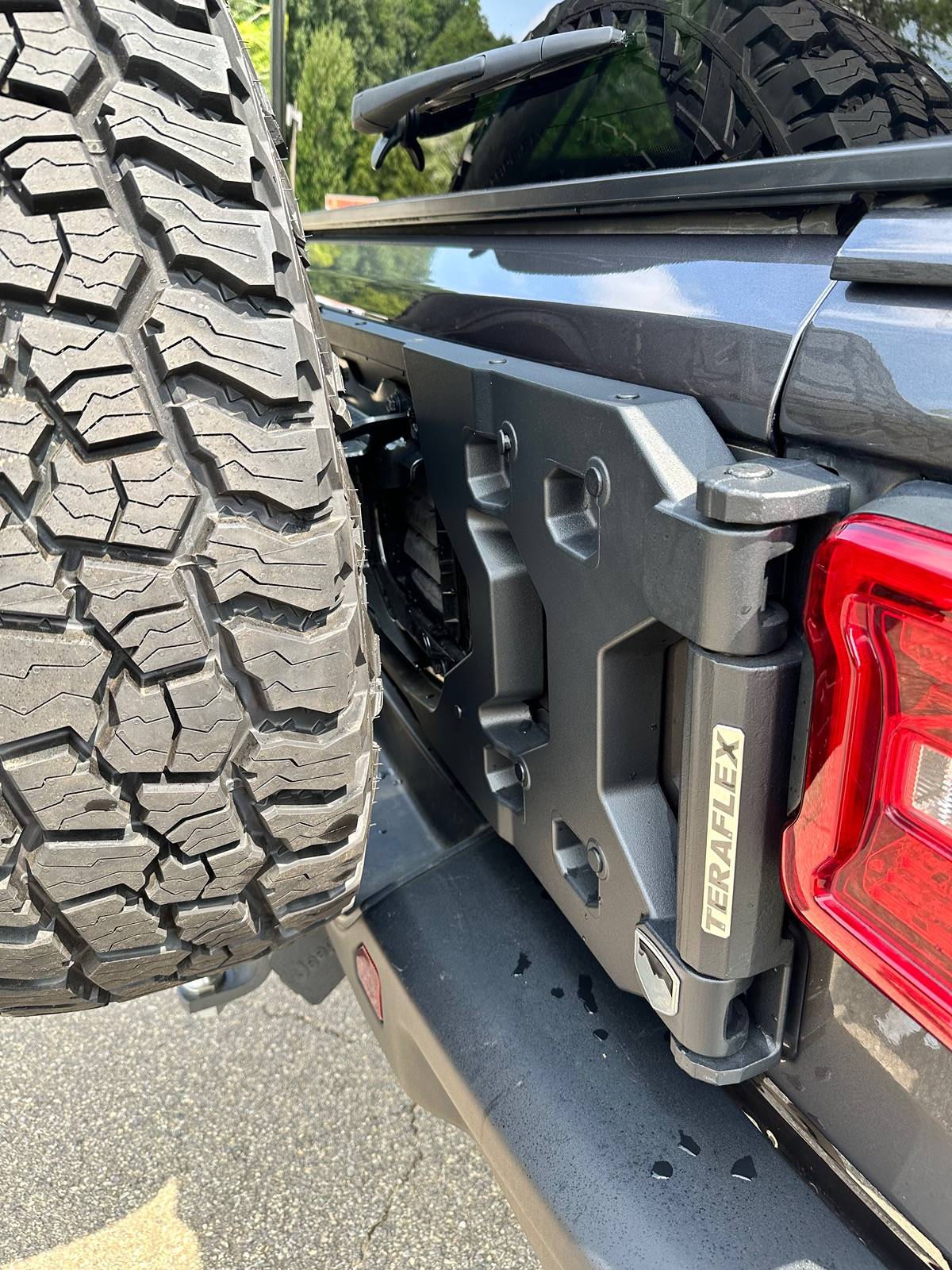

If you’re mostly driving on the street, you’ll be fine for a while; but a reinforcement of some kind would be better. Here’s my recent experience:
I just replaced 35s with 37s.
The 35 KM3/AEV Pintler on the factory carrier was not very impressive. Whenever I would close the tailgate, it would flex and bounce a lot! This was probably going to cause long term damage for me out on the trails.
The 37 Ridge Grappler/KMC Riot is mounted to a Teraflex gate reinforcement/carrier. That thing is solid!! What a massive improvement. No movement at all!
There are lots of solutions. Some more affordable than others. The Teraflex is expensive; but the fit & finish is amazing - top shelf.
Jeep Wrangler JL Tail Gate Reinforcement IMG_3389
