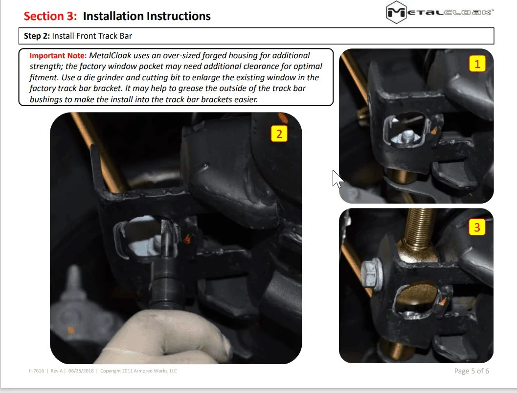

Has anyone had to modify the front trackbar bracket for aftermarket trackbars? I have a metalcloak trackbar to install (replacing my worn out synergy) and will need to grind the axle side bracket for the larger end to fit.

Yes; I have MetalCloak as well and there is a small amount of grinding needed. It does not impact strength or integrity at all.

If anyone has a pic of how much grinding is required that would be great. I plan to open it up a bit to fit.

I just recall it noting the bracket needed modification and wanted to ask to see how much material I needed to remove when I get out there later today.

It's the bottom side that needs to be modded. I would go slowly and only remove enough to allow it to fit. I am pretty sure that mine is not opened up as much as is shown below:
Jeep Wrangler JL Front trackbar installation bracket grinding for fit 2021_08_27_11_52_29_Slide_1_and_3_more_pages_Personal_Microsoft_Edg

That should work.. I'll just work it a bit until it fits. Thanks!

What kind of joint does the MetalCloak track bar have in that location? I installed a Rock Krawler track bar that had a heim joint in this location. Instead of removing metal from my Jeep, I removed metal from the heim joint. I used a lathe, but I could have made do just grinding the parts on a belt sander. I ended up having to shave about 0.012" overall to get mine to fit more reasonably.

I was glad to have an electric die grinder just because the neck is longer than a standard pneumatic
