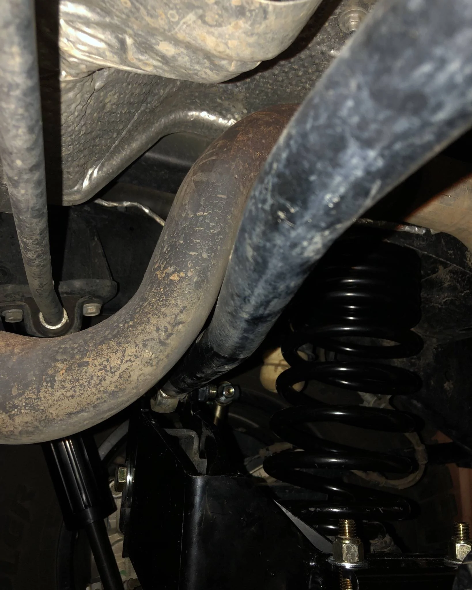

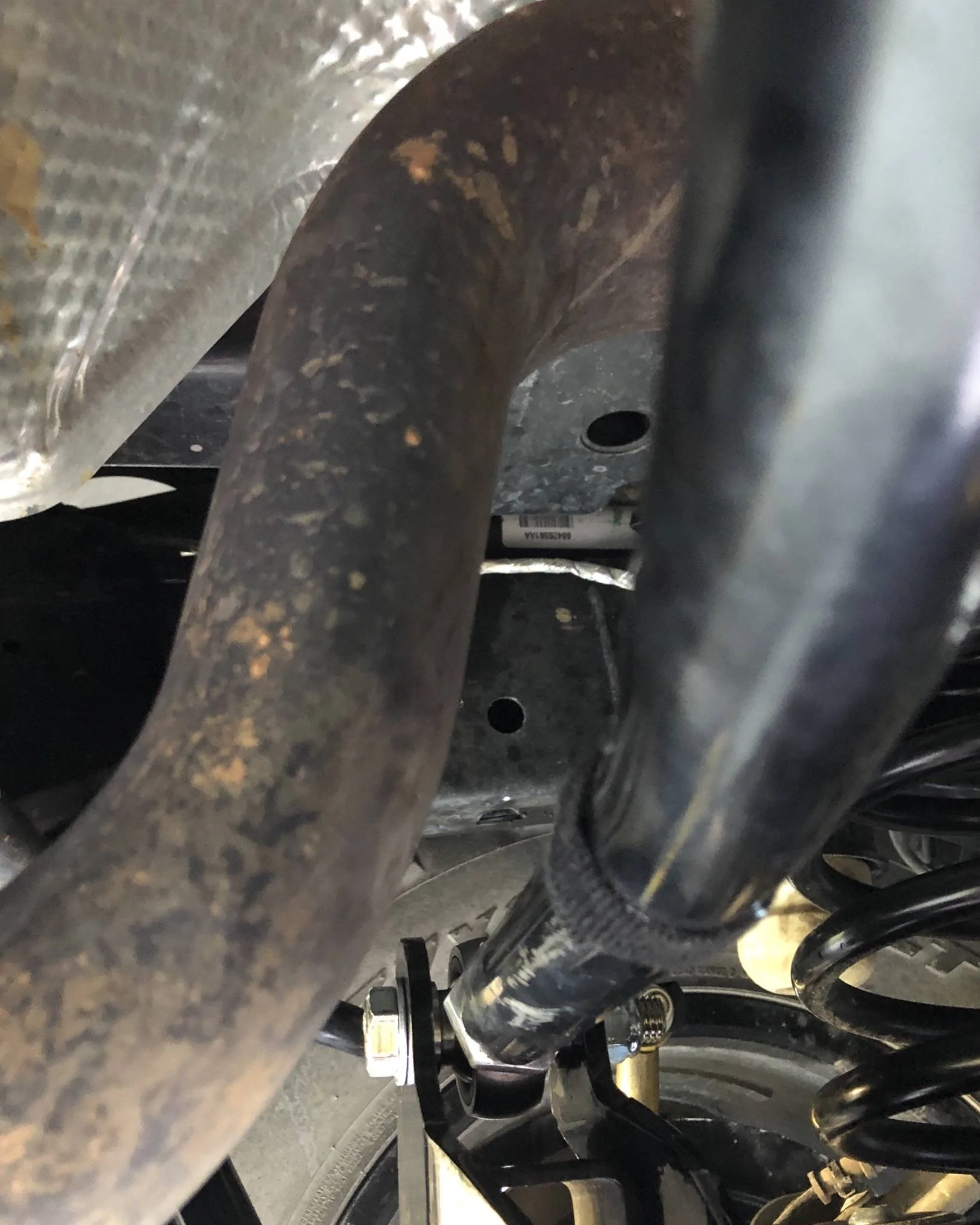

If there’s enough lift it will be ok. Does the 2.0 have the same exhaust in the rear as the 3.6? The one I just did had the muffler delete. Here’s pic of where it rubs.
Jeep Wrangler JL Trackbar relocation bracket needed? 05C5F7BF-D6EF-41AA-AED4-722AF64DEDF4
I fixed mine by loosening the exhaust and pushing it back a 1/2”.

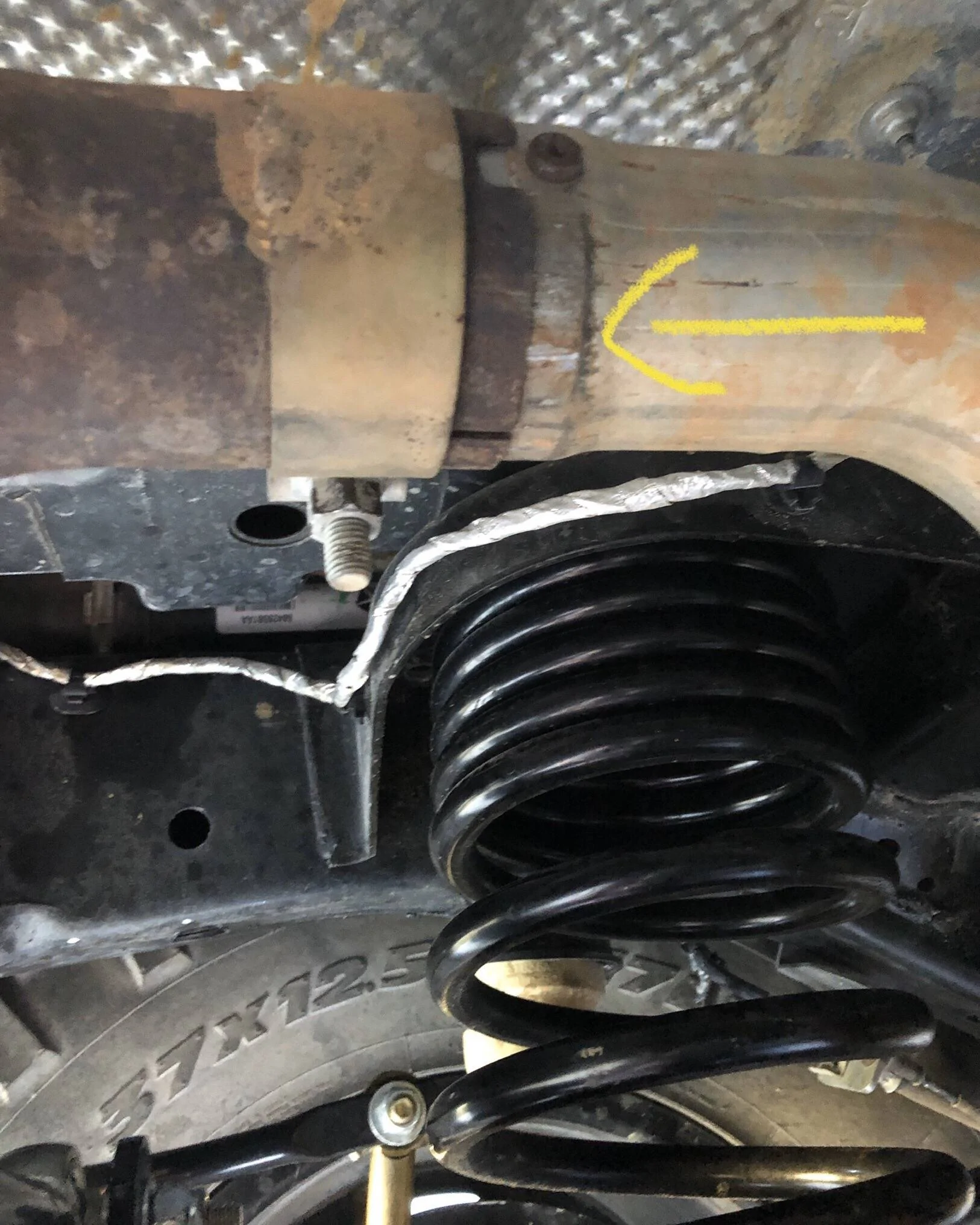

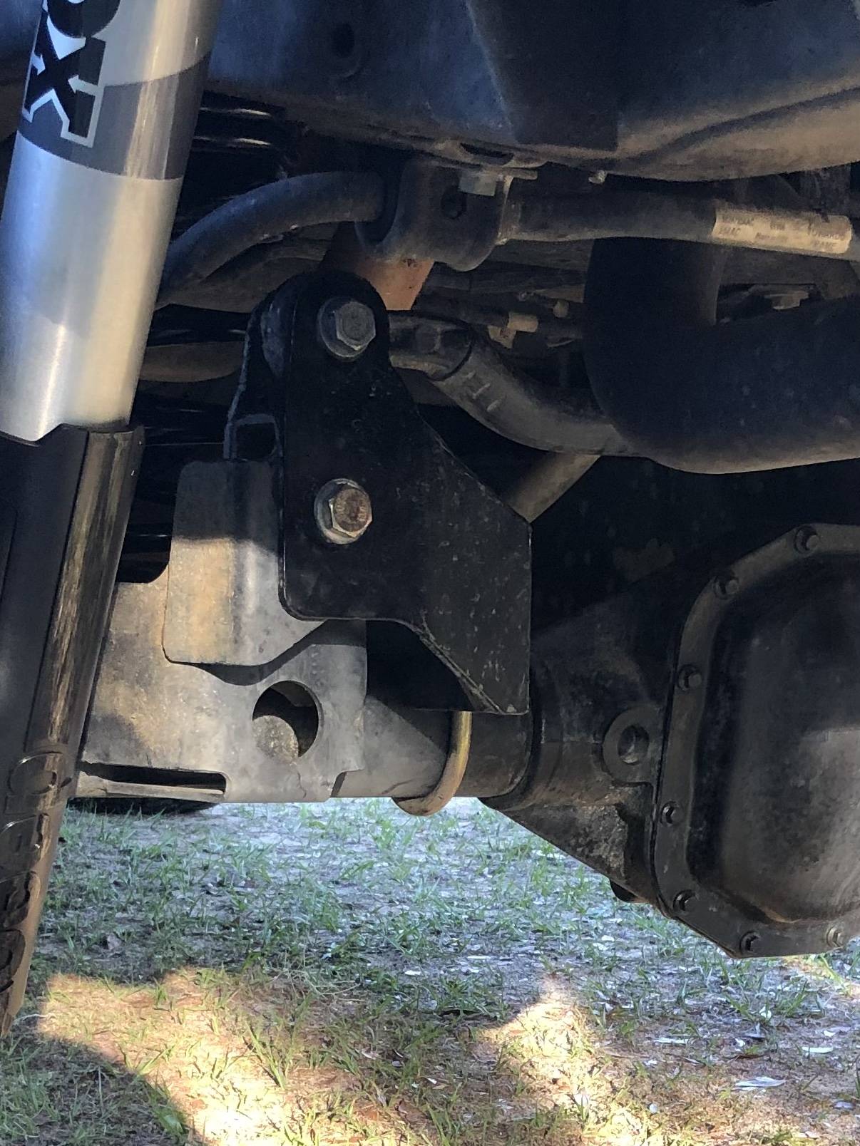

I have Sport 3.6 with Mopar lift and gained almost 4” of lift. I utilize RK relo bracket and Synergy adj TB. I have the TB set at stock length to get axle centered. To be honest, I haven’t full stuffed rear to verify clearance.

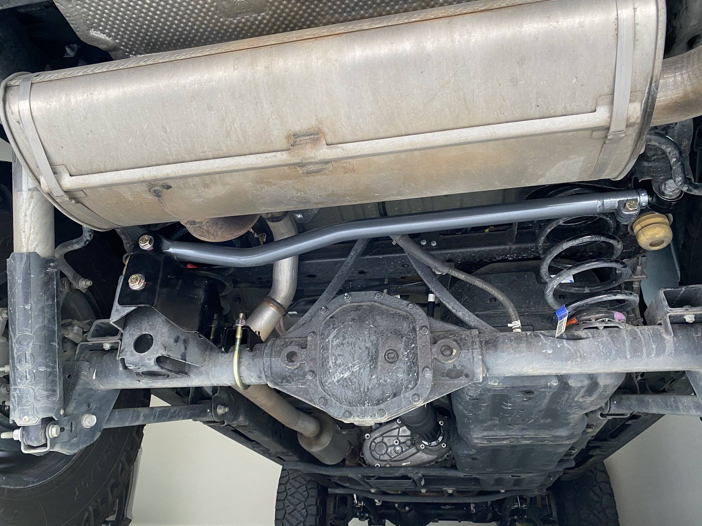

You see how the synergy bar bends down right away out of the bracket same as oem. But rk track bar is straight in that location………
I could see that being a problem utilizing both as questioned. I know you mentioned your exhaust, was that before or after long arm install?

@a23persaud just to clarify. Bracket alone would center axle but the aftermarket TB really firmed things up back there. I would describe it as more planted ??

Thanks man! Yeah, if I go Mopar 2” I’ll for sure be adding both. Just worried the RK relocation bracket + RK rear track bar will interfere with the pipe of the exhaust (left side of your pic).
@Roky definitely pointed out the concern.
