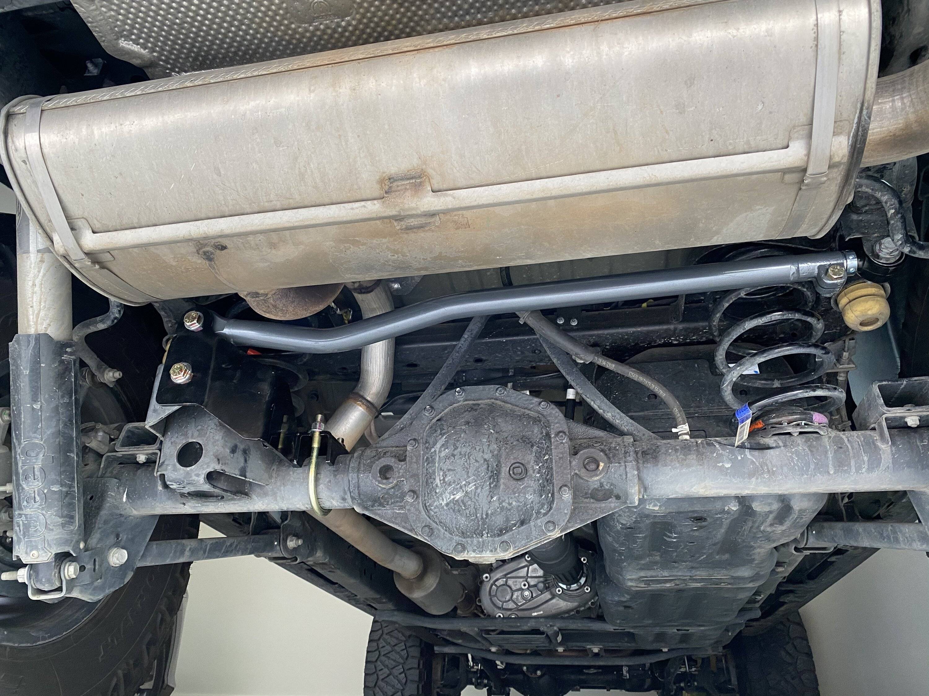

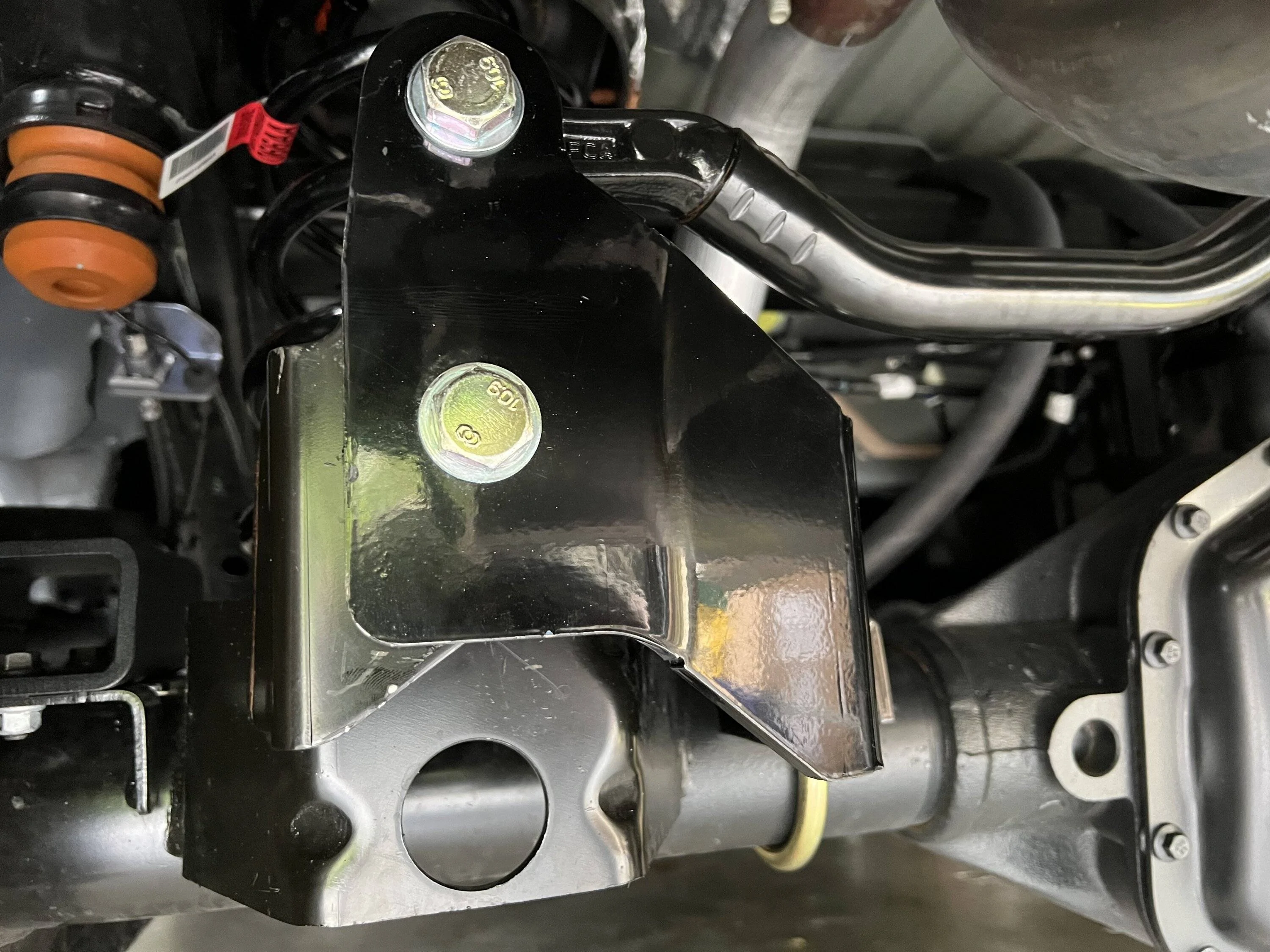

I've got the 3.5" Gamechanger on my JLUR and synergy brackets on both ends of my rear track bar. It doesn't at all limit uptravel. My rear sway bar was the only thing that was limiting it, as the bar was hitting the bottom of the frame. Antirock fixed that. After a year of having the relocation bracket, I've yet to find a downside from it.
This is an older pic. I more recently swapped out that synergy rear bar and finally installed the Metalcloak bar that I've been sitting on. The new bar clears just as well, of not better.
The synergy relocation bracket is the priciest of the lot. It's added benefit over the others is it doesn't rely on a gusset and ubolt that attaches to the axle tube. That would interfere with the Metalcloak rear diff skid, or any other brand skid that attaches to the axle tube.
Except the pricier synergy one, the other brand brackets are typically more cost efficient than a quality adjustable track bar. For less money spent, a relocated factory bar will get the rear axle closer to center and helps to reduce head toss when going over bumps because of the raised rear roll center. An adjustable bar mounted to the factory bracket will allow the axle to be perfectly centered, the bushings will be of much better quality, and the stronger bar will do a far better job of next flexing under the higher leverage forces that accompanies a lift and larger tires. Doing both, as pictured above, is all upswing. The stronger bar, better bushings, raised roll center, and perfectly centered axle will equal a more solid, stable, and planted feel. That all domino affects to the added plus of an improved steering feel. Less rear axle to frame/body movement means less micro corrections to keep the Jeep aiming straight. At least that's the results I got with mine.
I've found that by splurging on the supporting parts, I've been able to more than offset the increased forces of the higher lift and larger tires. No exaggeration, my Jeep rides and handles better now than when it came out of the factory. And I never had any complaints back when itbwas stock. Without even bringing it up, every person that's ridden with me has commented that it doesn't at all drive like a tall vehicle with big tires.
