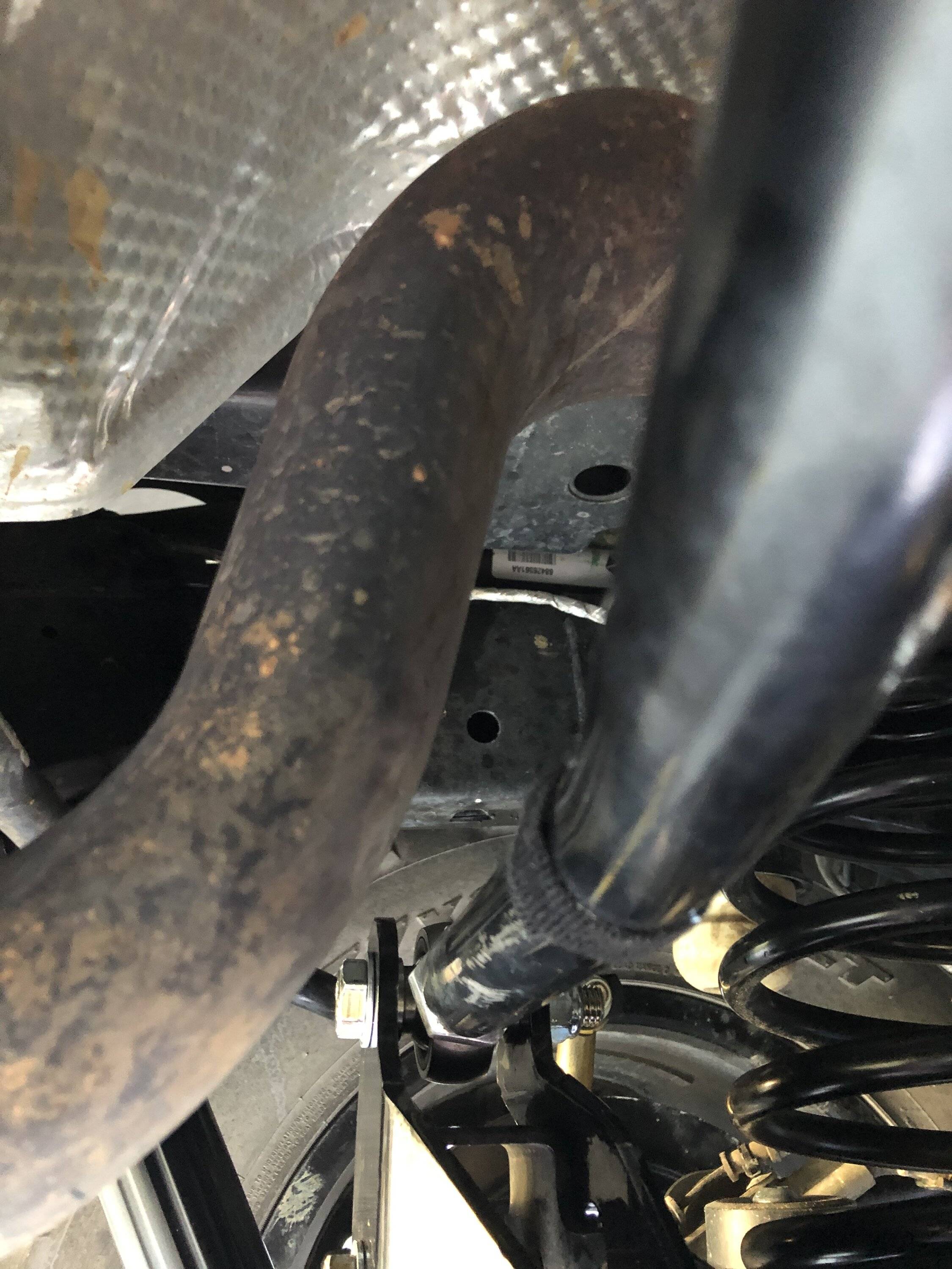

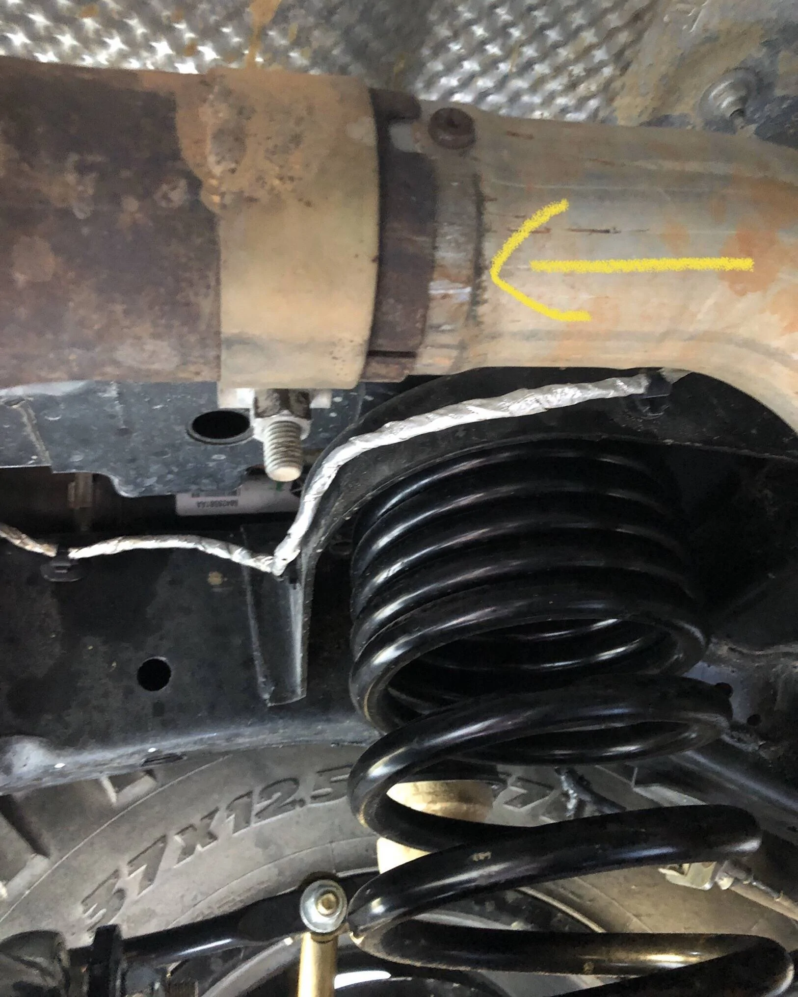

Yes, stock exhaust on a 3.6L
You should be fine with stock track bar, but some aftermarket will contact the pipe….. if it does you can just loosen the clamp and push the loop back 3/8 “ and tighten the clamp…..

Cool thanks. Don’t think I need a different track bar but was thinking the bracket would be good for the roll center, cut back on headtoss, etc. And I like that the RK one of a bolt-on solution without extra holes etc.
