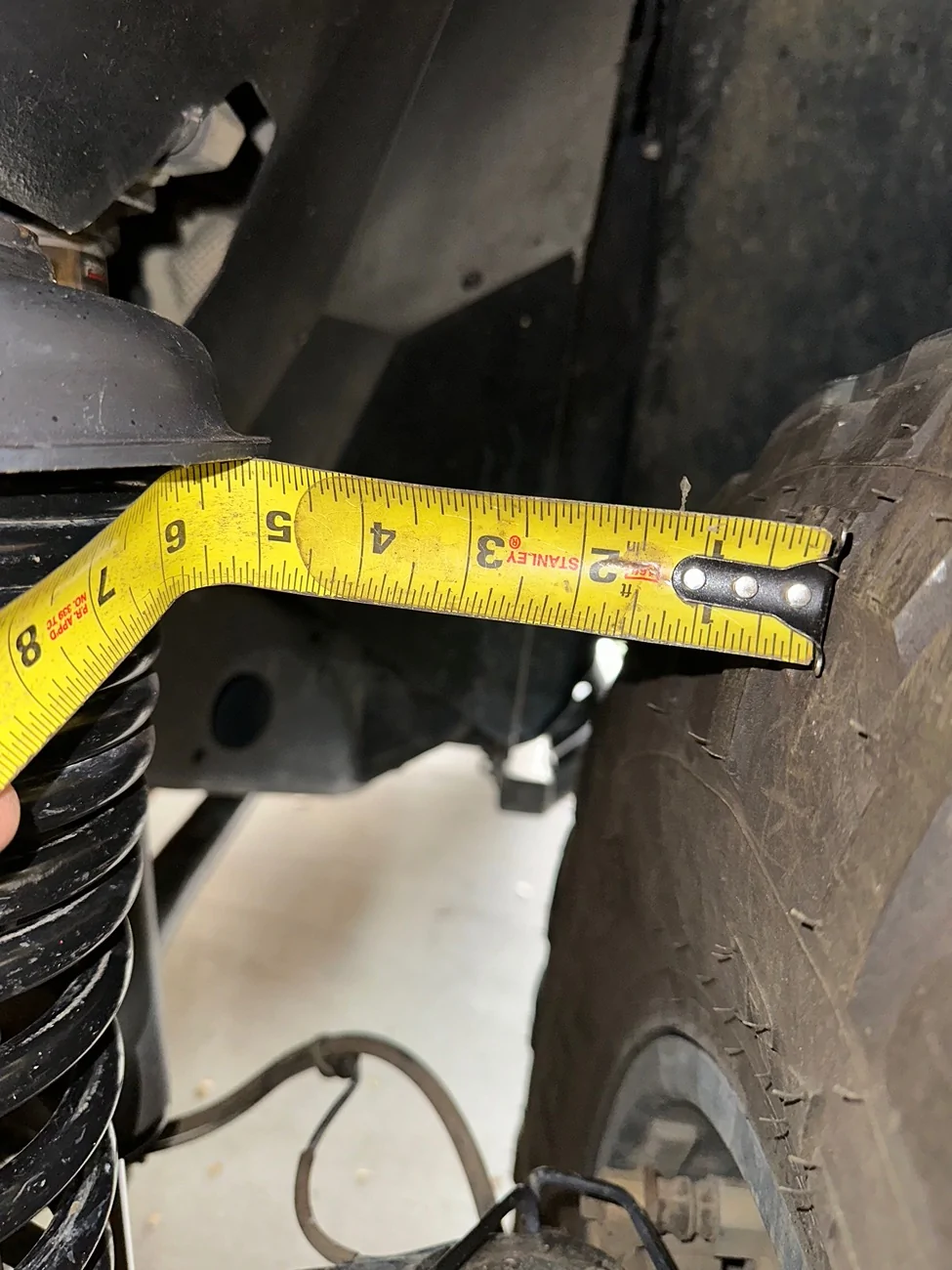

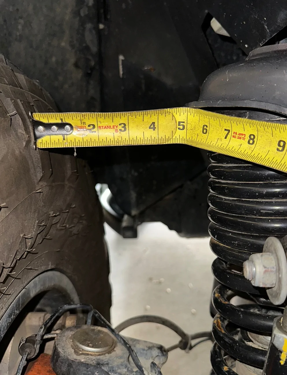

I wish I had thought to measure from tire to spring bucket... Instead I was rolling around underneath measuring diagonally trying to find points that were symmetrical side to side.

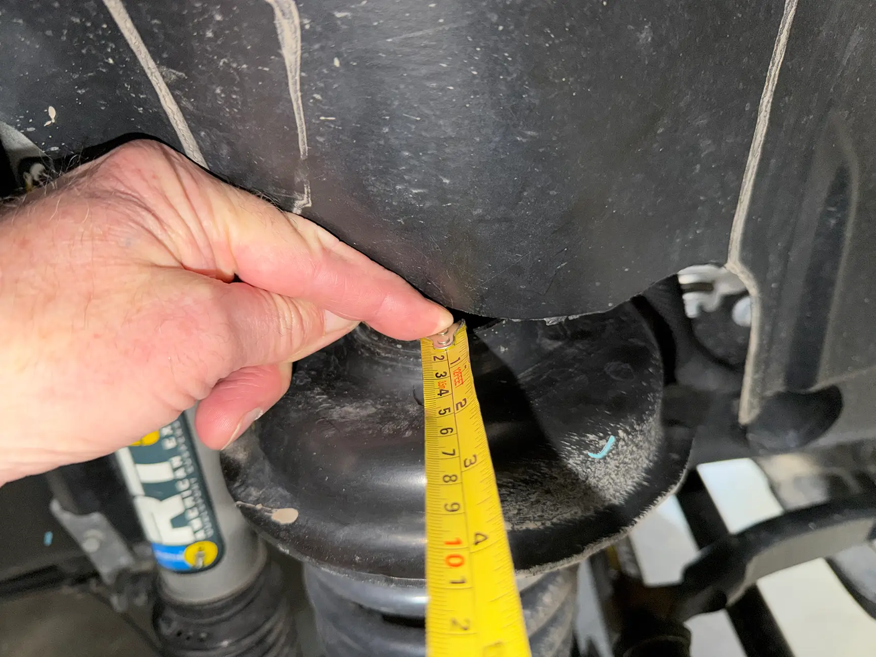

I measure from here as I can pull it tight and be in the exact place on both sides. also use the same lug on the tire lol.
