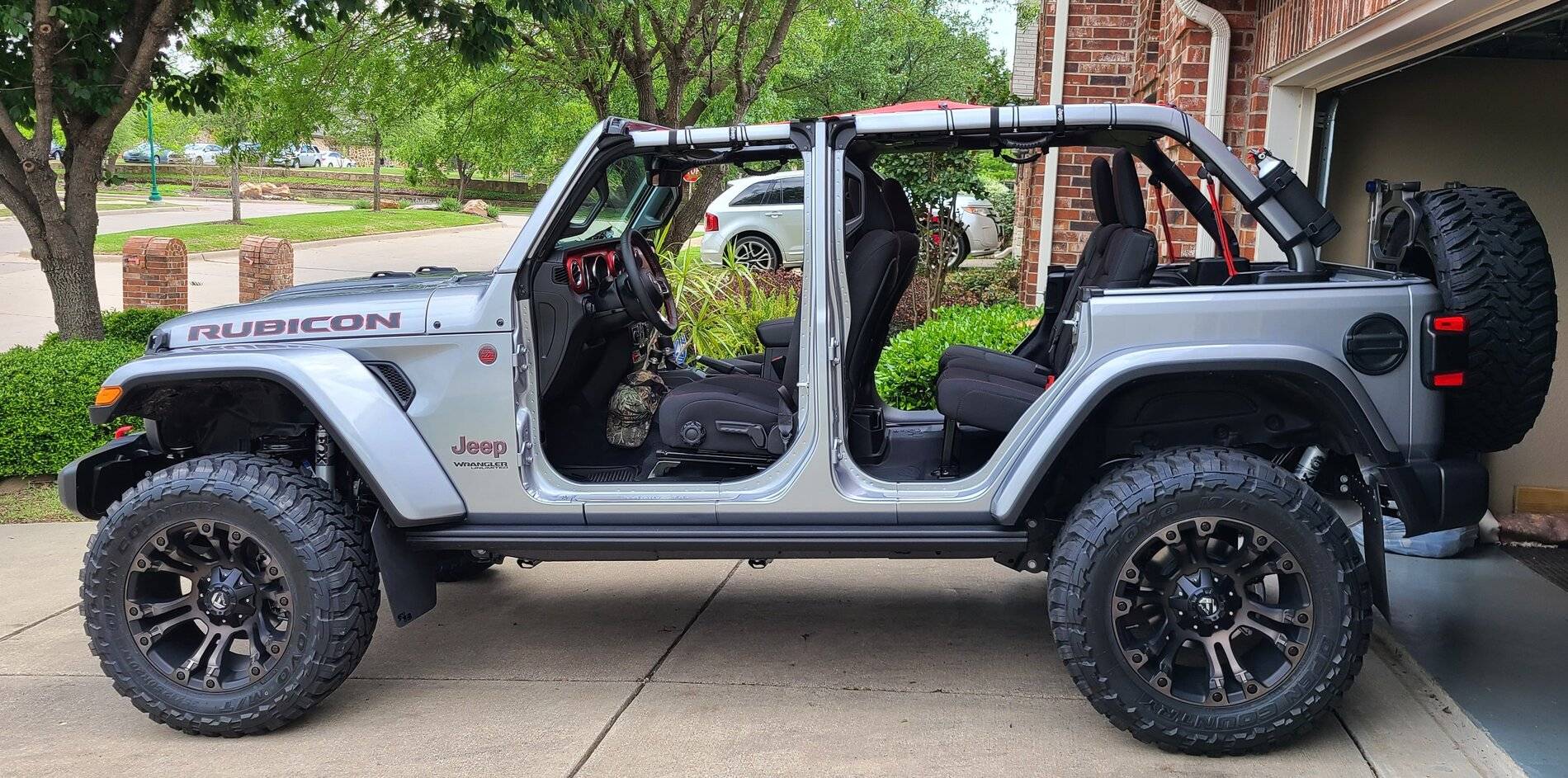

Can you post pic of your rig from the side ?
Excuse question. What are you looking for with the side view you are asking? I just don't follow all the wandering issues I read. I run 75 mph down Toll Road here and never have to steer unless I need to follow the road. I don't feel any pull from Jeep wanting to wander off track.
I guess I am just not following all these added TB etc issues.
He’s talking about getting rear upper control arms, and I wanted to see how far forward his rear wheel is whether or not I would suggest fooling with any rear control arms now or not. You see how your back wheel is favoring the front of the wheel well. Some are more extreme. Nothing to do with his wandering.
If you have both upper and lower adjustable rear control arms you can center your wheel, while also keeping rear springs from bowing , and keep your driveshaft/pinion angle happy......

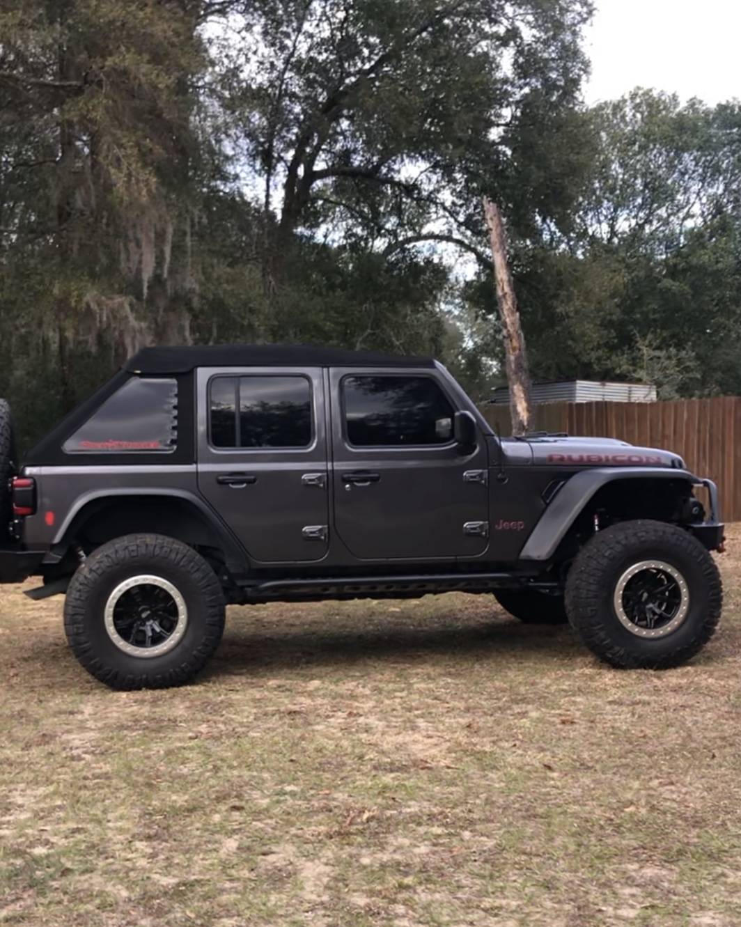

I have a 2021 JLUR with the Mopar 2” (ended up about 3.5”) lift and 37x13.50 Nitto Mud Grapplers. I added the rough country adjustable front trackbar and lower control arms already, however, I still need to get back to the alignment shop and have them push my front from 5.8 to 6.5 degrees.
Ihave an evo rear track bar relocation bracket I have not installed yet. My question is,,,,
Should I get the adjustable rear lower control arms and an adjustable rear track bar? I think I read someone on here saying the ride would be noticeably better.
I’m not real clear about adding the adjustable trackbar, along with the relocation bracket.
Any thoughts?

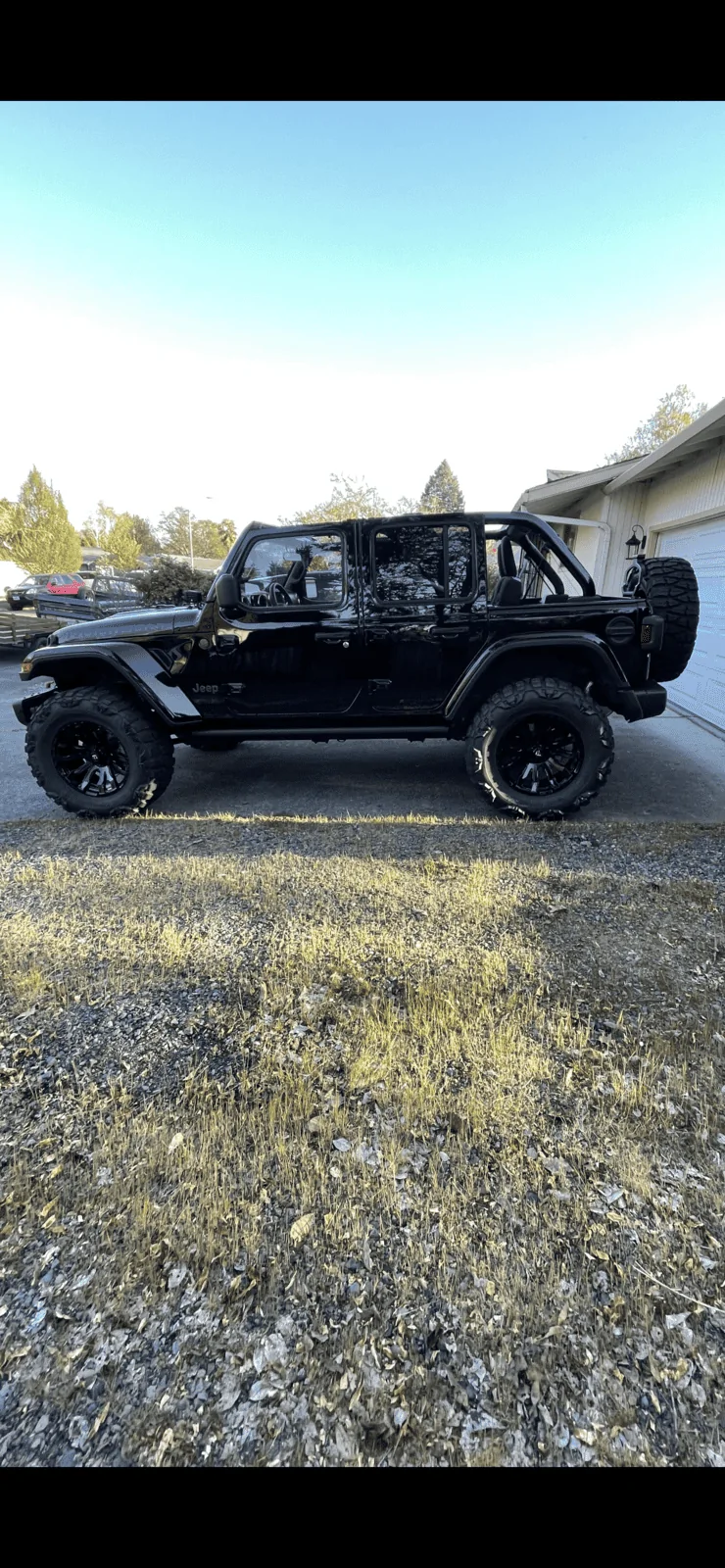

I’m going to order the rear trackbar and possibly a set of control arms before getting it aligned again. That way everything is on when they have it on their machine.
