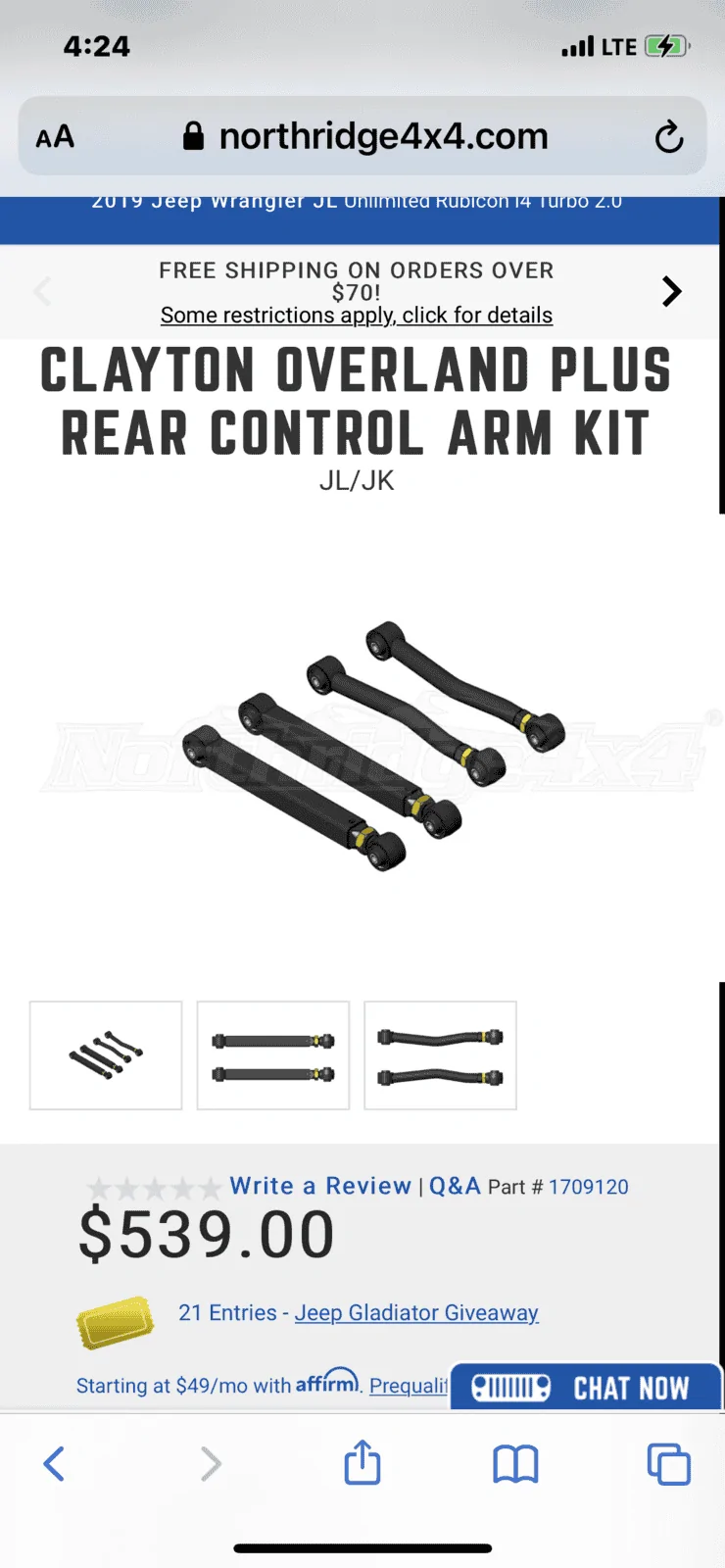

I gotta agree with Roky. They seem to have earned a solid reputation for making quality parts.
Anyone know if I will run into any problems with my wheels and the Clayton’s?
Pretty sure they are 20x9 with +1 offset.

I just read the product page, and the rear uppers are purposely bent inward for tire clearance when stuffing a wheel. It's also spec'd to work with 0-5" lifts. And your wheel and tire combo has shifted your inner sidewall outward by about an inch, compared to stock. Shy of 1st hand experience with them, I'd think you should be good to go.

You are Awesome,, thank You Sir!
I had sent an email to Clayton and not heard back from them

No problem, Kasey!
Let's page them and ask.
@Clayton Off Road
kapk22 is interested in your rear control arm set, but is curious if they will properly clear 20x9 wheels with +1mm offset wrapped in 37x13.50 tires. The Jeep is a 21 JLUR with the mopar lift. Thanks for any info you can provide.

Adam, with Clayton emailed me back and confirmed they will work. I submitted the order this afternoon from northridge. Thanks guys.

Sorry guys, was on vacation last week! That setup will work perfectly! :like:

Should be arriving tomorrow. When I get the trackbar in, I will schedule a day to put them on and get the alignment squared away.
