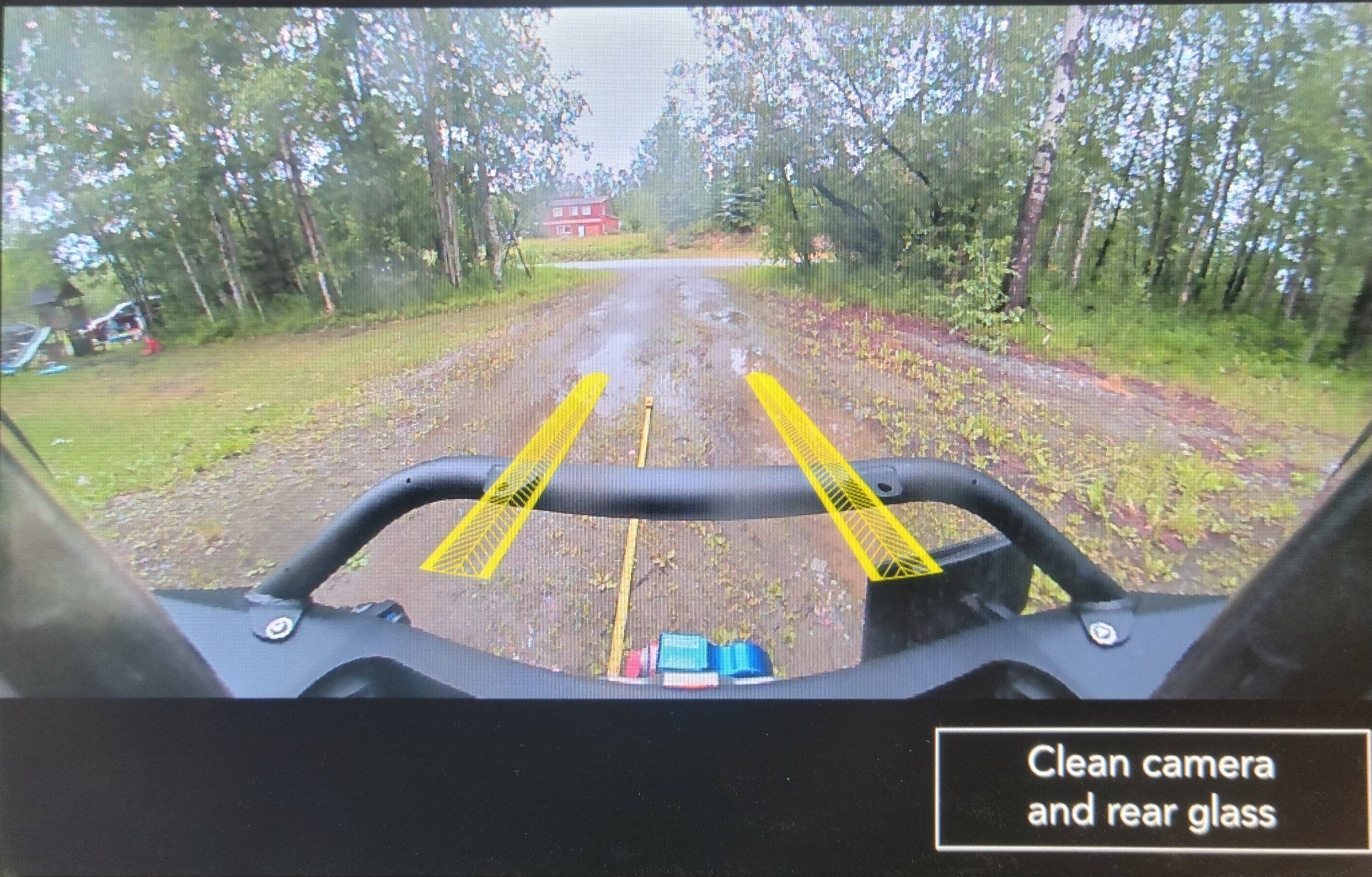

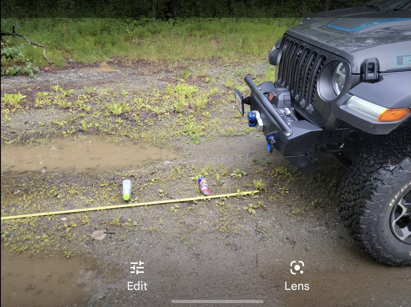

Took some pics after installing my new RC diff skid.
The nearest I can see with my bumper is 16", the short bull bar obscures at 39".
Jeep Wrangler JL Front camera option worth it? 20220716_185732
Jeep Wrangler JL Front camera option worth it? Screenshot_20220716-191104_Photos
I've got a 20" light bar coming that I'm planning on mounting under that bar. That's certainly going to obscure the closer view even more.

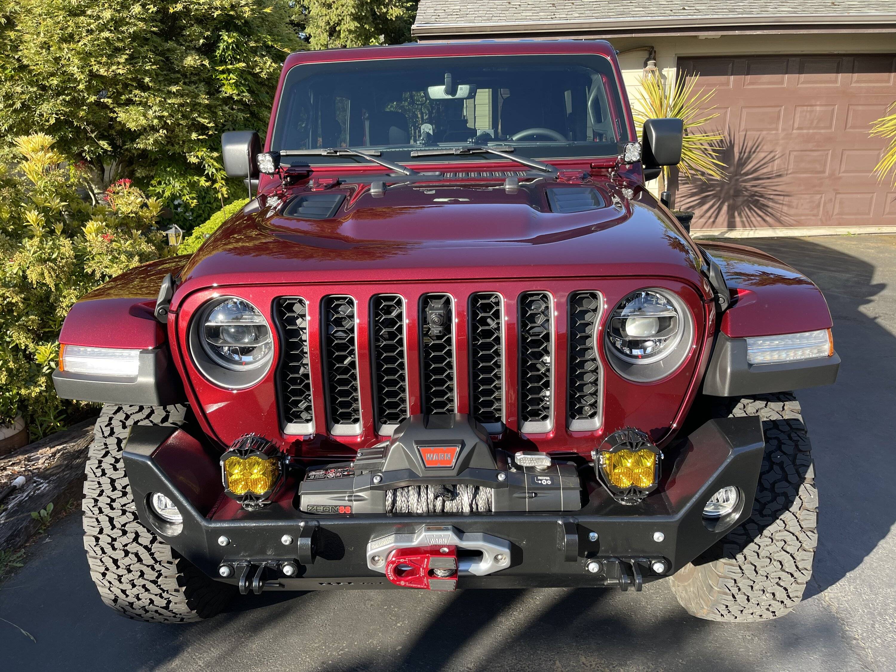

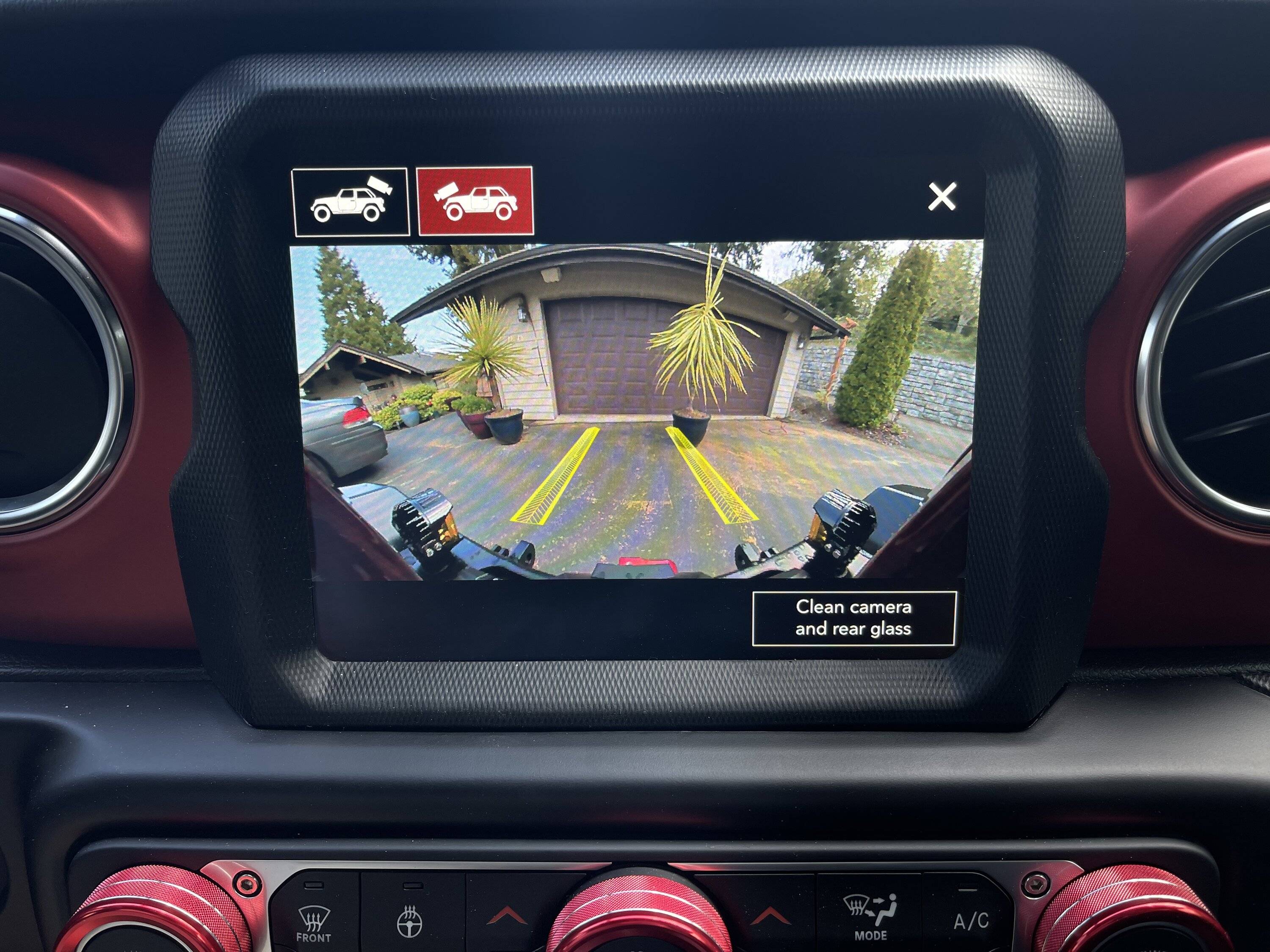

Winch and LP4 lights mounted on bumper. I deleted my bull bar to maximize the cam view…
Jeep Wrangler JL Front camera option worth it? 143107D0-5983-4C71-B24B-C43A6AB25C78
Jeep Wrangler JL Front camera option worth it? 7143FFB3-3B95-4ACF-94FF-A222A995E7F0

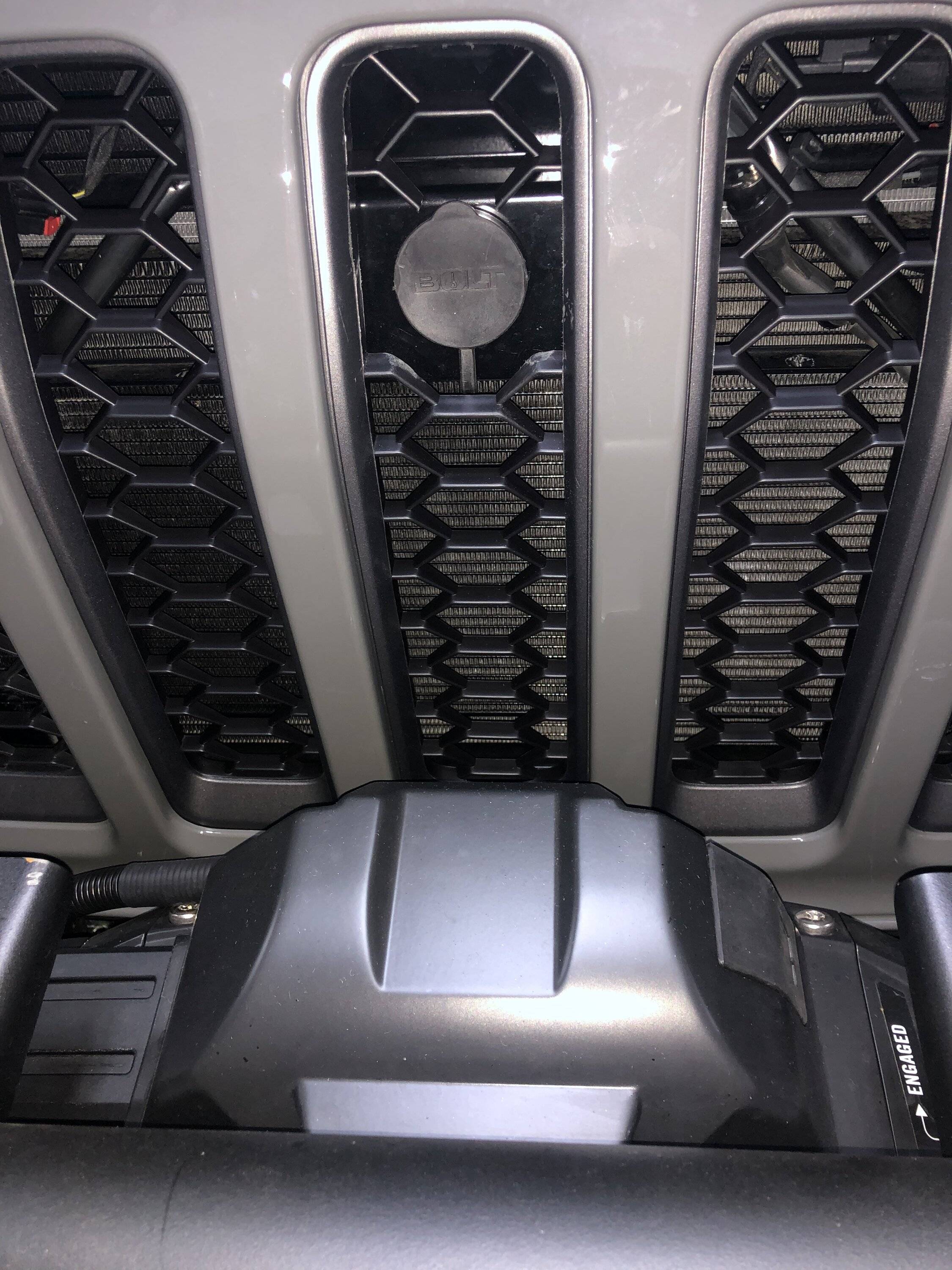

hah no not really. although to be honest... I'm not sure the stock location is the best placement for the camera to begin with. The AEV relocation kit puts the camera in a good spot but you have to have their bumper.

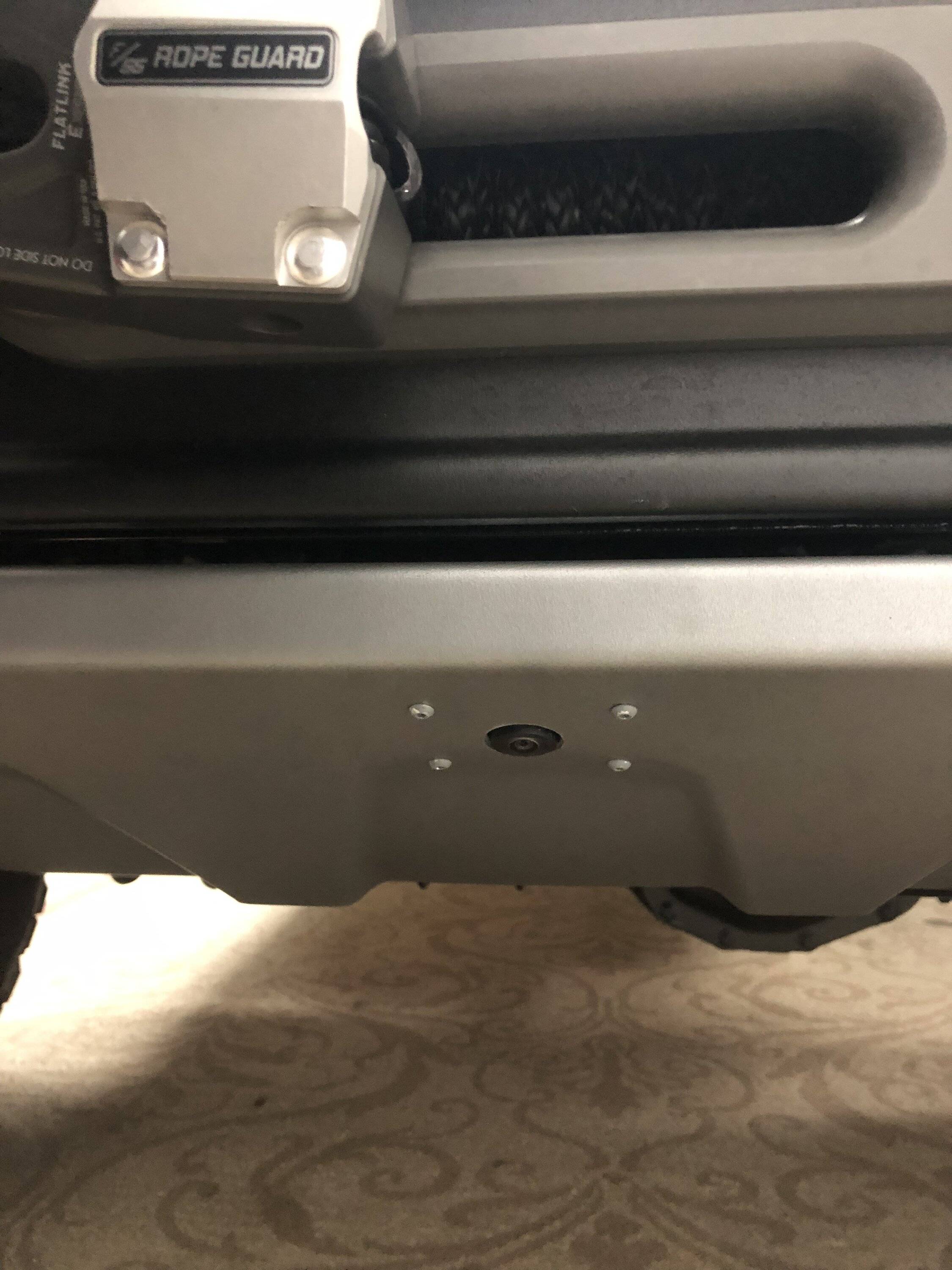

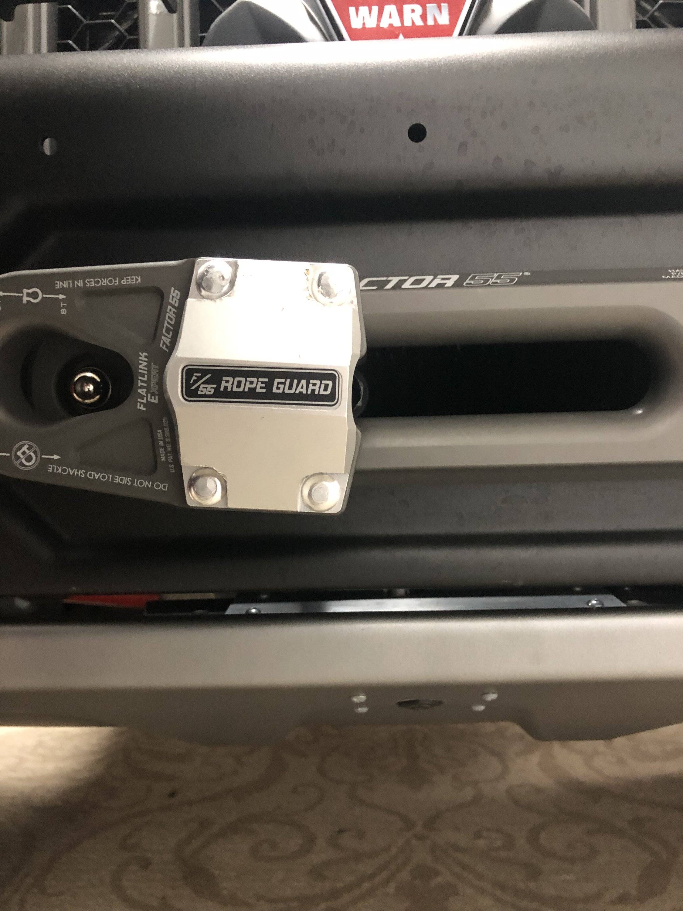

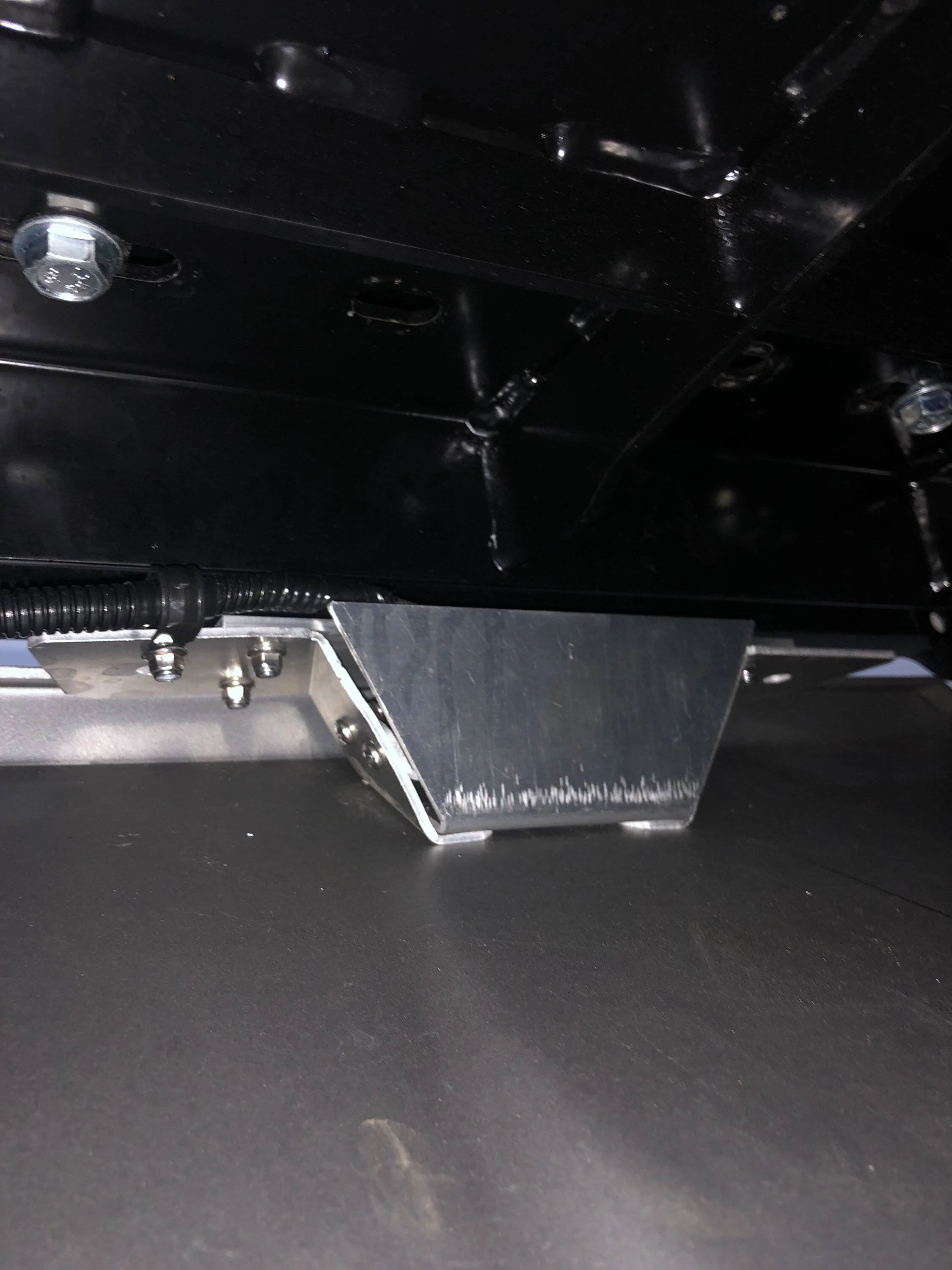

Using the info from @BDinTX I moved my front trail cam to my skid since the view was mostly blocked by the bumper hoop. This also let me install the Bolt hood lock. I used parts from the American Adventure Labs camera housing and some 2 inch wide aluminum flat stock to piece together a protective housing. Not as good of a solution as his delrin housing but it works. One photo is from the rear of the skid looking toward the bumper to show the camera housing.
