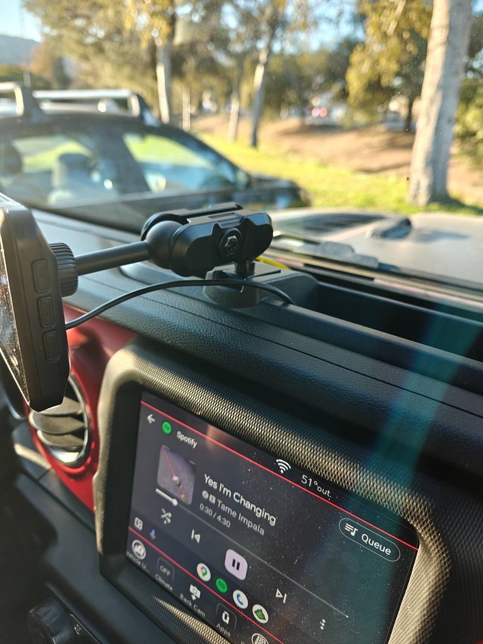

AUTO-VOX Backup Camera https://a.co/d/3mfaO4s
On sale now 20% off so like 48 bucks. This is the dash setup I used with it:
Jeep Wrangler Dash Mount https://a.co/d/fzB4jeh
It is on sale too. If you have a setup you like already, with a 17mm ball, you would not need the dash part.

They make good stuff...I didn't know they offered different sizes in the ball mounts...score! The only mod that took any additional time was drilling a hole in the dash so I didn't have a wire running down just hanging there. I also used the pigtail that went to the supplied cigarette lighter power supply (and cut that apart so that I could make a quick connect with the positive to the aux switch bundled lead) and I grounded the negative to the a-pillar base (door strap mount). I then ran the other side of the wire through that plastic plug on the driver side and use the grommet to seal it when I popped it back in place. The unit comes with a little green wire and a little white wire and when you cut one of them it makes the image the proper orientation and the other wire (if cut) gets rid of the guide lines.
I pulled the climate control section of the dash (clips) and the radio (clips and screws for the surround, screws for the radio) to make the wire routing easier.
